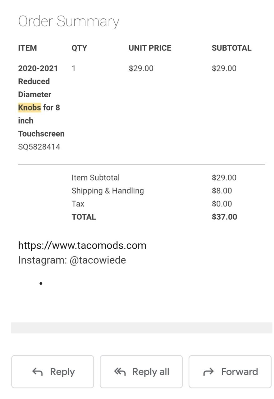

    Nice work! Now you just need @Tacowiede ’s knobs:

    I'm one step ahead of yah! Haha
    Had these on my previous headunit, well worth it!

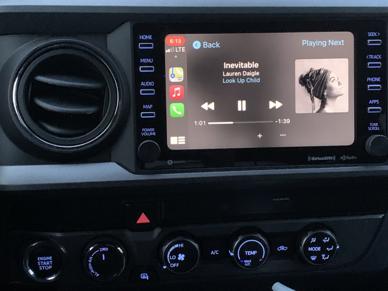

    is Apple play and android auto connected only or wireless too?

    Wired only. There are many threads about the CPLAY2Air device with the Entune 3.0 radios that we’re all using in these retrofits. Trying it out is next on my list. :)

    I see. So in order to use Apple Maps (or google maps? Maybe), phone has to be connected, correct?
    Nice music choice too.

    Yes, for any Carplay or Android Auto feature the phone must be connected with USB.
    Supposedly with the CPLAY2Air device it all works wirelessly but I can’t speak from personal experience yet.
