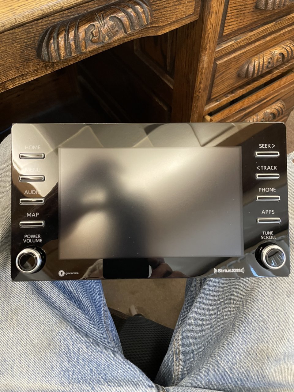

    Do you have a Nav Box in your 2020 Tacoma HU? If so, were you able to use the same o.e. harness from the Sienna to connect the Nav to HU? I saw a 2020 Tacoma part #86140-04110 (no HD stamped in the front) and it looks like the same harness is not compatible. Do you remember whats your part #?
    Looks like No HD tuner and 7” screen.

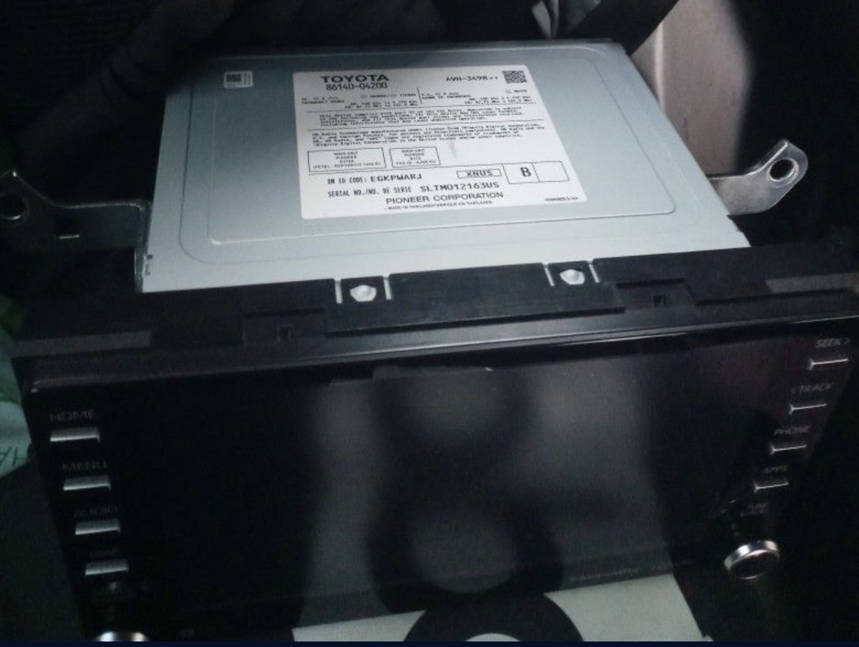

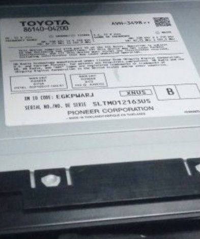

    So I have been looking for a USA spec non-JBL Nav 2020 headunit (86140-04200) for several months and all the wreckers, eBay, etc want $1,000+ for the headunit alone. So I am considering the Sienna 86140-08110 (https://www.opuradio.com/products/p...tooth-phone-traffic-weather-cd-usb-am-fm-1623) with the 86840-06012 Nav box (https://www.opuradio.com/panasonic-...0-gs-car-radio-usa-canada-map-data_p1776.html) and I'll have AHH make the conversion cable. Does anyone have this setup and have any issues?

    I tried both of those in my 2019 and they seemed pretty comparable… right down to the same issues with tracking historical mileage and the theme colors not lining up quite right, ha ha. The Tacoma unit has a slightly larger screen was about the only obvious difference as far as I could tell.

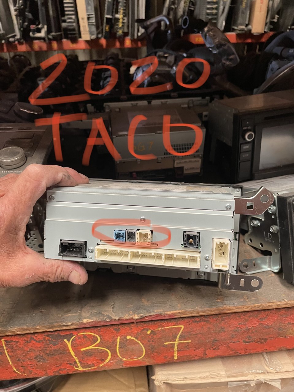

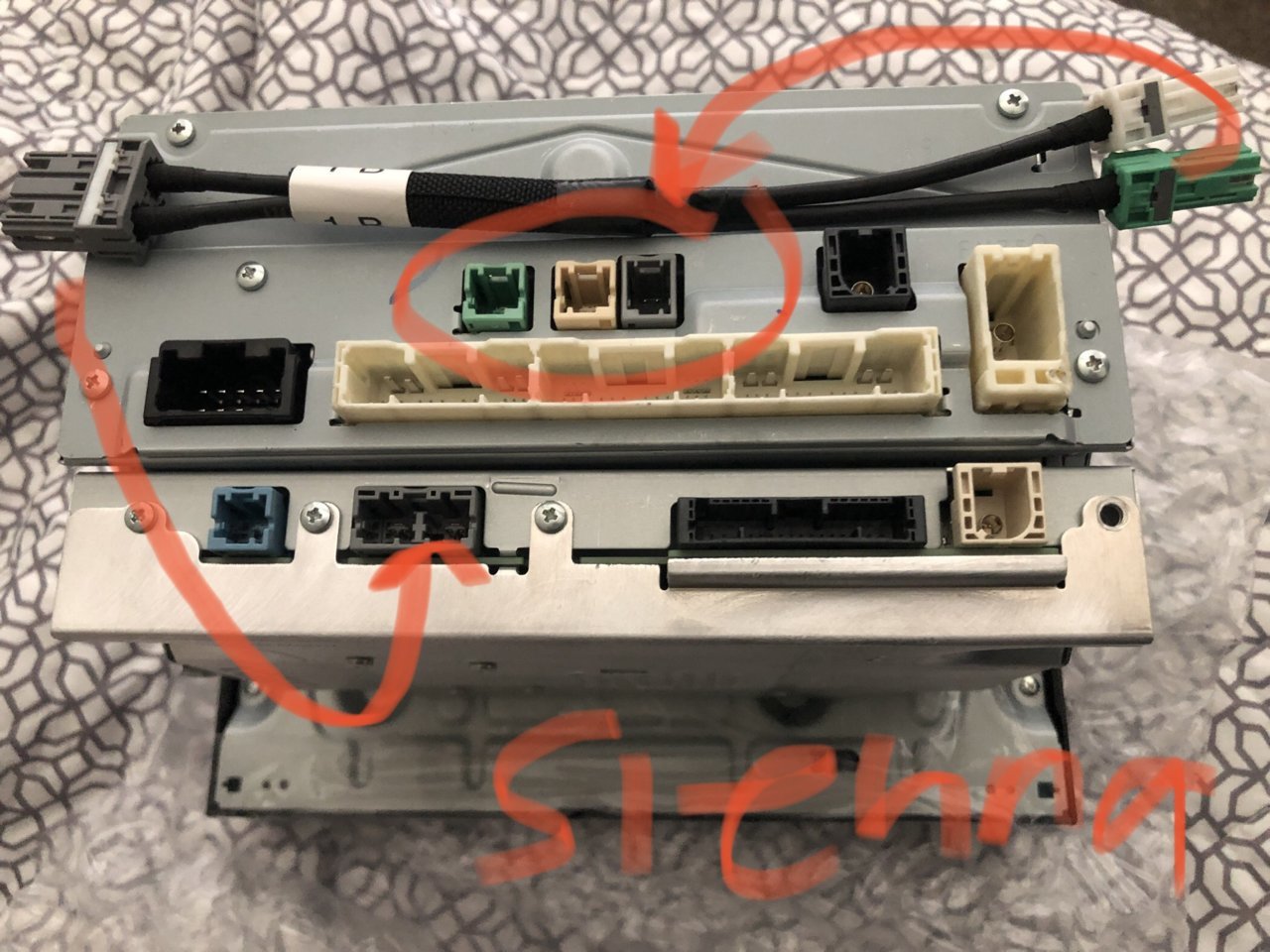

    The 2020 Tacoma HU you’ve attached a photo of doesn’t have integrated nav (and won’t support it, you need a different hu)
    The units that have integrated nav have a separate nav box. The cable is not the same from entune 2.0 to entune 3.0, but I think it’s the same harness for all entune 3.0 units, so you can probably get a donor from quit a few different vehicles… rav4, sienna, etc

    It will if it supports it. I don’t think that one does. You can tell from the connectors. When they do support it, it looks more like the sienna on the back. I need to pull my hu later to swap a wire, will try to grab a pic if I remember.
    Sometimes sellers will sell head units advertising them as “with navigation” but what they mean is the app based scout gps, not the integrated nav.
    I have a thread somewhere here that describes the different kinds of head units, but basically you have the base, plus, and premium, and only the premium units support true integrated nav.

    It’s for sale I my area. I was thinking about buying it. No i don’t have photos of the back. Just these
