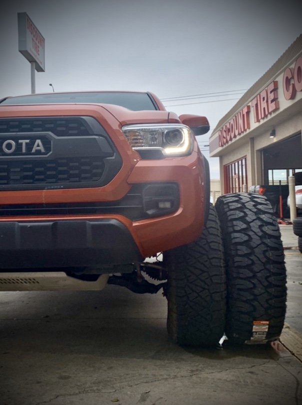

    thanks stock!
    I got rid of my 33s (C load AT) a while back and replaced them with more aggressive 34 (E load MT).
    I’ve had 31, 32, 33 and now 34s.
    Its been a bit of a “pain” to make them fit and did sacrifice a bit of get up and go, but still have plenty of power and truck still feels great. I believe once I have it all button’d down, it will be worth the sacrifice (for me).
