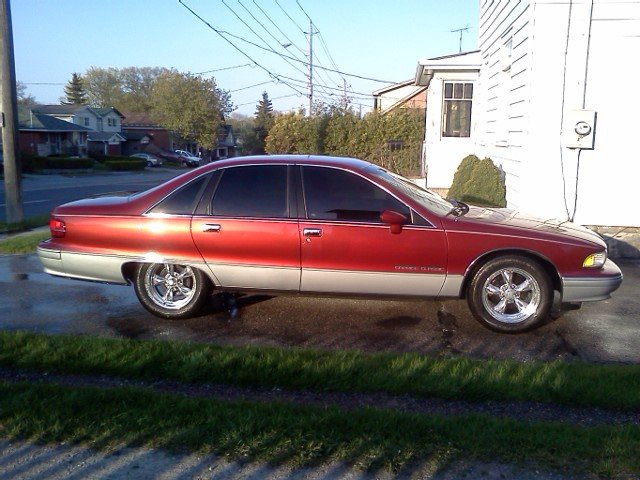

    Here is a good example of what Krown does. 1991 Chev Caprice. Driven in Ontario Canada year round. 460,000 km, and original paint. Still has all the paint on the underside of the car. Krown is maintenance, don't skip a year here and there. Its worth every penny in protecting your investment. Krowned my new Taco on day 3 with 40 km's on it.
