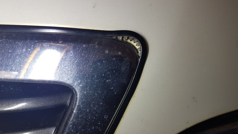

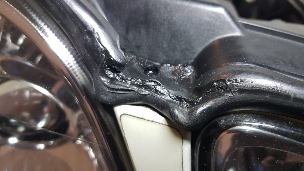

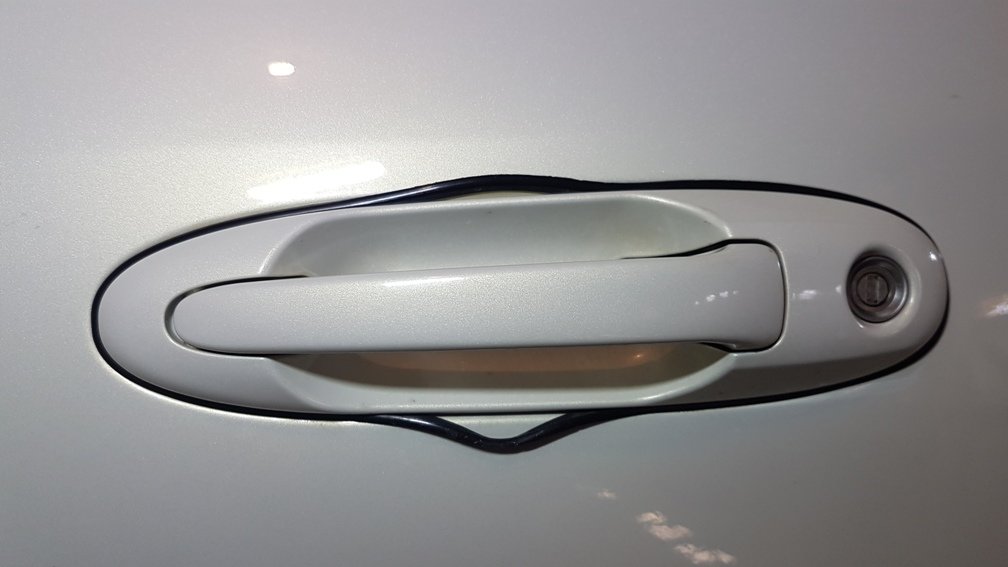

    Good to hear! Any issues with gaskets swelling and deforming after 6 years? I've heard that is a problem for some vehicles. I saw one guy say it's not a problem for newer Toyotas, but there was no evidence or explanation behind that. Here's some examples on a 2000 Land Cruiser LX470 which had 5-7 applications over 13 years from a "Krown rustproofing : collateral damage" thread.

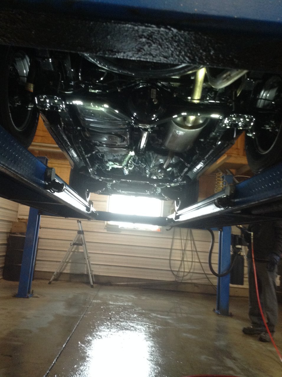

    I made the 2 hour drive from Indy to Kanagy Krown in Ft. Wayne(it was the closest Krown dealer) this afternoon. Rufus(the owner) did an AWESOME job on my 3 month-old Tacoma! He let me watch and ask any questions I had about the process.
    I couldn't have waited any longer as I encountered the first snow my new truck has experienced on the way back. Krown comes with a warranty if you start the process within 6 months of new purchase and maintain it yearly. I highly recommend
    Krown!!!
