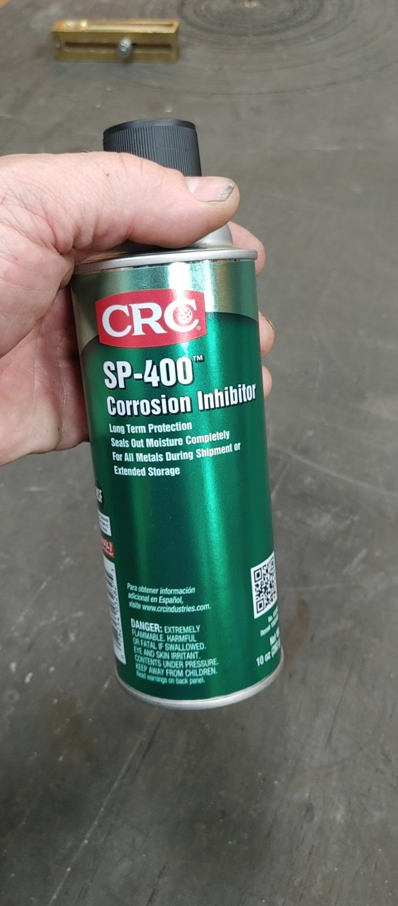

    KPaige
    KPaige [OP] Well-Known Member
    Aug 13, 2021
    #374102
    66
    Ken
    2021 Tacoma trd sport 07 FJ Cruiser
    sport- none yet FJ- Bilstien lift 33 x 12.5 BFG, TRD Exhaust, ECG third member
    So what your thoughts on this? I have connections to get as much of this as one could want.
    From my research on the site and the net it is cosmoline under crc name. And going off a sailing site its great stuff for moisture protection

  12. Aug 19, 2021 at 2:42 PM
    #32
    No Shoes Nation
    No Shoes Nation Well-Known Member
    Sep 20, 2019
    #305845
    906
    2008 Taco SR5 Access Cab 4.0 4x4
    Hmm . . . none as yet, that's why i'm here . . .
    Applied fluid film. Truck sat for two days in 80 plus temps. Few days later had torrential down pour while driving, most of what I can see of where I applied FF, it has all washed off. Pissed.
  13. Aug 19, 2021 at 5:33 PM
    #33
    Ryeguy
    Ryeguy Well-Known Member
    Sep 4, 2009
    #22253
    424
    43* North
    2021 TRD Off Road 4X4 Blackout
    OEM Bed Extension, Bed Mat, Lomax Bed Cover, Auto lock tailgate (OEM)
    On my 2010 I sprayed the heck out of my frame with motorcycle chain wax when it was brand new. That stuff is expensive, but probably one of the best coatings you could apply. I then sprayed it with CRC or PB Blaster (whatever Home Depot had) every fall. FWIW, I also hit the hood latch and cable, spare tire cable, gas flap hinges, and most of the nuts and bolts under the hood. I HATE wrenching on rusty junk.
    I never qualified for a frame replacement (mixed blessing I guess) and just traded the truck in for a new 2021.
    I’m now getting a little long in the tooth for crawling under my truck every fall, so I think I’ll pay someone else to get greasy and go the fluid film route on this new rig.
    Bottom line, though, is you should do something. Either Fluid Film, or Woolwax, or DIY CRC spray but do something if you want to keep your truck.
