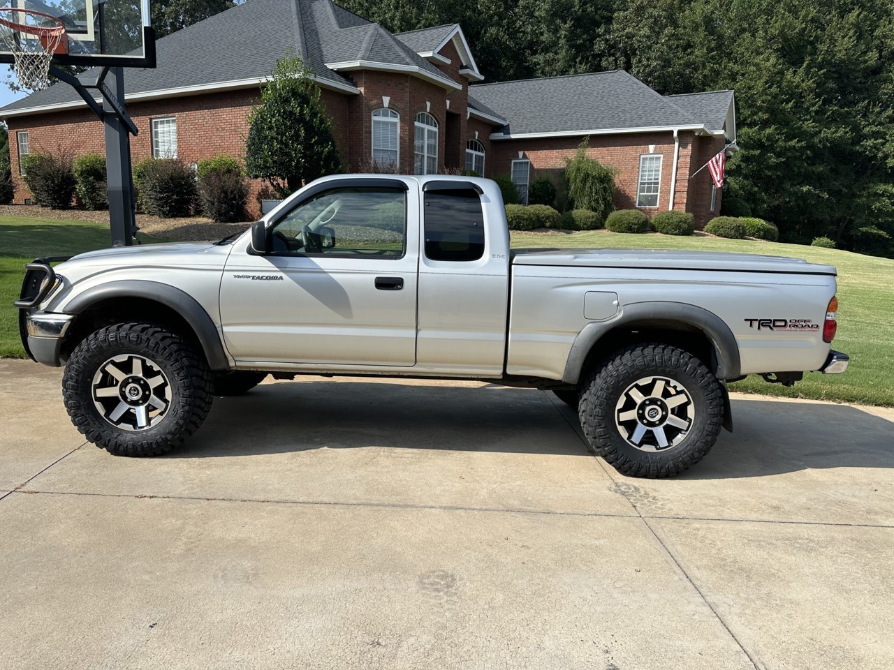

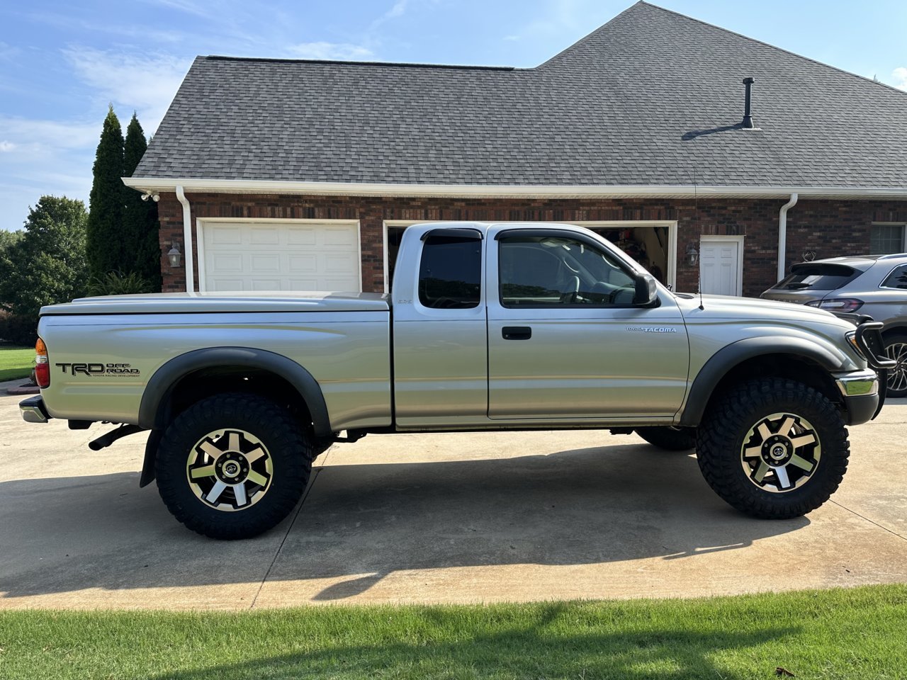

    New 17x7 4-Runner Wheels
    Maxxis MT 285/70R17
    1/4 Spacers
    I know.....I should have used hub centric spacers. I tried and the 1" hub centric spacers I used were not working on the rear because the wheel studs were too long and poked through the spacer. The 1" front also rubbed ever so slightly. This is my hunting vehicle, and I didn't want the wheels sitting out too far. The 1/4 spacer was perfect to keep a slight gap between the tire and upper control arms.

    I love the 4runner wheels wish they came on the tacoma. Truck looks good.

    Agree, and for the price you can’t beat it. I have run a ton of different tires on by other trucks and love the Ridge Grapplers. These Maxxis are not loud (you can just hear them) at all for a MT tire.
