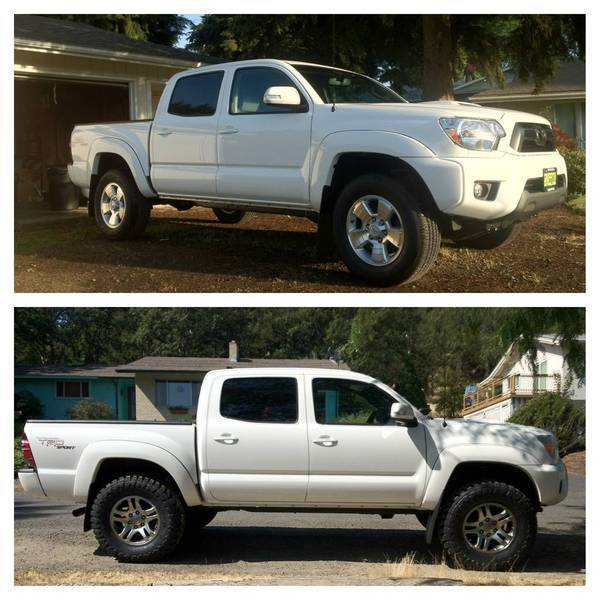

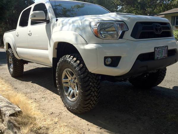

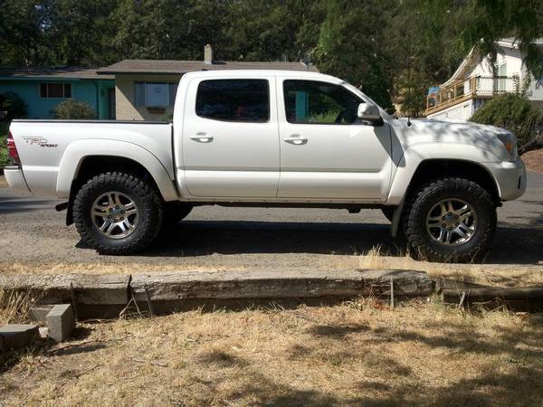

    Tires are 295/70/17 picked the wheels up from a rolled Sequoia. There's a little rub on the UCAs at full crank but not too bad.
    Stock height to 3" lift and tires difference

    looking good. You cannot find those wheels just any day. Good find.

    Looks good!!!! What lift u running? U should get some 1.25in wheel spacers would set It off perfect

    Thanks! Just the Revtech 3" spacer lift right now I'll upgrade it after I get some of my want list down. I want wheel spacers but Les Schwab won't touch it if they're on there :(

    Nice setup!! You might need to run some .5"-1.0" spacers to keep the tires off the UCAs

    I have the same lift and 295/70/17 as well. The stock bolts are not long enough to put a .5" spacer on. You have the get the 1" wheel spacers that has the bolts built in like I did. My wheels are +12 off set and then I added the 1" spacer. No more rubbing on the UCA or any where else.
    Discount Tire tried to pull the "We cant service your truck since it has spacers" on me. When I ordered the rim and tire combo they said they were positive it would fit. It did fit but was rubbing my UCAs on every turn. So I made them service it with my spacers :D

    Actually it's only rubbing on the UCA's at full crank on both sides I haven't seen any sign of rubbing on the plastics.
