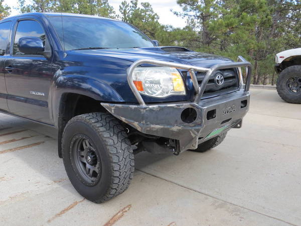

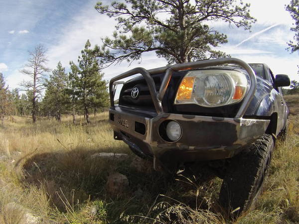

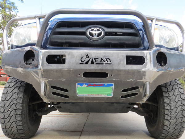

    Hey everyone, My name is Caleb with C4 Fabrication. I have been in the off-road/fabrication industry for almost 15 years now and love building custom Toyotas. I recently started my own business (about 2 years ago). I do custom off-road builds and custom pieces like bumpers, cages, roof racks and rock sliders.
    I recently finished what is going to become my production version front bumper for the 05-11 Tacoma. All the parts are CAD drawn and CNC plasma cut in my shop. Here are some pics of one in raw steel on my 05 access cab.
    What does everyone think?

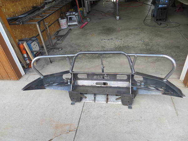

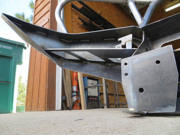

    This bumper is winch ready. This first one I built has brackets made to utilize the factory Toyota fog lights. I will not be offering the option to use OE fog lights on the production bumpers because the OE lights are to much of a pain to mount. The next one I build will have holes cut to fit round LED lights, or I believe there is room to fit a 6" round light in that same area. Square holes could also be cut to fit the LED pod lights if that is what the customer prefers.
    This bumper is made from 3/16" plate with 1/4" plate uprights and 3/4" plate tow shackle hooks. here are some pics of the structural parts of the bumper.
    The bumper utilizes 3/16" plate framing on the inside to strengthen the wings of the bumper and give a surface for the fog lights to mount on.
    All three factory frame studs plus two more 1/2" bolts through the frame give plenty of mounting strength.

    Good looking bumper

    Also if anyone is wondering, the center hoop is 1 3/4" OD .120 wall tube and the headlight hoops are 1 1/2" OD .120 wall tube.

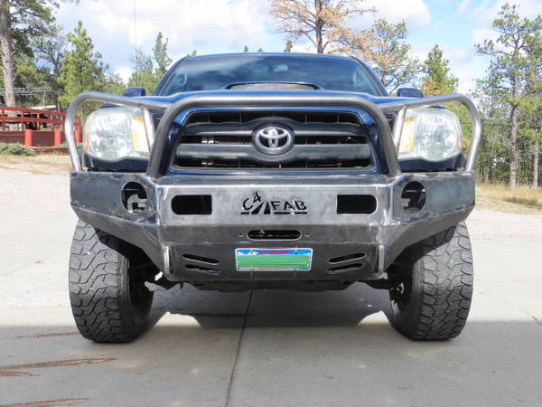

    another pic for everyone

    Looks very stout, great to have another option available to 2nd Gens.

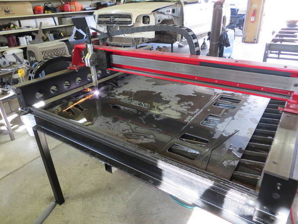

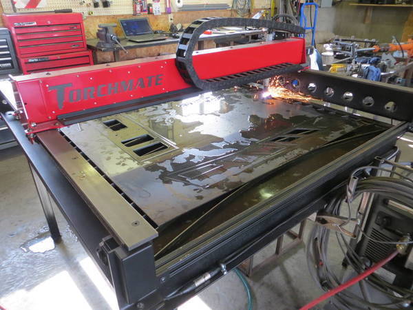

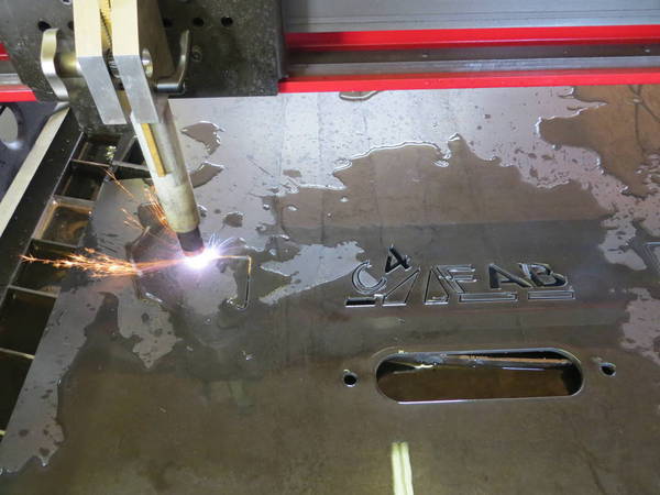

    Here are a few pics of the plasma table cutting more parts for Tacoma front bumpers.

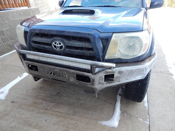

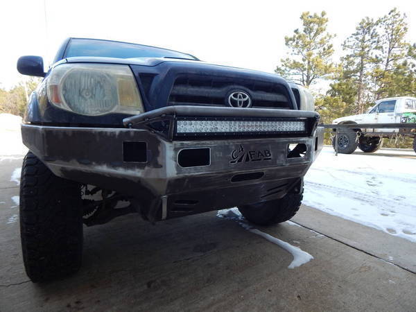

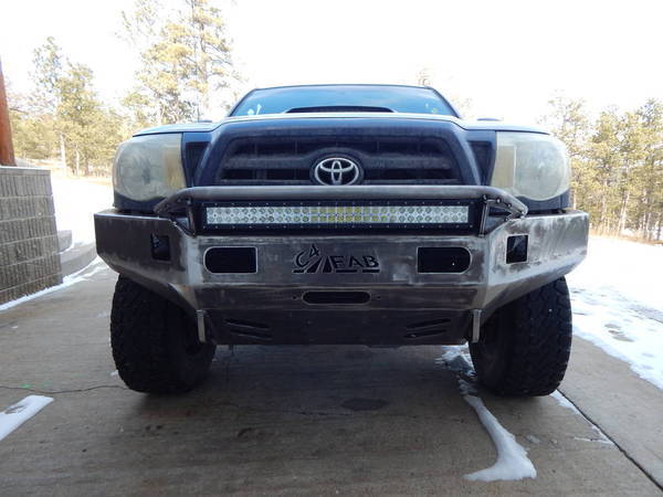

    Hey everyone, been working on another option for upper tubing on the front bumper. I wanted something that would hold a 30" lightbar and not look out of place. This is what I came up with, what does everyone think?

    Nice looking bumpers

    That looks killer. I would like to have one of those bumpers. I like how you have the light bar on it.
