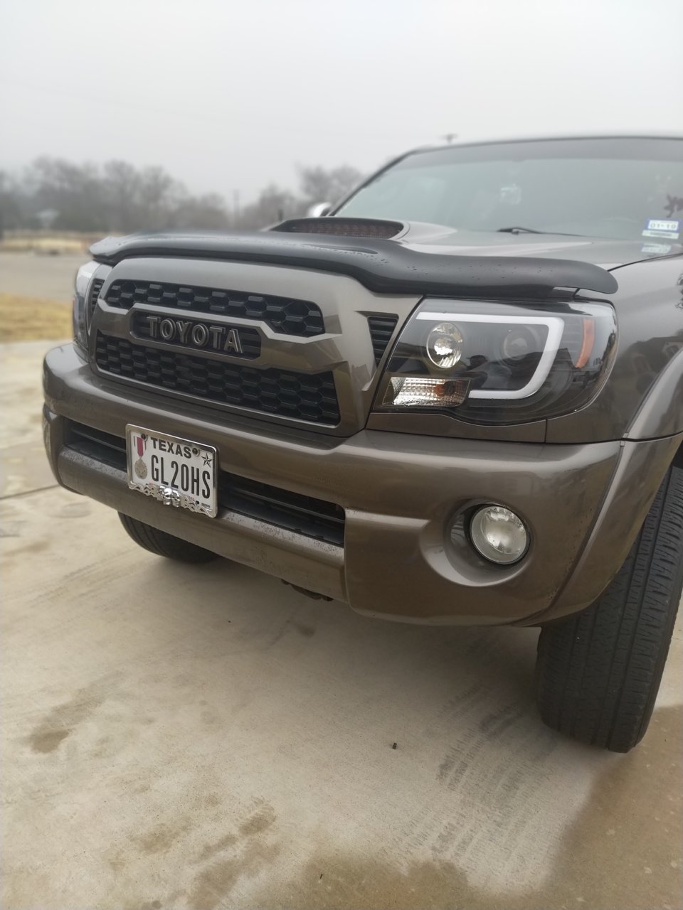

    Here is mine color matched.

    perfect match!The right side of Grille/Hood looks like it just melts together,one piece.Cant get any better than that,very nice!

    very nice truck!
    if you plan on selling the grill im interested.

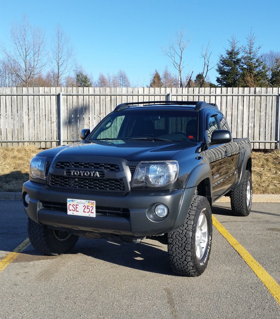

    Finally another picture of someone who color matched it, looks good!

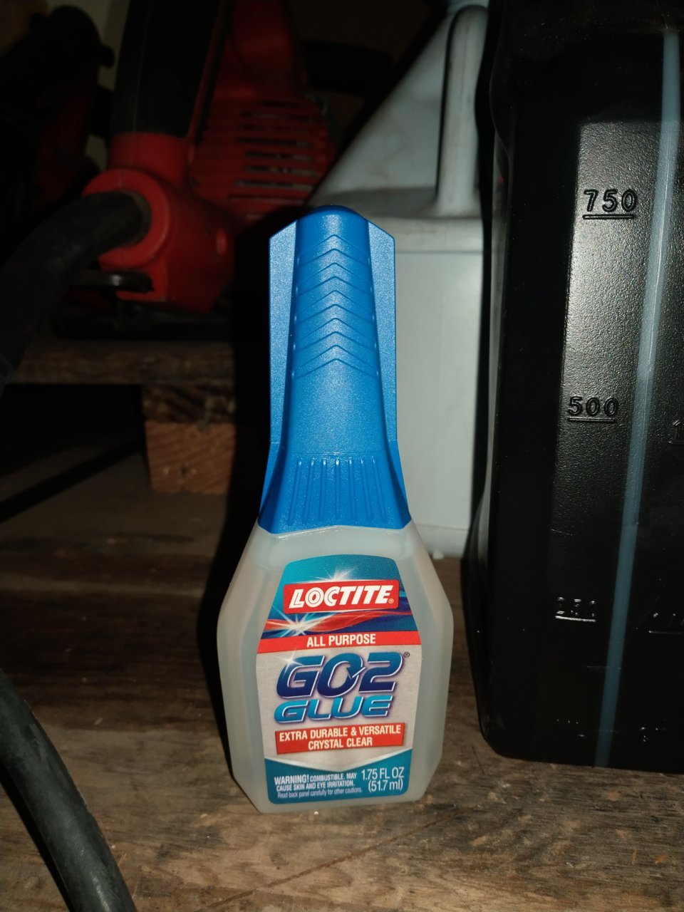

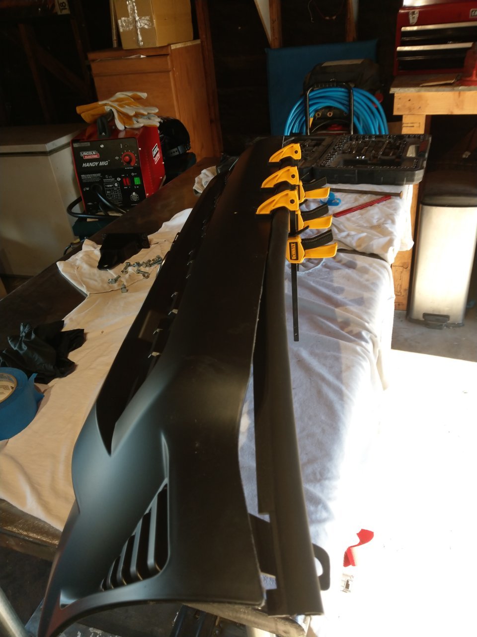

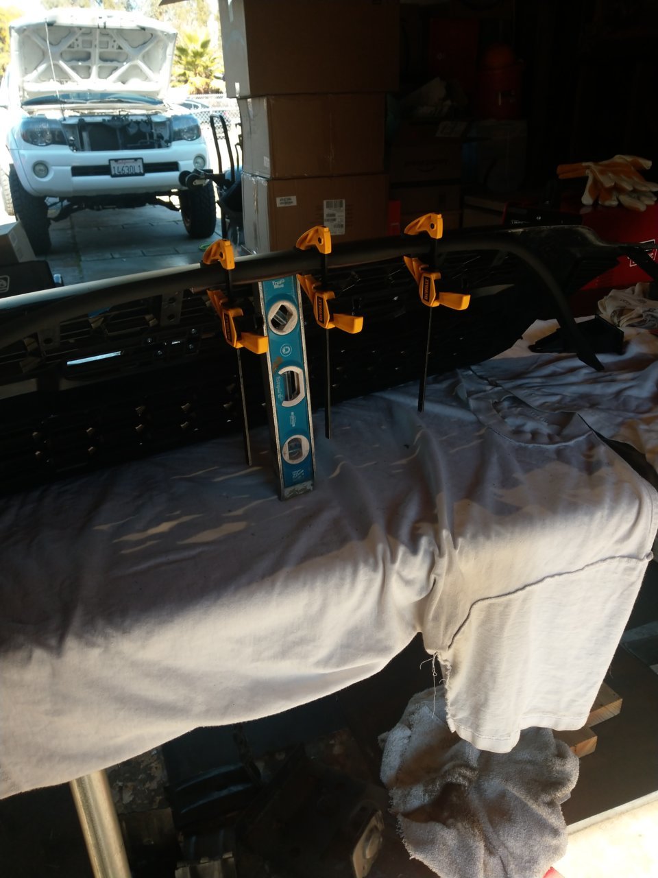

    For anyone struggling with that stupid weather seal...I had to figure out how to attach it on my own..It's a pain in the ass and time consuming but I did this about 2 months ago and it's still holding strong.
    Here's what I used:
    -Wire brush or low grit sand paper
    -3 or 4 small quick clamps
    -Loctite All purpose GO2 glue (home depot)
    -Patients
    Here's what i did:
    1- Use a small wire brush or something similar to score and rough the surfaces of both the grill and weatherstrip in the areas where the two attach.
    2- clean both surfaces with rubbing alcohol.
    3- apply glue and use small clamps to hold stripping in place... Work from the middle outward in sections. Let each section dry completely before moving on to the next section.
