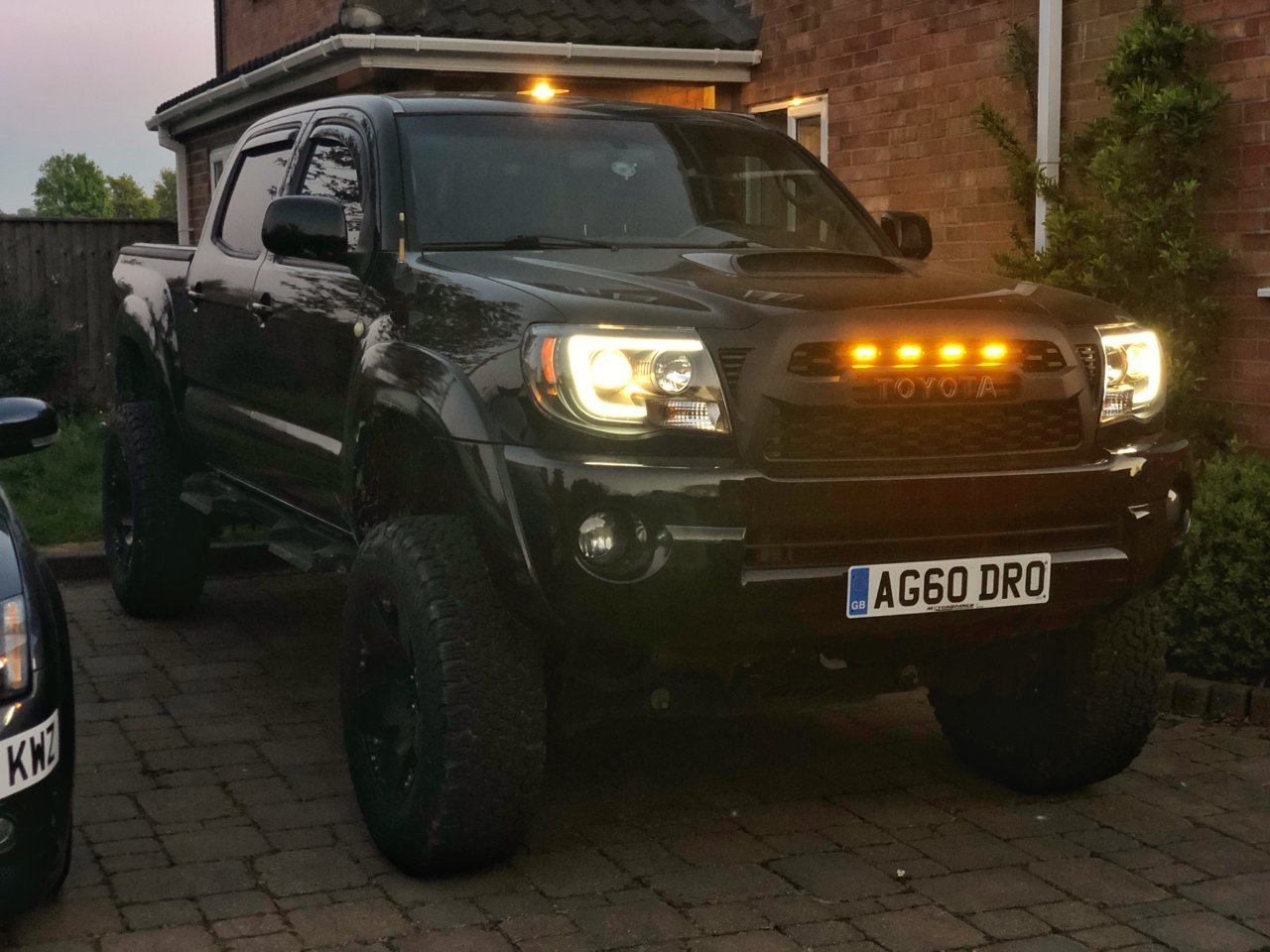

    Here it is all pretty and lit up. I think it really makes my Taco look newer than it is.
    And thanks 08BajaBoy, The tabs fit much better now.

    Anyone know where to buy the letters separately? I bought one of these from Ebay and assumed the letters were included. Turns out I selected the one seller that only sells the grill with no letters. The ad didn't say they were included but it also didn't say they weren't. I know, buyer beware, my fault but I'm still going to flame the seller for not being clear about it.

    I just bought that grille not too long ago. It didn't fit very well but I made it fit using my own steal screws and washers. I think I bought it for like $100 on Ebay. The plastic fasteners it came with all popped off/broke after hitting a few bumps. NGL the whole thing is made of cheap plastic but still looks good from afar. If you don't mind adjusting it every so often it works. Keep your original grill just in case I wish I did-- I sell everything that comes off my taco to help me pay for more mods $$$.

    I bought mine off of EBay and it said “with Letters.” Is there any way to return it? I tried looking for you, but all I could find were decals that go over the real grille to change the letter color.

    I agree that it looks great from afar, but could look cheap up close. I think it probably stands out more with your truck, but at least my truck is black.
    I bought my truck used and it already had an aftermarket chain link grille (Chinese, of the same cut and quality), but I would love to get my hands on an OEM grille as well. I think it has a nice clean look.
