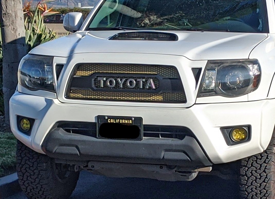

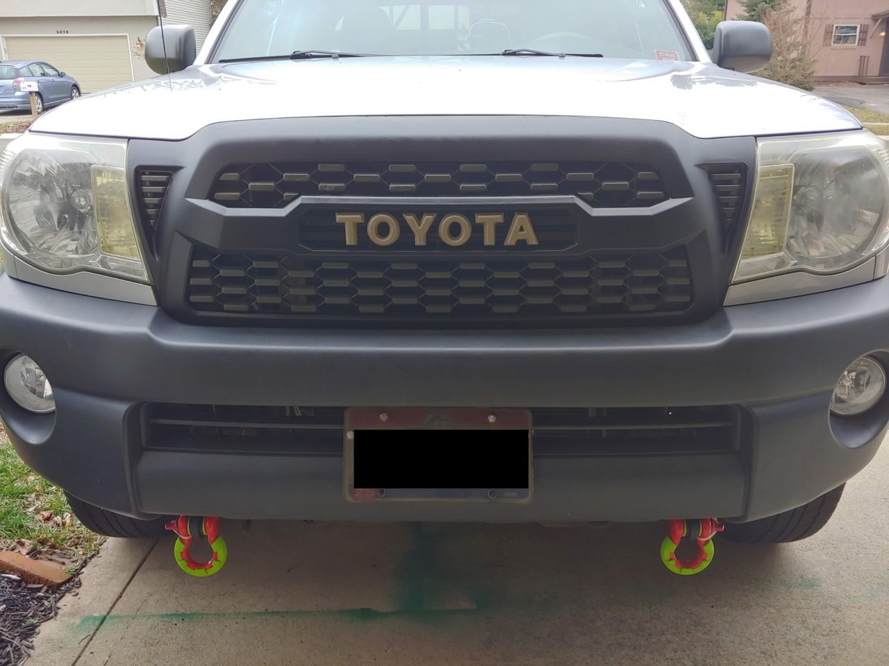

    Yup, exactly. I cut a Tundra TRD Pro grille like so and then custom fit it into the stock surround. I secured it via a couple set screws and zip ties... If I get around to removing the grille again I'll take additional fitment pics.

    Yes, 3rd gen pro grille looks great as I just did this mod. Was able to locally source a non-oem version that was damaged so got it cheap.

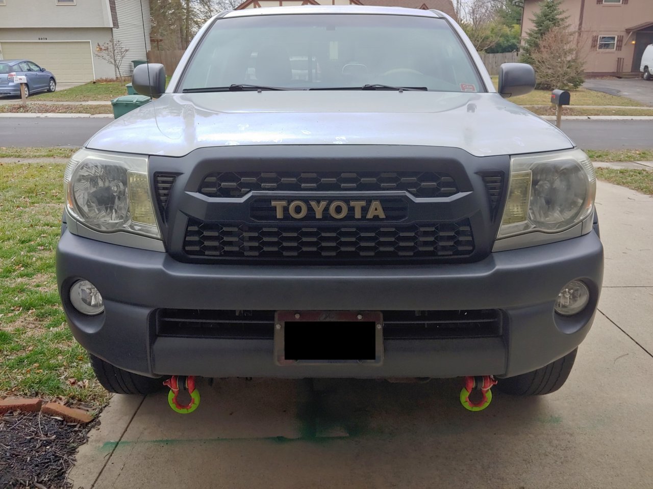

    Man, that looks awesome. Did you just cut your grill and insert that center bar and mesh?

    Thanks! Yup but already had a satoshi grille to start with.

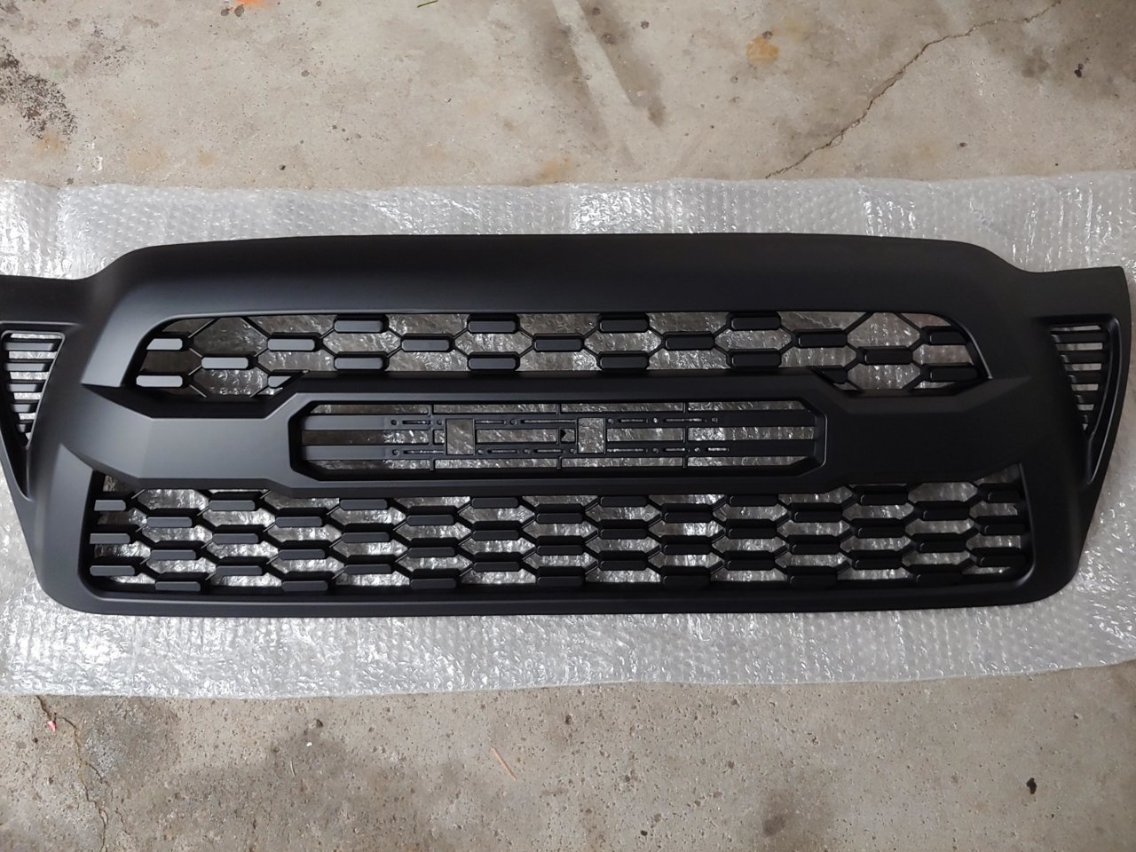

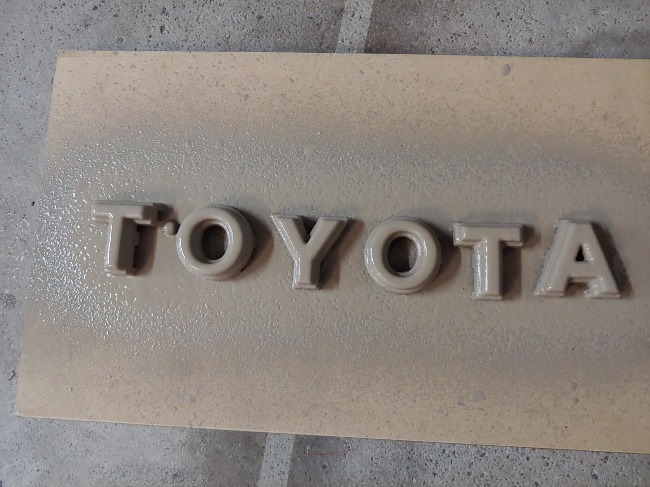

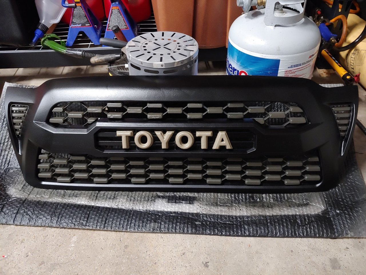

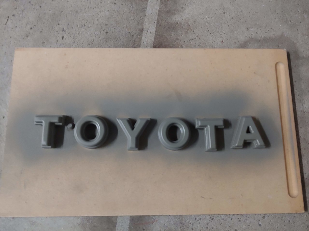

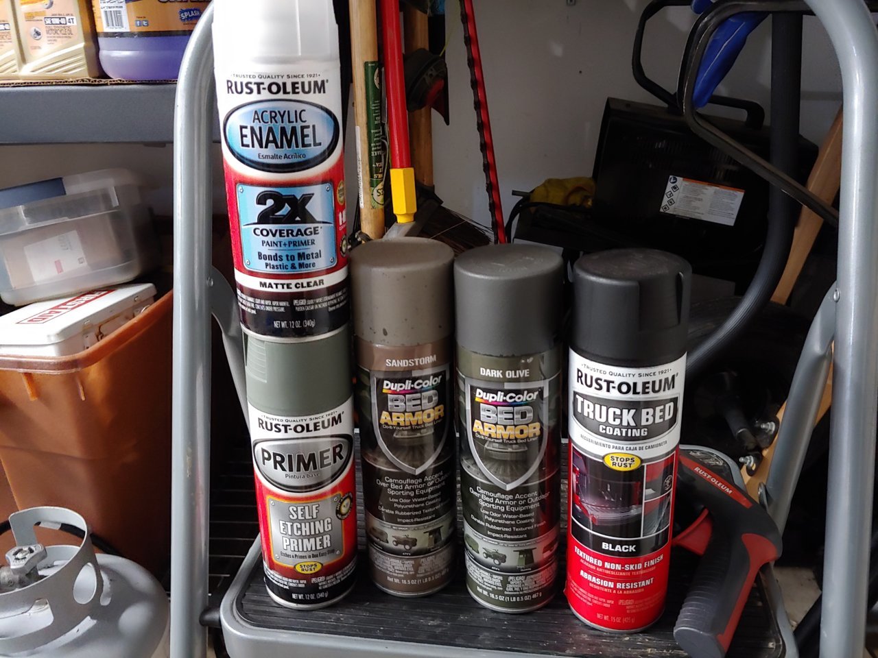

    Funny, I just got an ebay grille that looks a lot like the one from the OP. Did a little work with some rattle-cans and put it on yesterday. Today my two sets of weather-strip get here, so I can figure out which one will work best on it.
    As received
    Self-etching primer
    First two coats of bed-coat

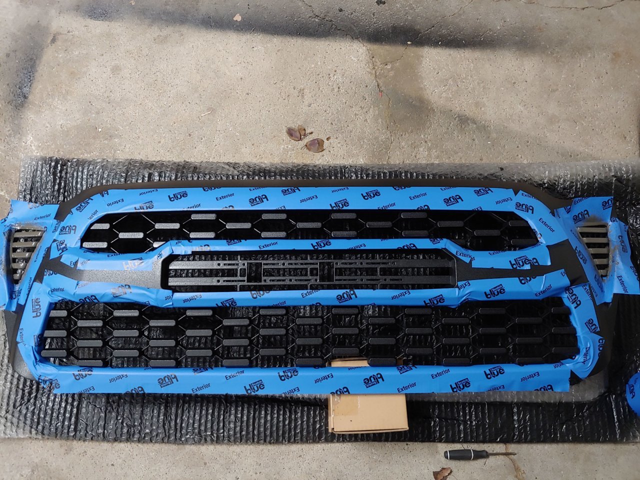

    Taped off for a tri-tone on the louvers, honeycomb and lettering
    Couple coats later, along with a couple coats of clear matte
    And on the truck
    And the tools used

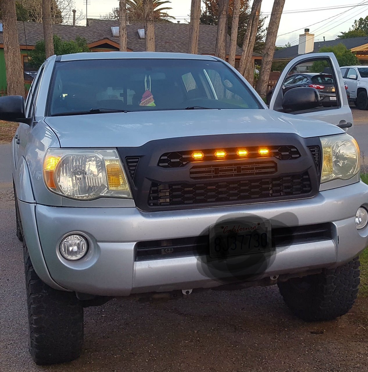

    Installed mine looks good. Still fighting with the rubber liner. Didn’t try to bond the included silicone rubber seal becuase i have no faith in any adhesive I have. Tried the tape backed door sealer product the seller recommended but it just looks all malformed when the hood is down.
    also replaced the outer plastic button snaps with a bolt and nut which helped better align the grill with the headlamps.
    Any suggestions on replacing the seal?
