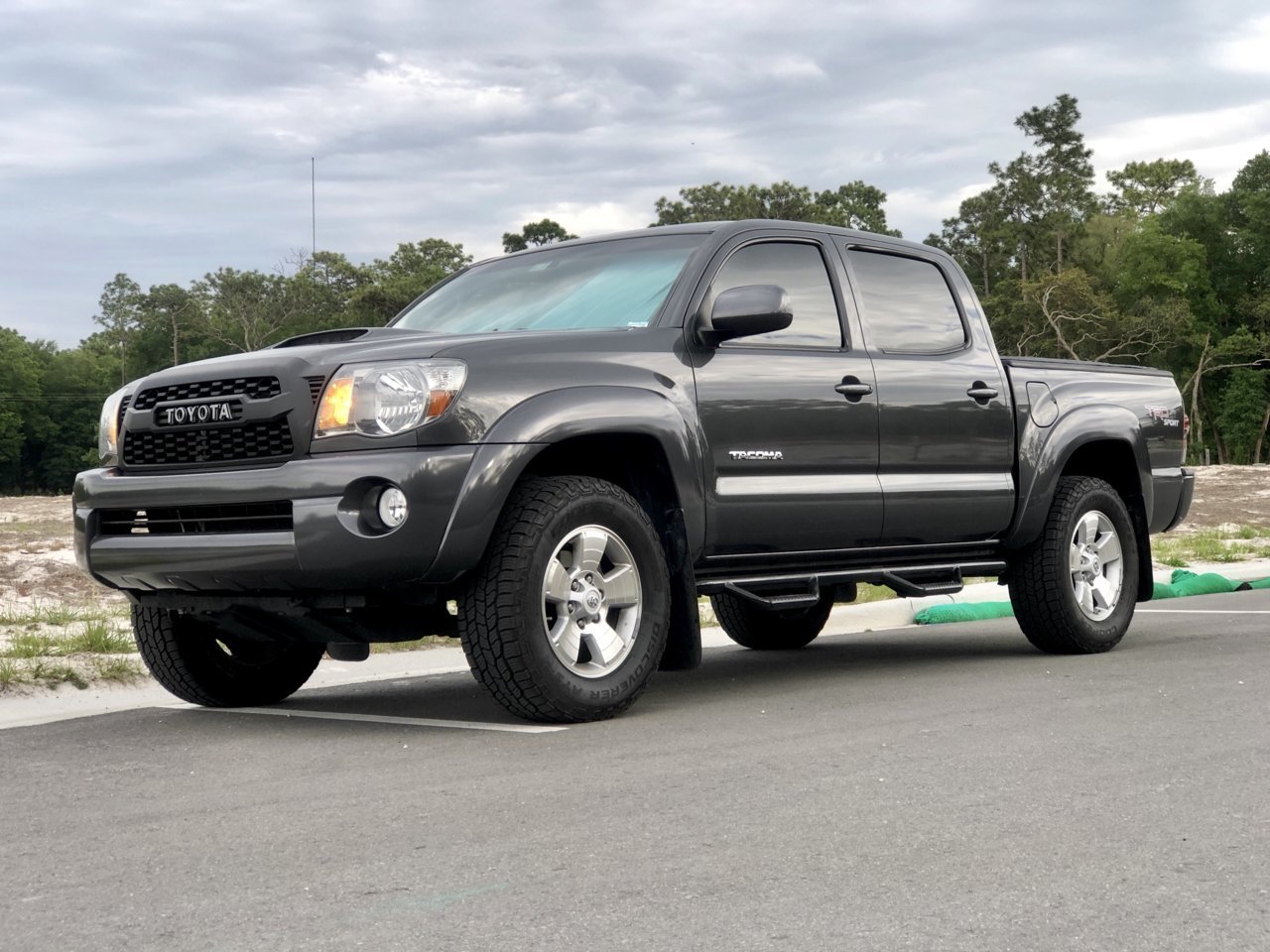

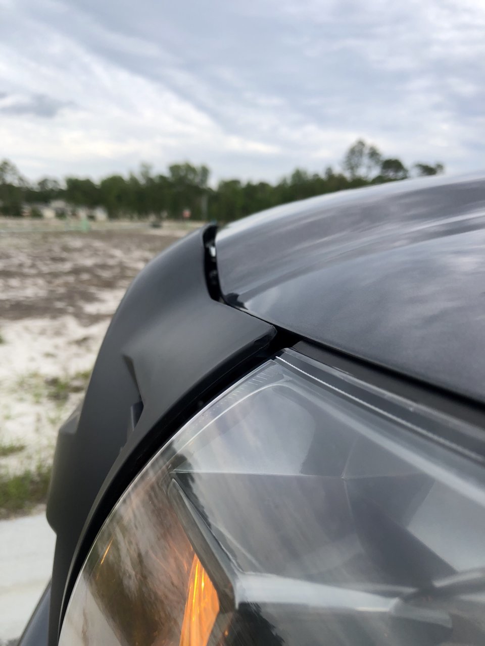

    Well mine arrived today. $110 on eBay. Looks nicer than I thought. Fit is ok. I think I need to figure out the brackets better. Looks so nice though on the truck. The weatherstripping everyone has been using is ordered but wanted to see the fit first. Sits a little too high currently. 6EF433FD-3037-41A4-8FC5-79F48D0A94D9.jpg87C263EE-B76D-4873-9B59-4C6537CD6982.jpg
    JoeTacoma02 likes this.

    Yours doesn't look fully seated or the fasteners are giving it too much play. I'd check the two retaining clips on the bottom to make sure they're fully seated (it also appears to be angled forward which is why I am saying that) - and if they are, swap out the two plastic fasteners for two nylock nuts and bolts - that should keep it angled back correctly.
    motopilot[QUOTED] likes this.

    Awesome ! Will check and try this tomorrow!

    I just want to make sure I didn't confuse you. The bottom retainer clips on the OEM grille slot into two retainer brackets. The replacement TRD Faux grilles we're all getting don't have the clips, only little bits of plastic that sit in those brackets. The plastic fasteners I am referring to are the ones at the top of the grille that slot into the plastic tabs up top, they're shaped like little plastic push pin bolts. Those stay loose so as to give the grille a little bit of flex room in the event that something smashes into it, so it can "give", but there's really no practical purpose for that. If something big enough to make it "give" hits it, it's going to rebound/shatter anyways, so might as well use those fastener holes to actually lock it in place at the correct angle if the bottom part is seated correctly. If none of that makes sense, take a look at it and it will, otherwise I can go get pictures at some point.
