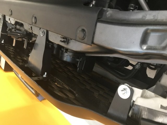

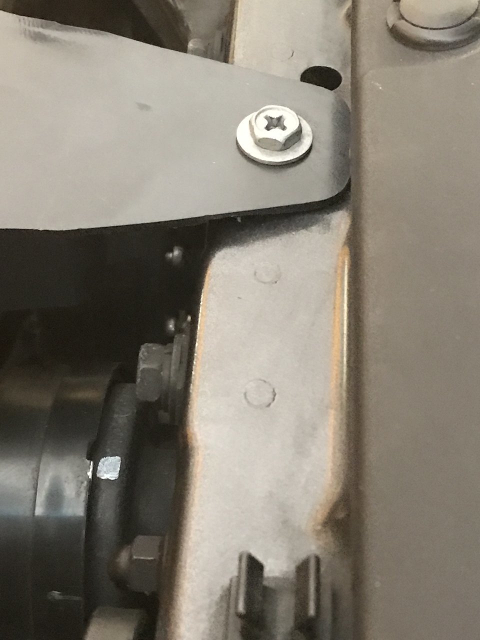

    You can pull the bottom tabs off faux grille and just zip tie them. Makes the grille sit lower. A little sanding is required though where the arrow is pointed. It was the cause of why it wasn’t sitting all the way down...well for mine anyway. EB5615C9-A2B9-48F7-9335-882B9363E173.jpg

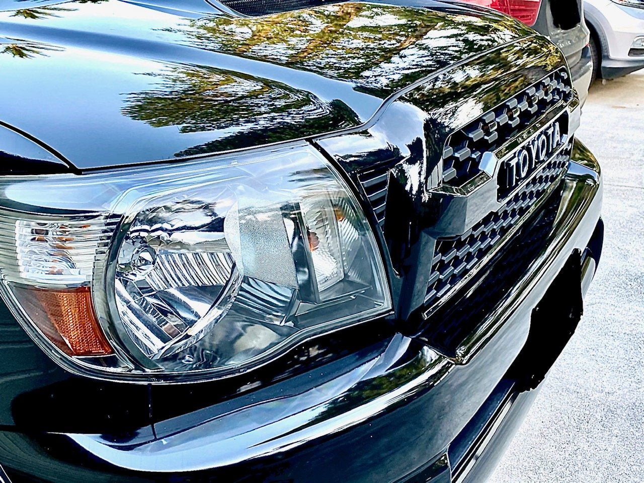

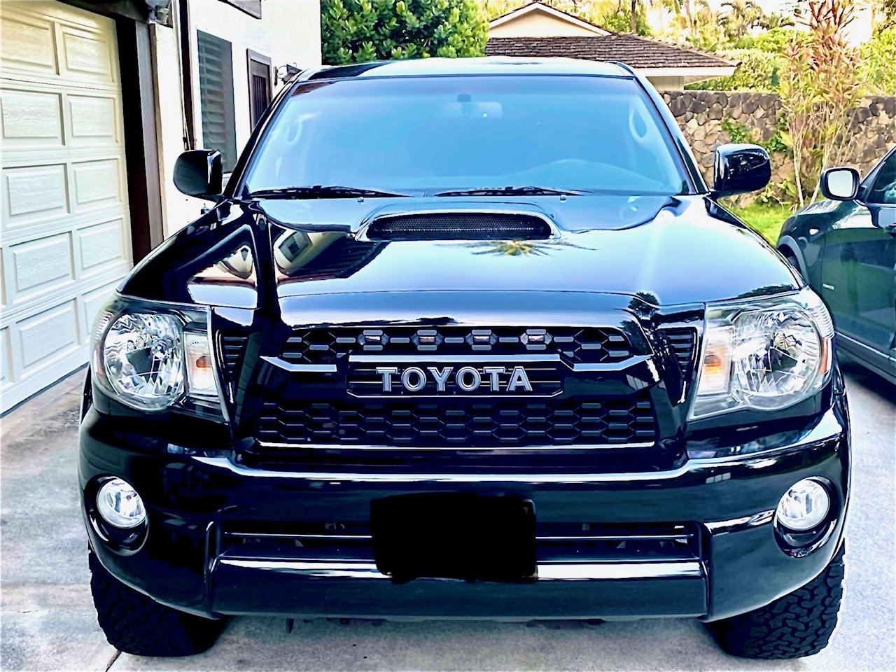

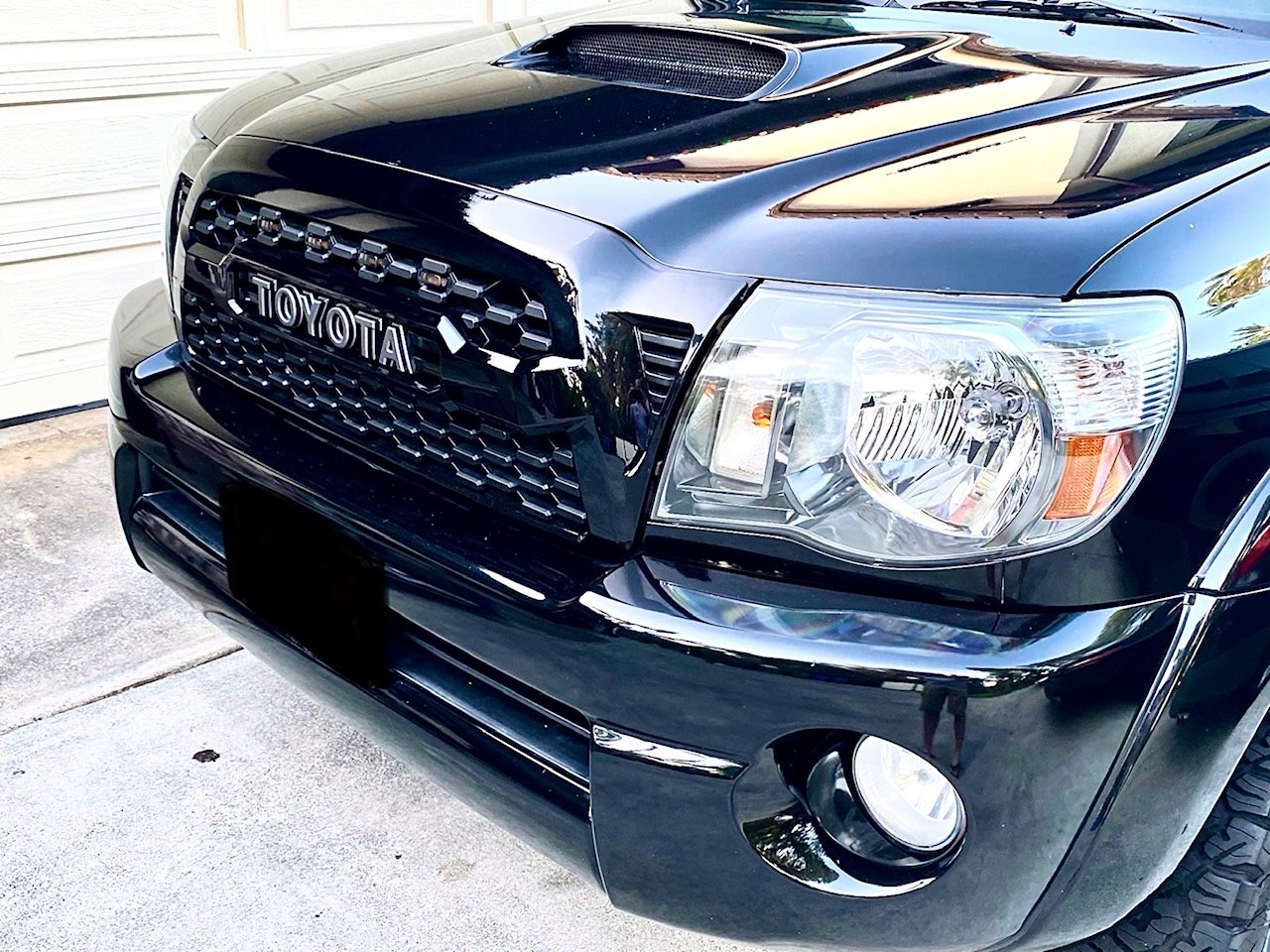

    I cut the tabs and zipped tie (irepLONGBEACH) worked great. Also I flipped the bracket which also lowered it as well. Replaced the pop clips in the corner with screws as well. Grill is solid and not going anywhere. The fit looks much better. Yes I thought I’d prove you all wrong and use the included gasket. Ha yeah that did not work. Ordering the tailgate seal after lunch. Would like to paint but think I’ll just keep as is for now. Neighbors really impressed how good it updated a 10yr old truck

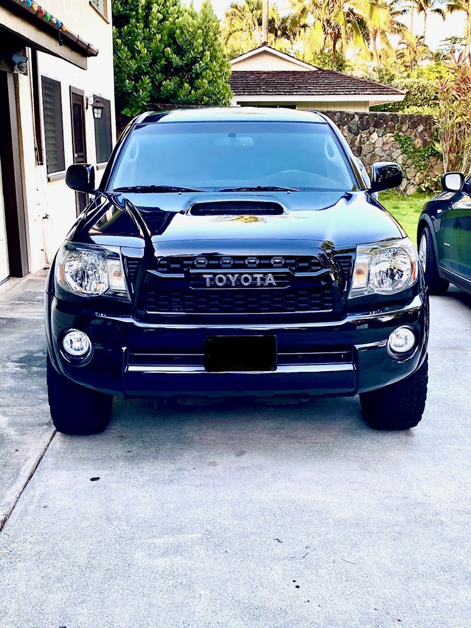

    My gasket finally came in so I put it on and installed the new grille. I took out the lower pieces that hold the stock grille on. It fits pretty securely. I will probably make some adjustments and change the upper pop clips with nuts and bolts. Otherwise, not bad for just slapping it on. Now to wire the LED's...

    Yeah...I just paid a shop $100 to have them paint it. It's darker (obviously) since the paint is new, but with most lighting, you can't tell. I had the truck’s paint corrected once I bought it, but it's not perfect. If you look at the last pic, you can see a little bit of orange peel...but for a 10 year-old truck, it doesn't bother me too much at all.
