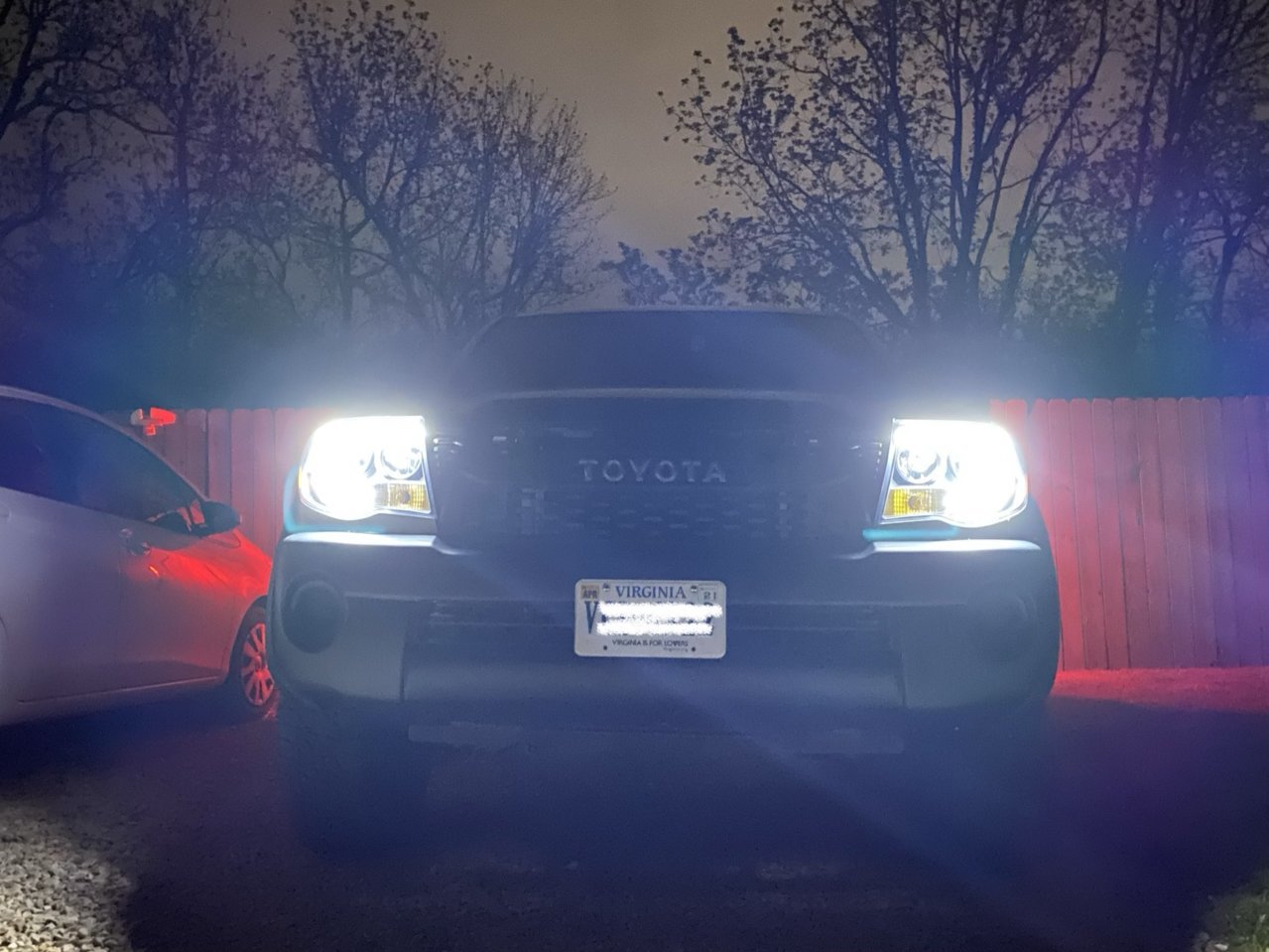

  12. May 10, 2020 at 7:05 PM
    #572
    redz80
    redz80 Well-Known Member
    Mar 21, 2010
    #33649
    298

    Just out of curiosity did you try unplugging the side marker and turning the plug 180 deg and plugging back in?
    I am assuming the side marker lights worked before you installed the new headlights.
    ReidBeardcore[QUOTED] likes this.

  14. May 11, 2020 at 4:57 AM
    #574
    ReidBeardcore
    ReidBeardcore Member
    May 2, 2020
    #326571
    12
    Reid
    2007 Tacoma
    I didn’t try that I will though. I got a new marker socket from Toyota on Friday and it still won’t light. Yeah it worked before. Just stopped when I plugged these in. Weird as hell.

  16. May 11, 2020 at 10:48 AM
    #576
    redz80
    Mar 21, 2010
    #33649
    298
    Brampton, ON
    Tacoma SR5 TRD 4x4 SWB
    Led lights are polarity dependent and if they don't work once plugged in then they should work if the polarity is reversed. :thumbsup:
  17. May 11, 2020 at 11:46 AM
    #577
    ReidBeardcore
    May 2, 2020
    #326571
    12
    Reid
    2007 Tacoma
    BUD!!! THANK YOU!!! It worked! Awesome. Good to know as well! Stoked!
    redz80[QUOTED] likes this.

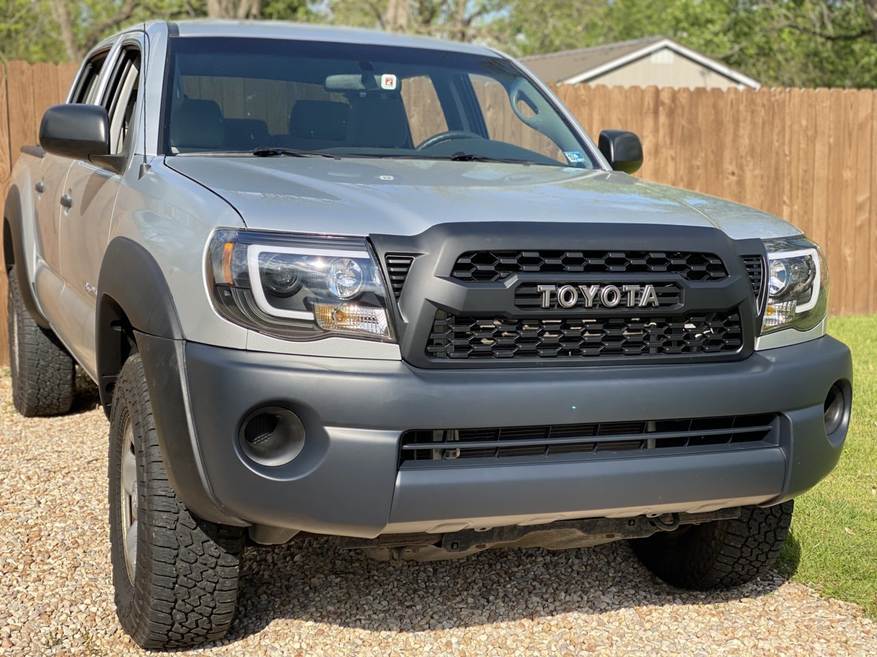

  19. May 11, 2020 at 10:11 PM
    #579
    204Taco
    204Taco Member
    Mar 27, 2020
    #323124
    8
    TJ
    Manitoba, Canada
    2008 Tacoma trd sport
    Sweet thanks! I'll check them out
  20. May 12, 2020 at 10:12 AM
    #580
    Hunter_Bick12
    Hunter_Bick12 Just a Yota guy
    Jun 1, 2017
    #220461
    417
    Hunter
    Alabama
    2011 Black DCSB TX TRD Prerunner, 1986 Gray SR5 4x4
    I love these headlights, is the LED “C” shape thingy actually bright enough to run in the daytime?
