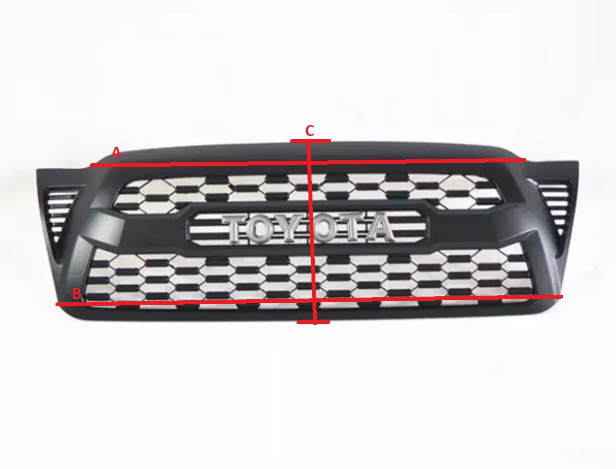

    Can anyone help me out with measurements for this grille? A, B, and C?
    Trying to retrofit it into a different toyota truck.
    Thanks!

    The pro grille sold by TacomaLifestyle has a removable centre mesh. Might make what you're trying a lot easier.

    Thanks! The chinese have since made one that fits my application!

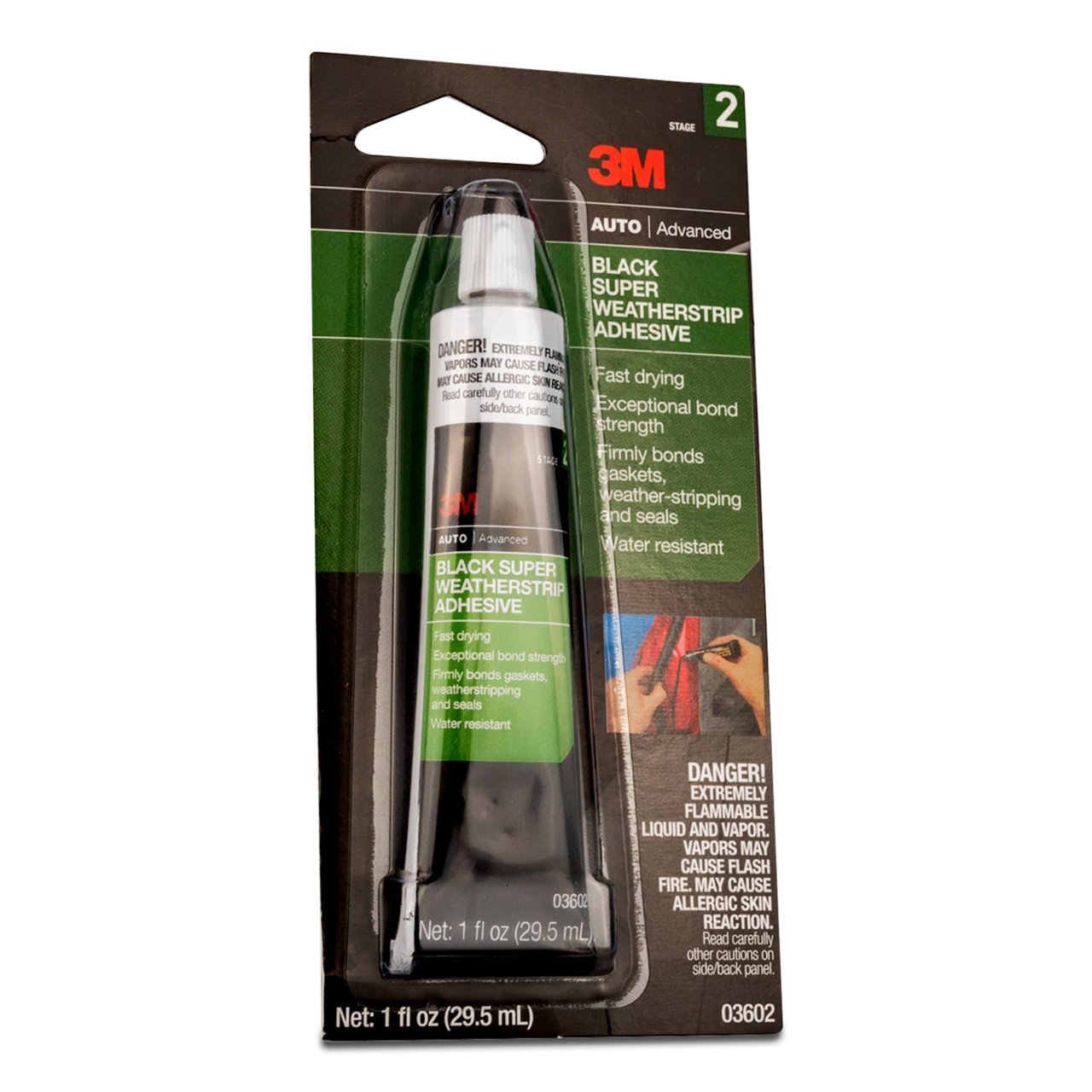

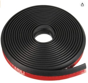

    For those of you who tried 3M’s Super Weatherstrip Ahesive using the silicone weather striping that comes with the 2nd gen pro grill ... well it did not work for me and failed to stick well to the silicone strip.
    So I tried the "Etopars 157" 4M Z Shape Car Door Trim Edge Moulding Rubber Weatherstrip" on Amazon that Buffdeez suggested (posting #247) and it worked GREAT!!! It was also less expensive for 157" at only $9.00 here:
    Etopars 157" 4M Z Shape Car Door Trim Edge Moulding Rubber Weatherstrip Seal Strip Auto (amazon.com)
    I had to remove the 3M's adhesive that was stuck on the plastic with a wood file and then sand paper. I finished sanding using very fine sandpaper to make it smooth, and I cleaned the sanded area with rubbing alcohol. Then after it dried, I taped the rubber strip on the top edge of the grill and it stuck VERY well .. I found it very difficult to remove. I'm very happy with the result!
    Hope this helps!

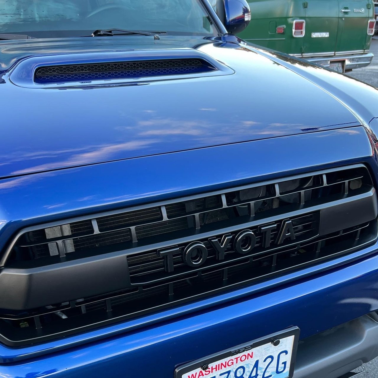

    I went with a pro-style grill-only from Running 4 Tacos, and painted the letters gloss black, for a black chrome effect on the satin grill. I did need to remove one of the tabs from my OEM surround.

    That looks really sharp ! :thumbsup:

    is your truck impluse red pearl? Holy paint gloss! Mine is an 06 impulse red pearl and i need to have my side fenders painted the clear is gone but then again thinkng about wrapping my truck in a matte tan.

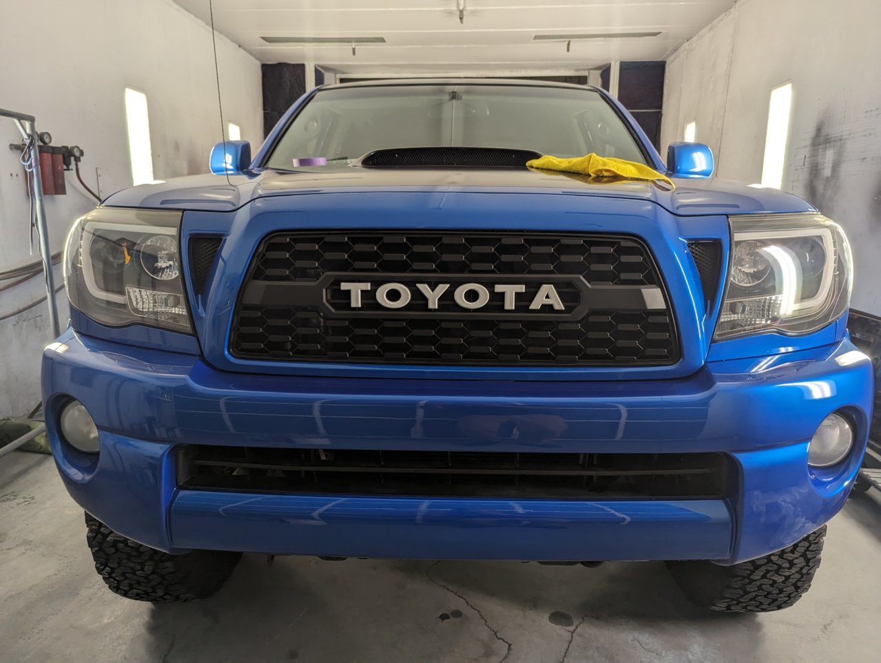

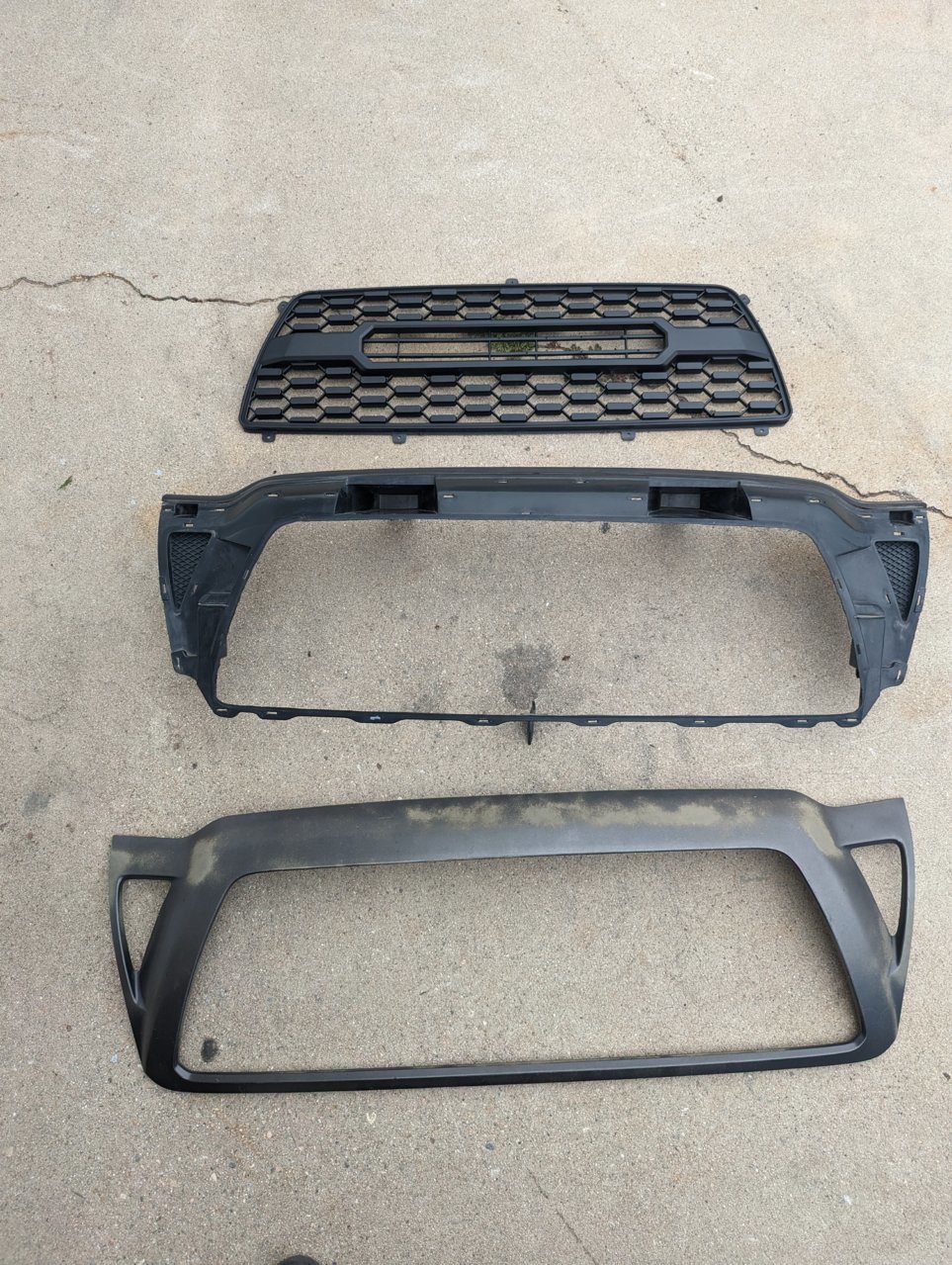

    Just got my whole truck painted and added this grille to mine. I did modify the stock grille to fit the center piece of the new one. Reason I did this was the outer piece or the piece that bolts on to the truck was very flimsy and I didn't like that weatherstrip it came with. This way I got to use the stock weatherstrip and it's more sturdy
