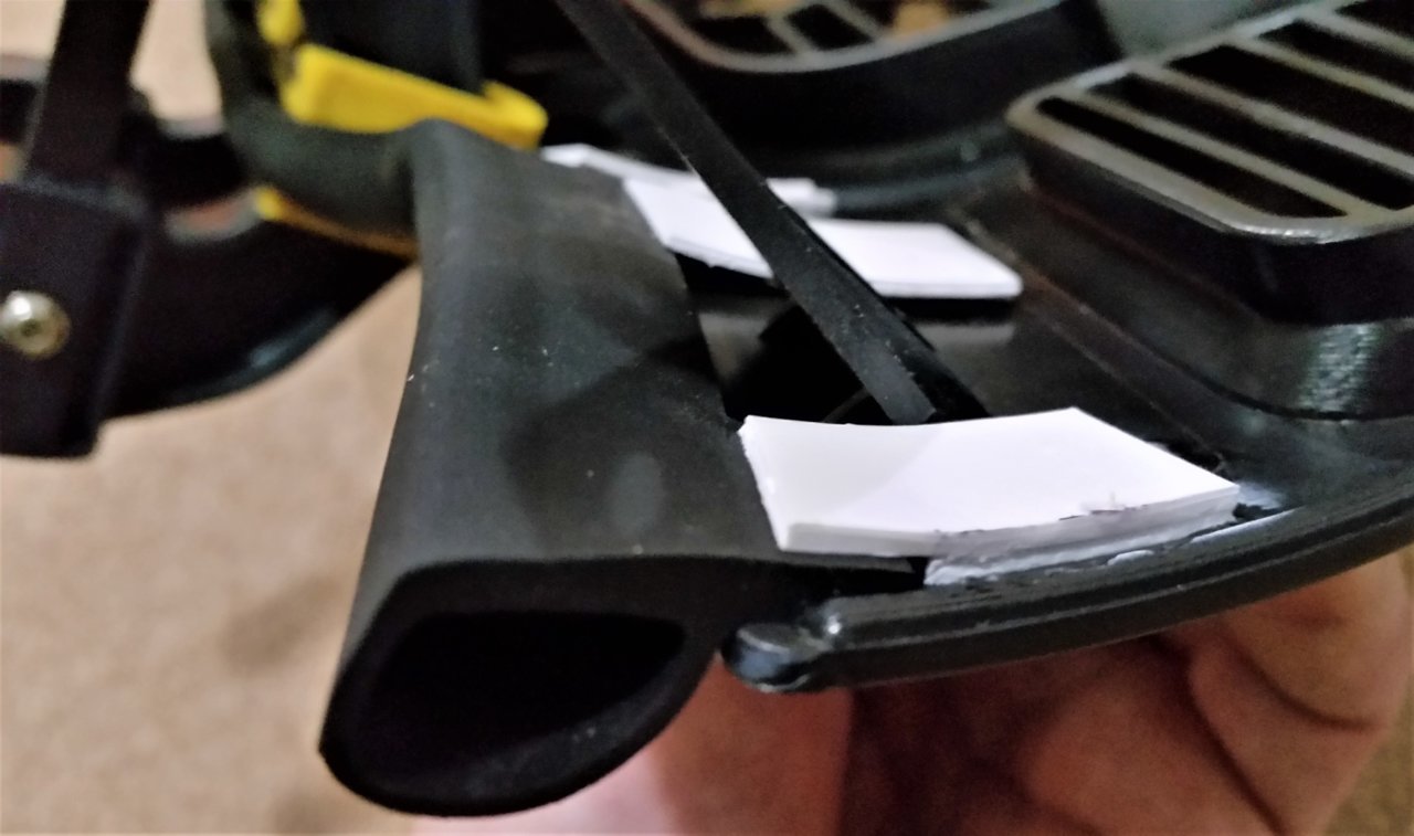

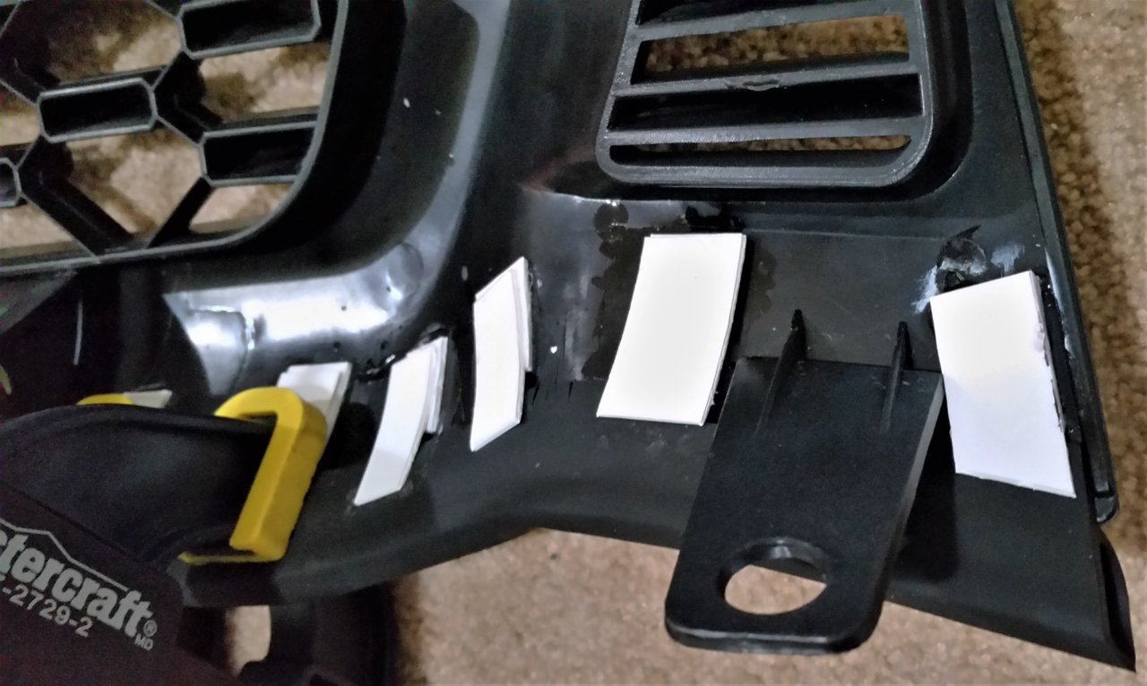

    This is what i've been working on to attach the weather strip. I cut some plastic tabs and super glued them to the grill, then glued another longer tab on to it which sandwiches the tab on the weather strip. I will update when finished.

    Tabs look to be the best way to adhere it!

    how has this held up so far?

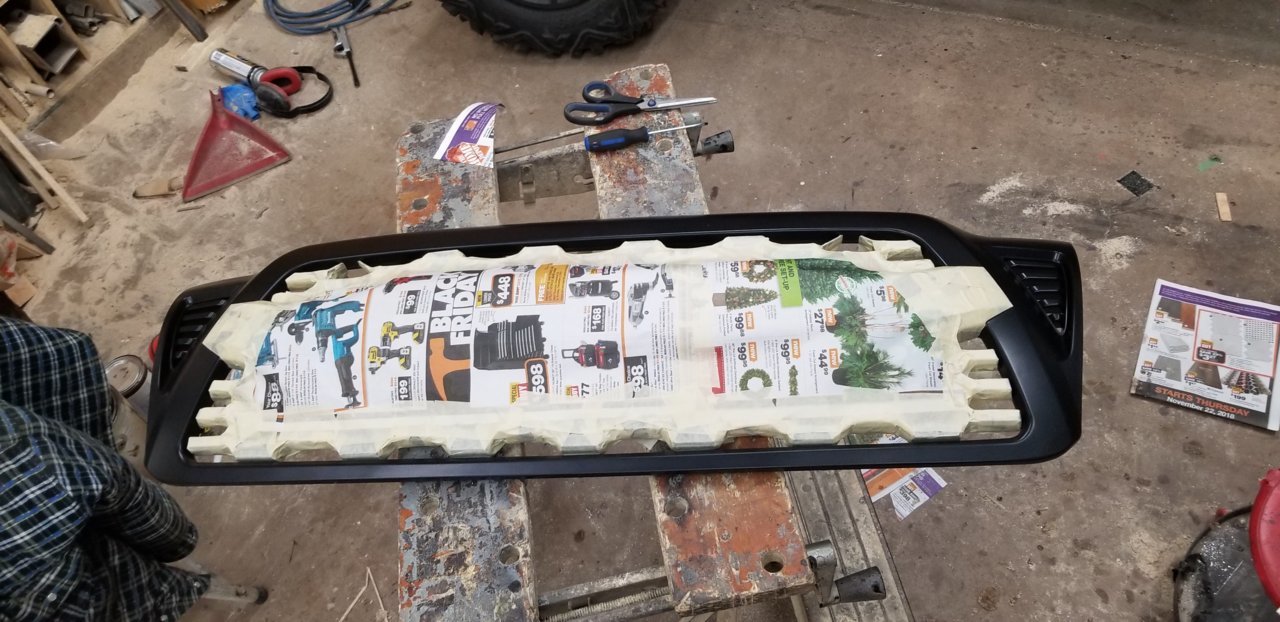

    Here is how I will be color matching mine. Hopefully be done by this weekend.

    hell yea

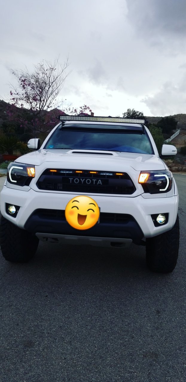

    IMG_20180303_160939_377.jpgI install my raptor lights
