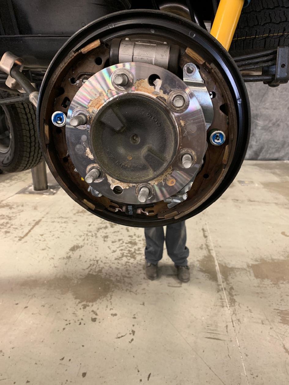

    That paper-like gasket between the drum and flange needs to be cleaned up and replaced or it will not allow the drum to sit flush. Ask me how I know.

    Aren't there child labor laws for that kid working on the other side?

    How do you know?
    Skydvrr and rzgkane[QUOTED] like this.
