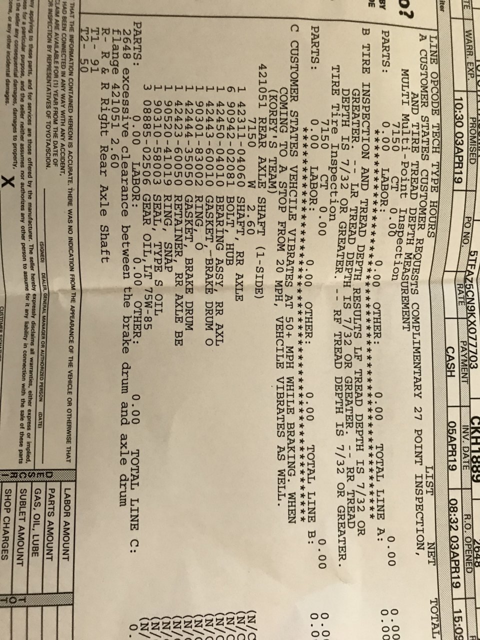

    This time they replaced the right rear axles Will see how it goes.
    Matchu likes this.

    Phil
    Yavapai County Arizona
    Super White 2017 Tacoma DCSB SR 3.5L Auto
    You mean you took your truck in Five times and they just now got around to checking this on the Fifth go around? Not only do we take it in the rear from Toyota but from the dealers too. Fingers crossed this corrects the problem for you and they’re not just throwing parts at it.
    Mine is still great but I haven’t put many miles on it since they replaced both the axles.

    @Rrowdy,
    Service done so far
    First time: resurfaced the drums
    Second time: replaced both rear axles
    Third time: replaced drums
    Fourth time: resurfaced drums again
    Fifth time: replace right axle only
    Next time lemon Laws
