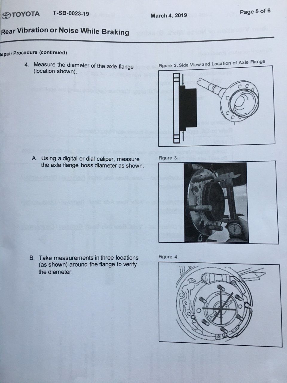

    Hopefully they’ll check your axles for being undersized which causes the drums to run eccentric to the axles. They had to to replace both
    of mine for this. Good luck!

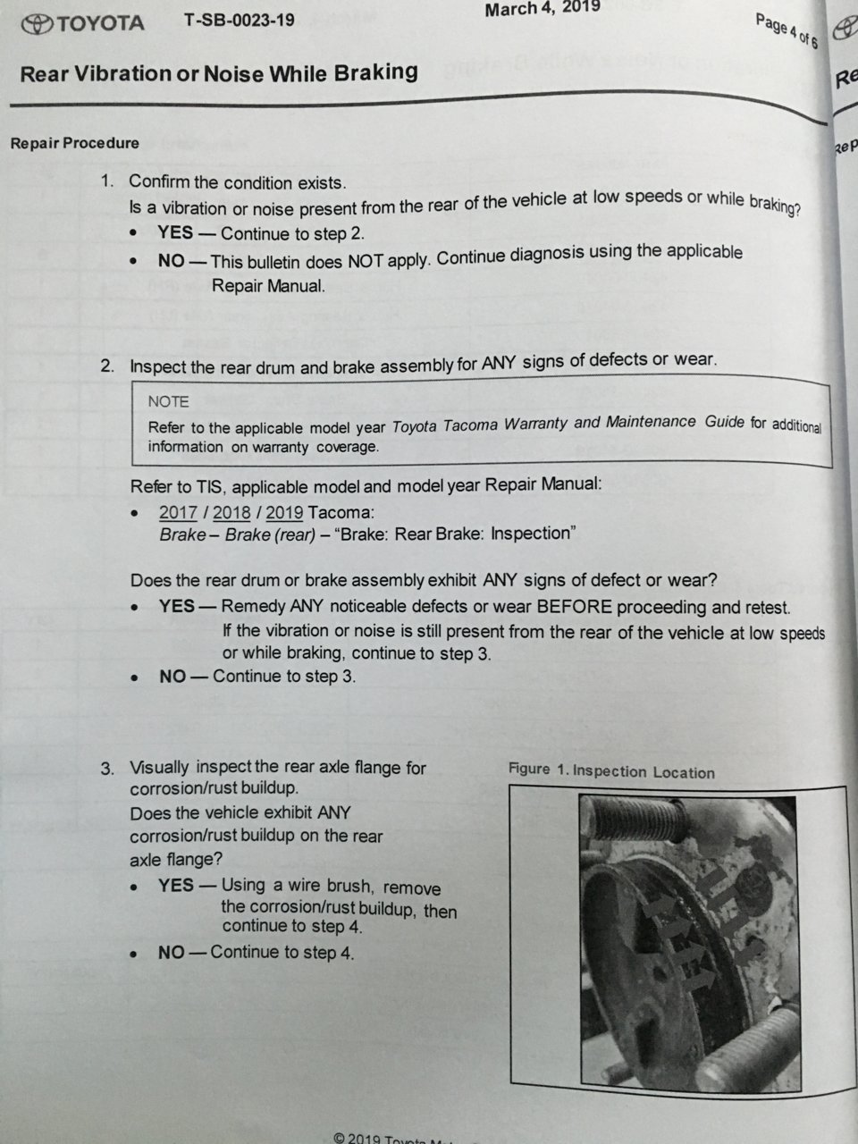

    Yes, that’s a good question. I guess Toyota’s QC isn’t what it once was. The drums don’t center on the lug studs they center on the hub shoulder which is part of the axle. when the hub shoulder is undersized the drum is no longer perfectly centered. I was looking for a 2nd gen with a 4.0
    but unfortunately I found this truck with 7000 low miles and a good price. Now I have to worry about all this crap going on and also this engine.
    My wifes 2013 Highlander will run circles around my truck and is a lot less complicated.

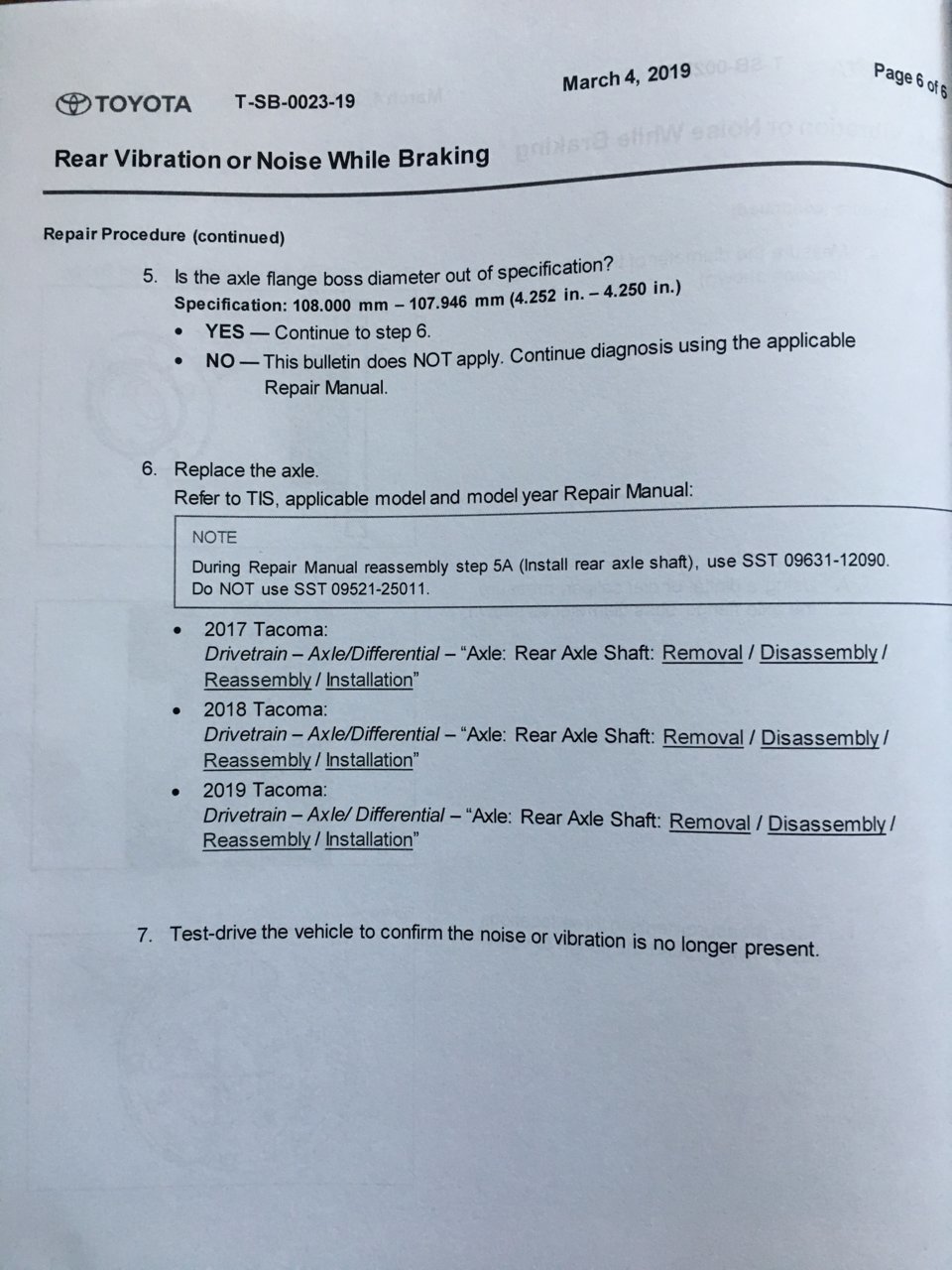

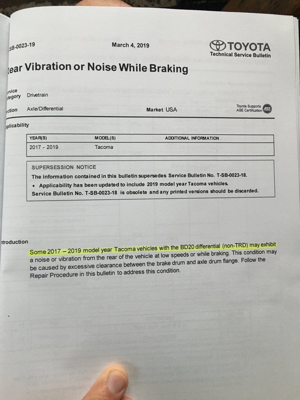

    This is a detail of TSB-0023-19. It shows a detail of the faulty rear axles, leading the rear brake drum warping.
    Tacoma1818 likes this.

    Non-TRD - interesting. I’ve got the shakes and its the TRD locker. I’ll let y’all know if the drums fix it
