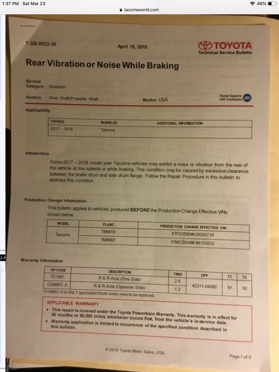

    Interesting. Wonder why your N is different from mine. S/B same everywhere else but trans.
    Regardless, good luck with Toyota. There is a TSB for the SR5. Did your dealer apply that?

    138
    Sin City
    2019 T4R TRD OR
    Which TSB?

    TSB 0023-19 is the other one I have seen.
