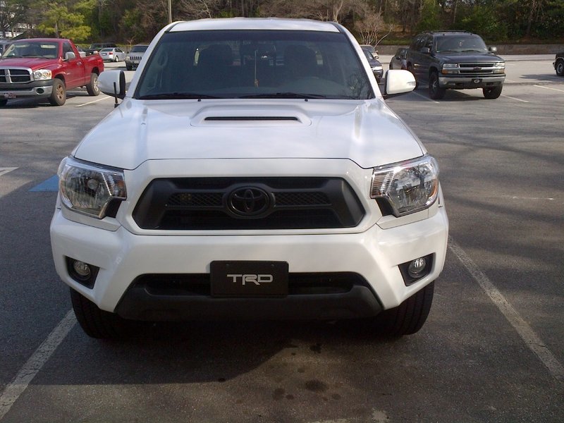

    JimmyThammavong
    JimmyThammavong Well-Known Member
    Jan 13, 2013
    #95131
    49
    Jimmy
    Lawrenceville
    missed my old Truck 2013 Tacoma TRD Sport

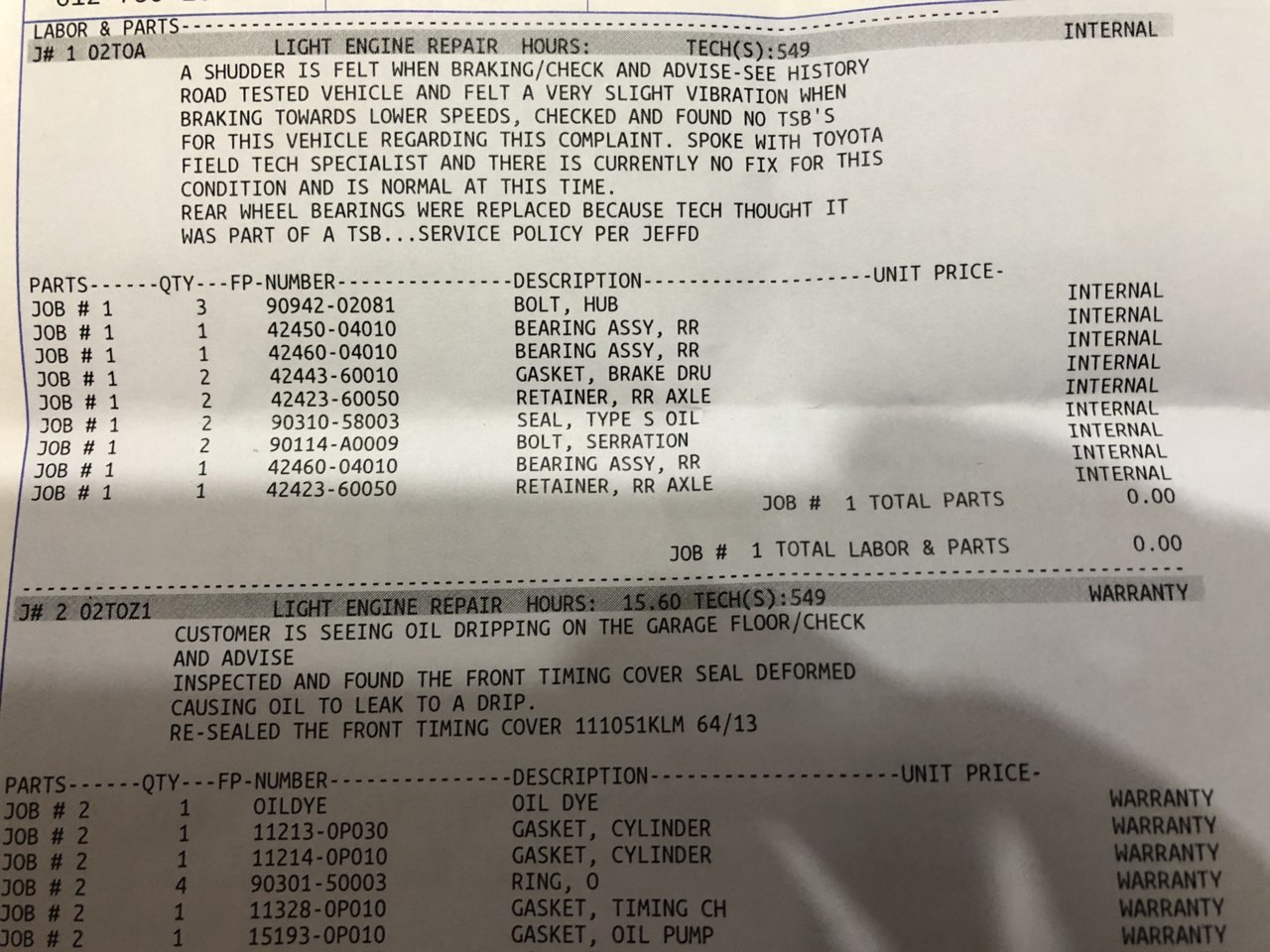

    Zoop
    Zoop Well-Known Member
    Oct 27, 2016
    #200797
    470
    I’ve had the same issue since about 5k miles, finally got them to acknowledge it, went in for a “1 day fix”, turned into a 31 day debacle.
    They thought they had a TSB for it, then found out it applied to non-TRD differentials, they used some parts to try to remedy it. After taking this photo for this thread, their write up sounds a bit fishy as they had to wait to get permission to install those parts, no "mistake".
    You can replace “very slight” with “washboard”.
