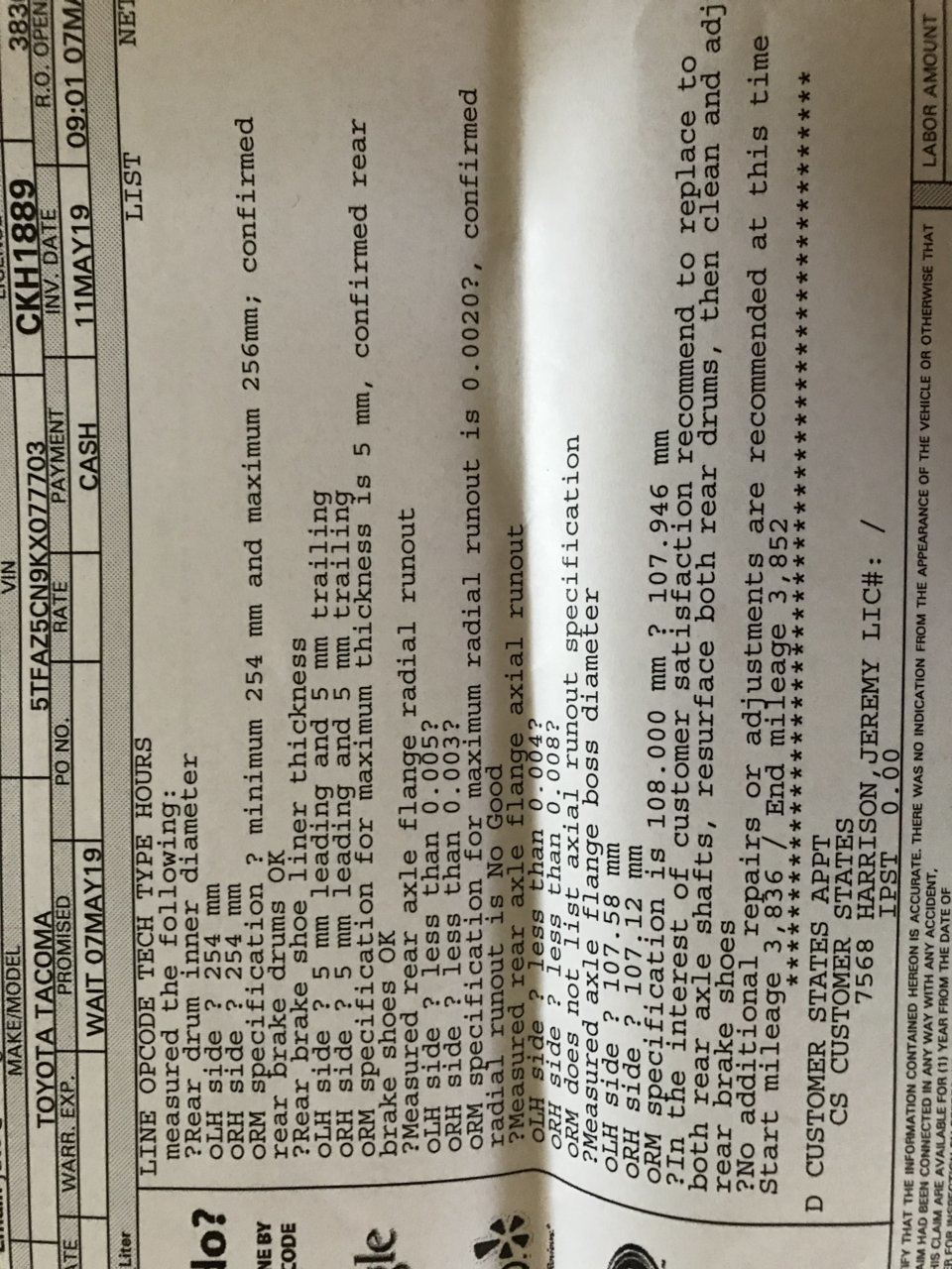

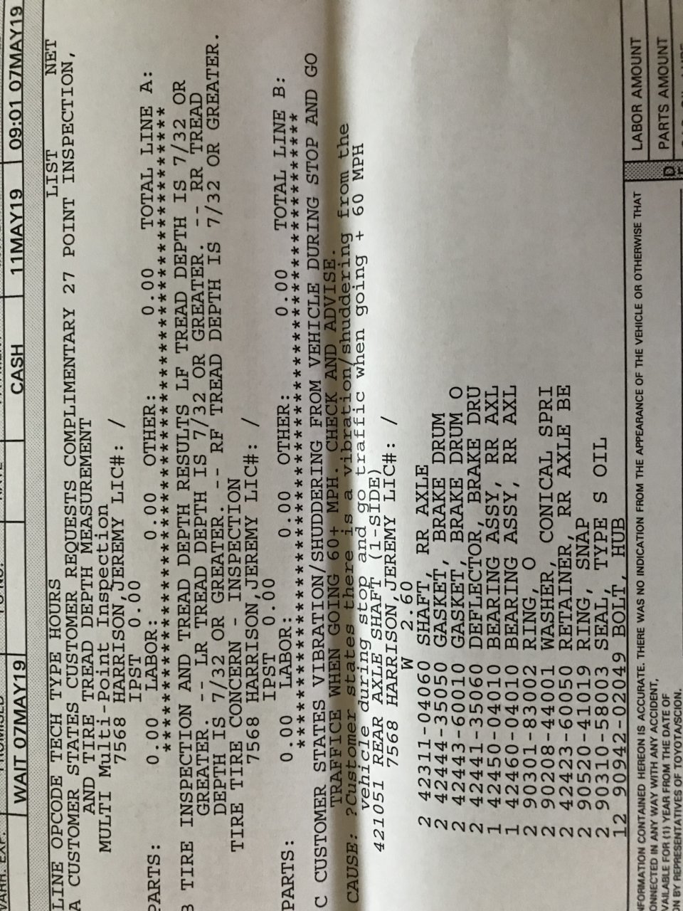

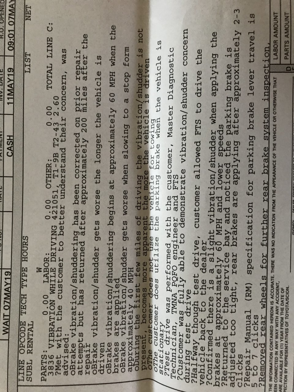

    Toyota corporate sent out field tech/engineer to checking my truck this morning. They acknowledged the vibrations issues and gave me rental truck..

    My vibrate at 50 mph and 30 mph to stop.. Toyota field tech says he needs more times to diagnose. They gave me a rental truck 2018 Tacoma sr5 it’s drive real smooth and it feels like it more power than mine 2019 red off road

    Update from my service advisor:
    I GOT YOU. THE GUY WHO CAME OUT WAS FROM TOYOTA NORTH AMERICA. HE GAVE US THE GREEN LIGHT ON ALL THE PARTS; HE ORDERED THE PARTS; HE INSPECTED IT; HE TOOK THE MEASUREMENTS, SO WE'RE STRICTLY GOING OFF HIS RECOMMENDATIONS. HE WAS AND IS FULLY AWARE THAT THE AXLES HAVE BEEN WORKED ON TWICE LOL. THERE'S JUST SOMETHING OFF ABOUT ONE OF THEM. I'M NOT SURE WHY. THEY ARE BUT MACHINES... YA KNOW?

    Just picked up the truck minutes ago. They doing the rear axles again(3)times except this time they had the best master technician worked on it.
    Will see how it goes in couple weeks.

    On my 2019 Tacoma off road 4x4, they replace both rear axles, both rear backing parking plates, a bunch bolts, seals, bearings that go with the axles, and they resurfaced the rear drums. I immediately felt the difference. The vibrating is gone. It’s been about 400 miles since the repair and so far so good.

    Have had my 2019 Tacoma now for exactly 2 months with 2,285 miles on it. Took it in because the vibration when breaking seemed to be a little excessive. Having to replace the rear axle and other items because of it. Guys said today it’s a known issue.
