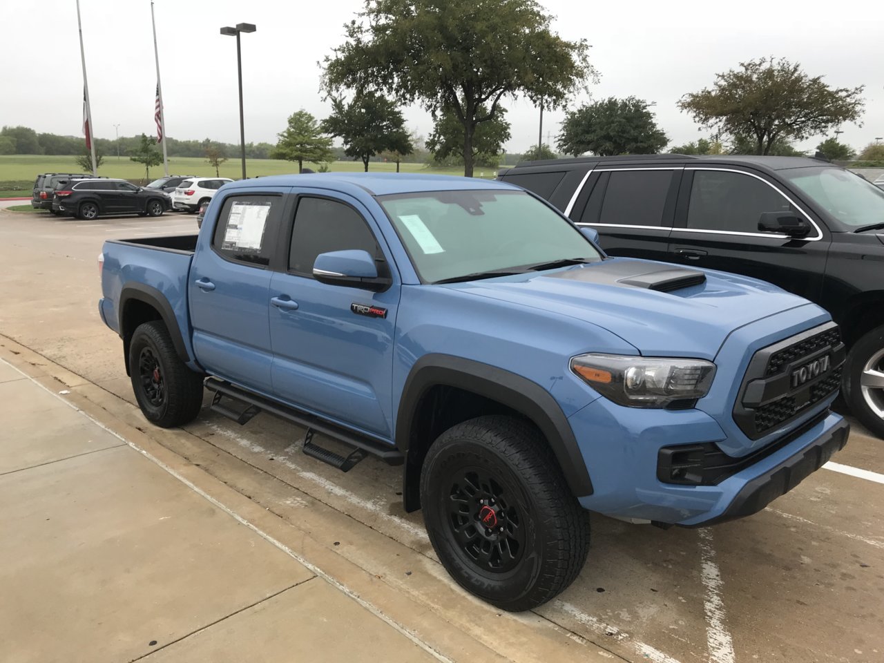

    You keep the stickers in the windows?

    Full tank of gas
    No. That was on Tuesday when I bought it. It was after I test drove it and then went in and signed the paperwork

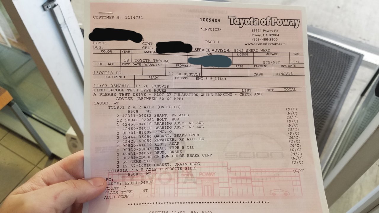

    2018 Tacoma TRD Sport bought October 14th. November 5th right now. 550 miles on the odometer. Noticed it at about 200 miles but was probably happening sooner but this is my first truck so I thought it was something to do with the truck. I finally said this is not normal and got a friend to drive it as well who agreed. It's at the Poway, California Toyota dealership now where I wasted 3 hours of my life today and they are replacing the rear axles via TSB. The tech said this was his first Tacoma for this service bulletin. I hope this solves it. Bought a Tacoma for the allegedly reliability. Not off to a good start.

    20181107_165643.jpg They did the 0023 service bulletin. Replaced $3000 dollars worth of parts. Appears to have fixed the issue from the 5-6 miles I have driven so far..

    Got my Tacoma 4x4 fixed last night with all the same repairs you have here. Rear vibration is completely gone now.
