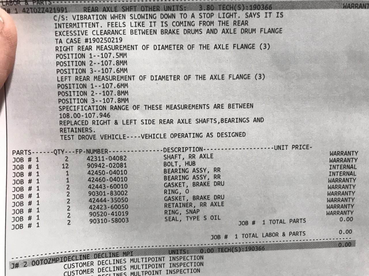

    2019 trd sport 4x4...700 miles ..purchased dec 29 2018 ...after 1st week or so started to get vibrations from rear when braking from 50 mph or so...but it was random...found this thread so I called service department and scheduled appointment for today. I did not tell them that I knew about tsb 23. Advised vibrations from rear randomly when braking. Technician drove truck and felt vibrations, with further testing they called toyota ...gave me a loaner and they have ordered the parts for new rear axle per this tsb....they advised they should have truck ready by Wednesday. Will let you know if this fixes mine.....stay tuned...........

    Well....just got mine back today they had it 6 days counting weekend...only problem...i test drove it about 10 miles after picking it up this afternoon and its still there...almost wanted to cry...i will be talking with them again in the morning ...back to the dealer for me....will update later

    Kinda shocked they leapt to the axles without checking the drums first, seems like that would have been the logical order. Sorry the new axles didn’t work out, looking forward to your resolution.

  12. Jan 31, 2019 at 5:06 PM
    #92
    Cl4aub
    Cl4aub Well-Known Member
    May 11, 2016
    #186710
    78
    Montgomery, Al
    2019 TRD Sport 4x4
    4CAF5C83-650E-44C4-9086-908C87DB574A.jpg Here is my copy from work done...that did not fix my problem...I asked him what tsb this was and he said it didn’t have one because mine is a 2019 and the original tsb was for 2017/2018
    SaulGoodman likes this.
