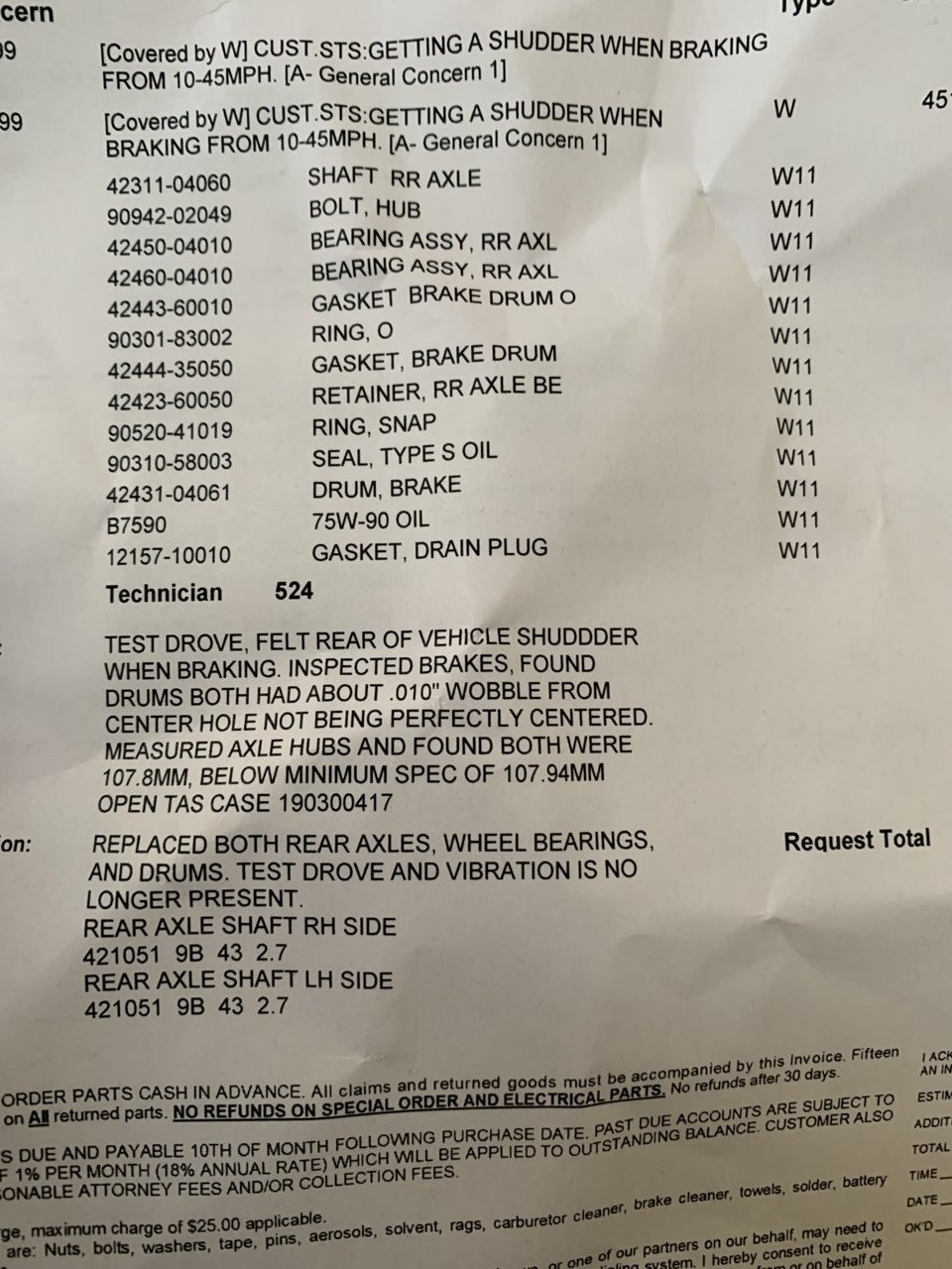

    Just got mine back. Here is what they did. It is the same as several others. As you can at the bottom they included specifics about the axle measurements and drums. I’ll post again once I get a chance to take it for a spin. The service manager delivered it himself to my house over an hour away and said it was super smooth the whole way. I’ll report back shortly.

    Initial results are looking good. The rumble strip like shuddering is completely gone. There is still a very slight vibration when braking from around 20-10mph but nothing like before. It feels like other 2019s (that didn’t have problems) that I drove so I think it is normal. Time will tell. Also, for anyone in the NW or specifically the Portland area Beaverton Toyota is who fixed it. I bought the truck at Wilsonville and they completely blew it off and tried to tell me it was normal. Beaverton, however, has been outstanding every step of the way and went to bat to get the work approved by Toyota. I’ll never go to Wilsonville again but give Beaverton two thumbs up....just my opinion.

    I see where they replaced your drums when they replaced axles...they did not do the new drums when they replaced my axles and advisor said they should have replaced , resurfaced or checked drums after the axle procedure the first time...but looks like they have done the same on both of ours...today mine drove extremely well ..I just hope it stays that way

    funny observation is that they used a 75W90 oil instead of the Toyota recommended 75W85 on that list
