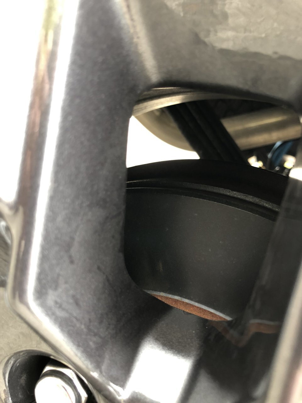

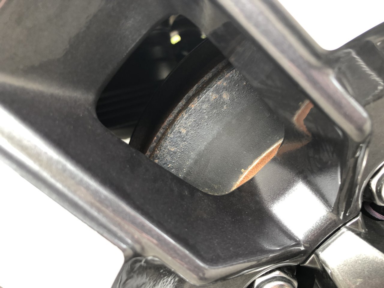

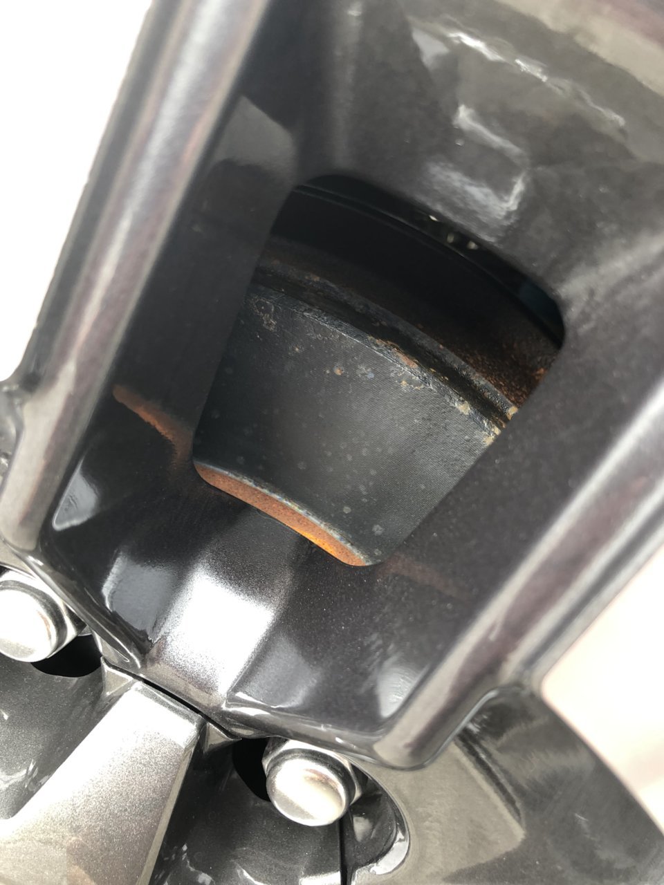

    Hey can you possibly take a peak at my drums and see if they look strange from the pic. I took pics of both sides and my drivers side drum looks dimpled/rusty and old compared to the passenger side. Could this be causing my braking issue?passenger.jpgIMG_1590.jpg
    passenger side pic is in the middle, 1st and 3rd are drivers . Why such a discrepancy in the amount of rust on a new truck's drums. Shouldn't they be evenly rusted lol

    The face of the drum with rust on it doesnt matter. its the rear axle flange where the drum sits that has to be inspected for corrosion. there is also a tsb out for the axles being out of round causing too much space between the brake drum and axle drum flange.
    we did a passenger side rear axle and drums today.
