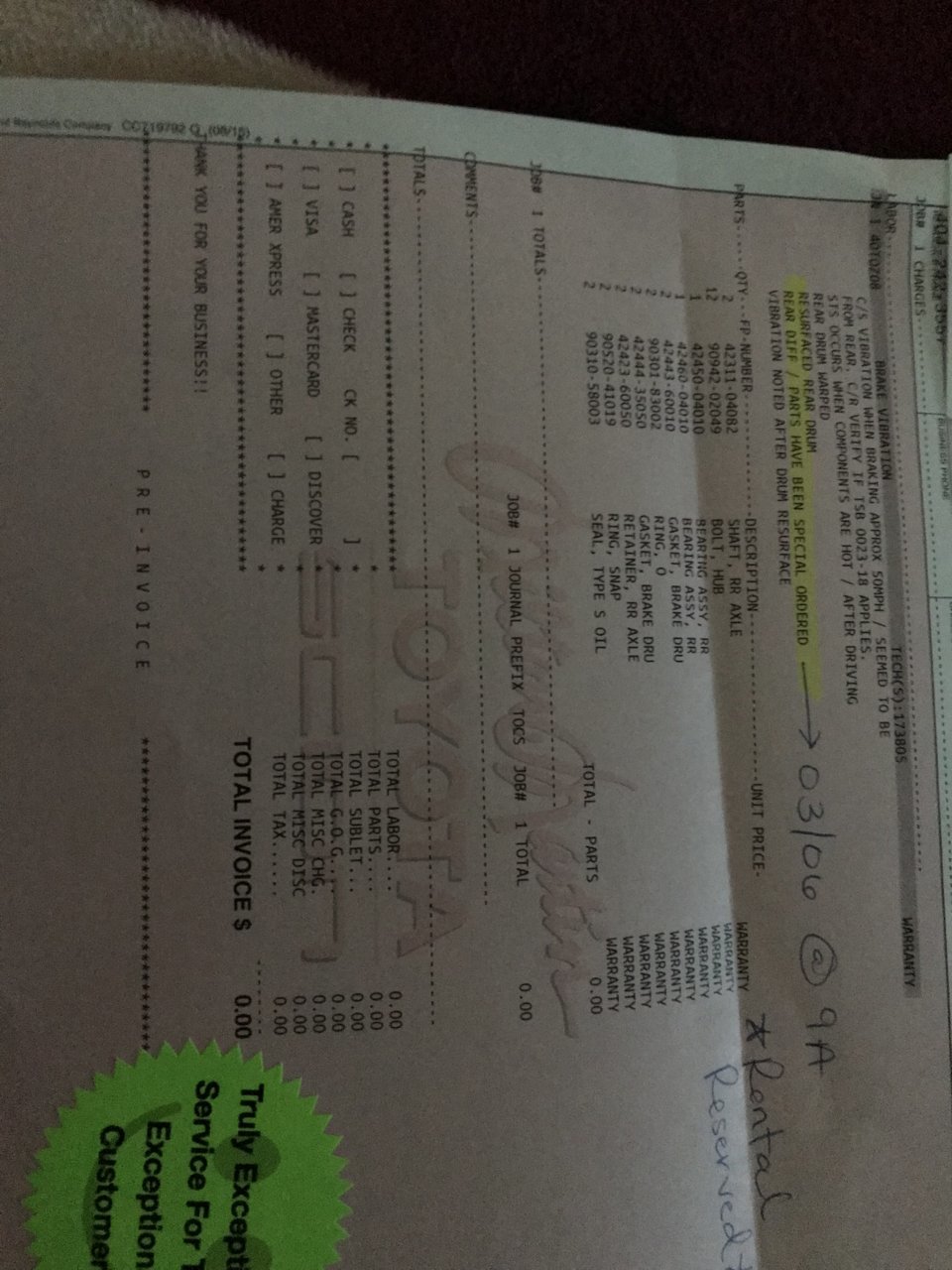

    Will have mine rear differential replaced in couple days parts has been ordered.
    I have 2019 Toyota Tacoma..

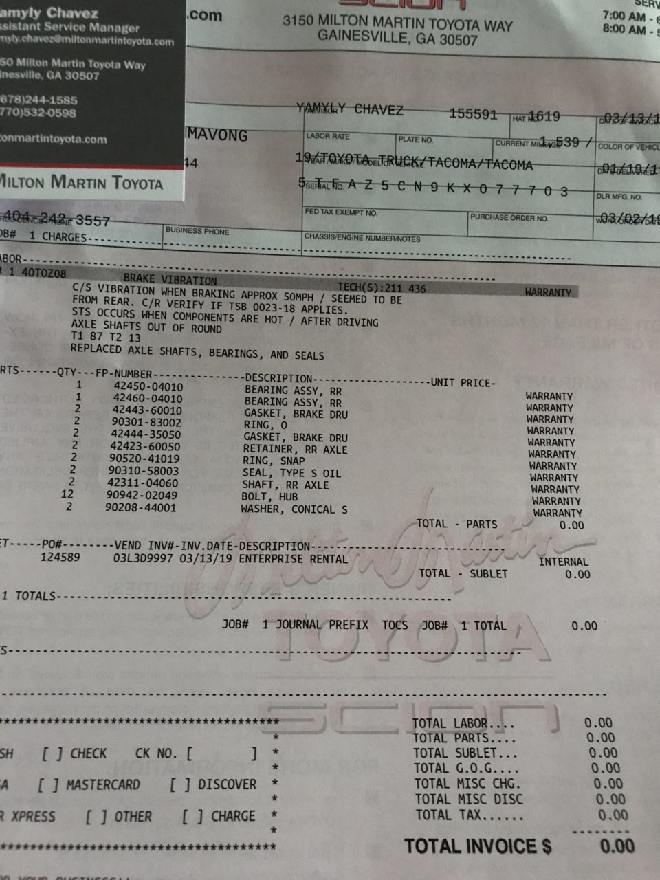

    I have a 2019 trd off road with the same issue approx 3,000 miles on it got it with less than one hundred miles on it done it since day one.

    I finally had a chance to put some miles on mine since getting it back after the rear axle tsb was done. They delivered it the day before I left on a month long business trip so that is the cause of my delayed update. It is a night and day difference now that the axles and drums were replaced and are in spec. It is much smoother. Now instead of being filled with dread about buying the truck I am totally in love with it. I'm still irritated about all the hassle I had to go through and the fact that half of the first month I owned it the dealership had it. However, they did get it fixed. For some of you guys that are going through drums it is likely because of your axle flanges. Also, both the axles and the drums (along with all the other parts involved) need to be done at the same time. That is why some of you are still having problems after they only did one or the other. If your axles check out to be in spec but you are still having issues with drums needing turned it may be that the drums themselves have an issue with the mounting holes not being centered. That is what they found on mine in addition to the axle flanges being out of spec. The body of the drum was in round, but the rotational axis was jacked up. As far as the tsb not covering 2019's or TRD's that is irrelevant. Toyota is completely aware of this issue and you can get it covered. The dealership that fixed mine directly told me this. I hope you guys get everything taken care of. I can only imagine that most of you are just as frustrated and pissed off as I was. Best of luck.

    Picked up the truck today after a week in the shop. They ordered the wrong rear axles parts 42311-0480 instead of 42311-0460.
    So far so good but will se how it goes for the rest of the week.
