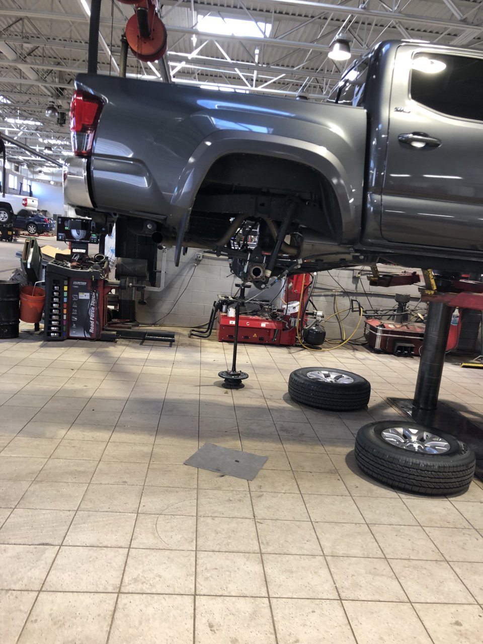

    Here’s another one today
  6. Mar 18, 2019 at 1:34 PM
    #166
    rzgkane
    rzgkane Well-Known Member
    Oct 1, 2012
    #88082
    705
    Huntington Beach, CA
    2019 Tacoma TDR Sport 4WD DCLB - Cement - Tech and Premium
    4Runner Trail wheels and Toyo Open Country ATII tires 265-70-17. Cosmetic stuff like Pro grille and OffRoad black bumper trim, vinyl delete on side, added hood graphic, OEM tube steps.
    And the spin begins. If you have to do something unorthodox to reveal a difficult to reproduce problem, you aren't operating the vehicle in real world conditions and therefore no problem exists. The age old excuse to do nothing.
