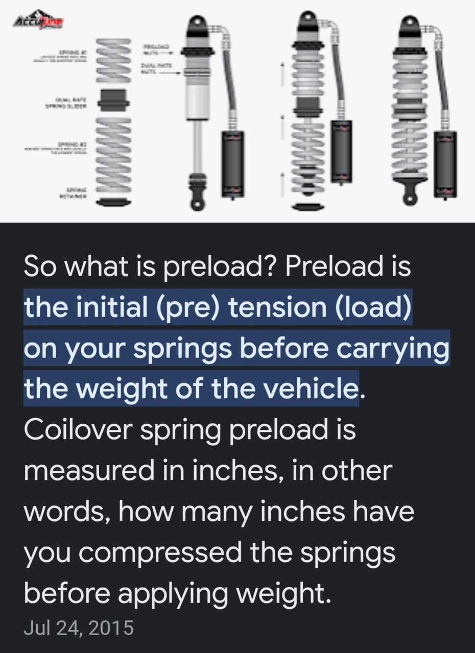

    Preload is how compressed the spring is on the coilover before the weight of thee vehicle compresses it. Whether you move the lower perch up to compress the spring before installation on the vehicle or put a spacer between the top of the spring and the "hat" of the coilover you have increased preload.

    Not specifically about the 5100s, but this shows how preload changes the height but does not compress the spring.
    https://accutuneoffroad.com/articles/coilover-spring-rates-for-toyota-tacoma-4runner/
    "Some people associate preload (loosely related to threads showing above spring nut) with a harsh ride because they are “cranking down” the spring. Increasing preload only raises ride height, it does not compress the spring more, and it does not make the ride rougher. The only time too much preload causes a rough ride is if you lift it too high and don’t have any down travel, or if the spring runs out of travel before the suspension bottoms out."​

    Take the coilover out of the truck, put it on the workbench, and take the center nut off of the hat. After the spring flies off and hopefully doesn't injure you, you'll realize that the spring was absolutely compressed before the weight of the vehicle was put on it.

    If the top hat is in a fixed location and you move the lower perch closer to it you have compressed the spring more because there is less space between the two.

    Try a little thought experiment. Imagine the truck with 5100s on the lowest setting. The truck sits at a given height and the weight is resting on the spring to give it that height. Now imagine moving the bottom perch to the top one. If doing this only compressed the spring, the ride height wouldn't change. In reality, moving the perch up moves the whole truck up and the spring retains the same compression as before.
    Look closely at the Accutune explanation. The spring at ride height isn't changing length. Instead, the the top mount attached to the frame moves up and thus lifts the truck.

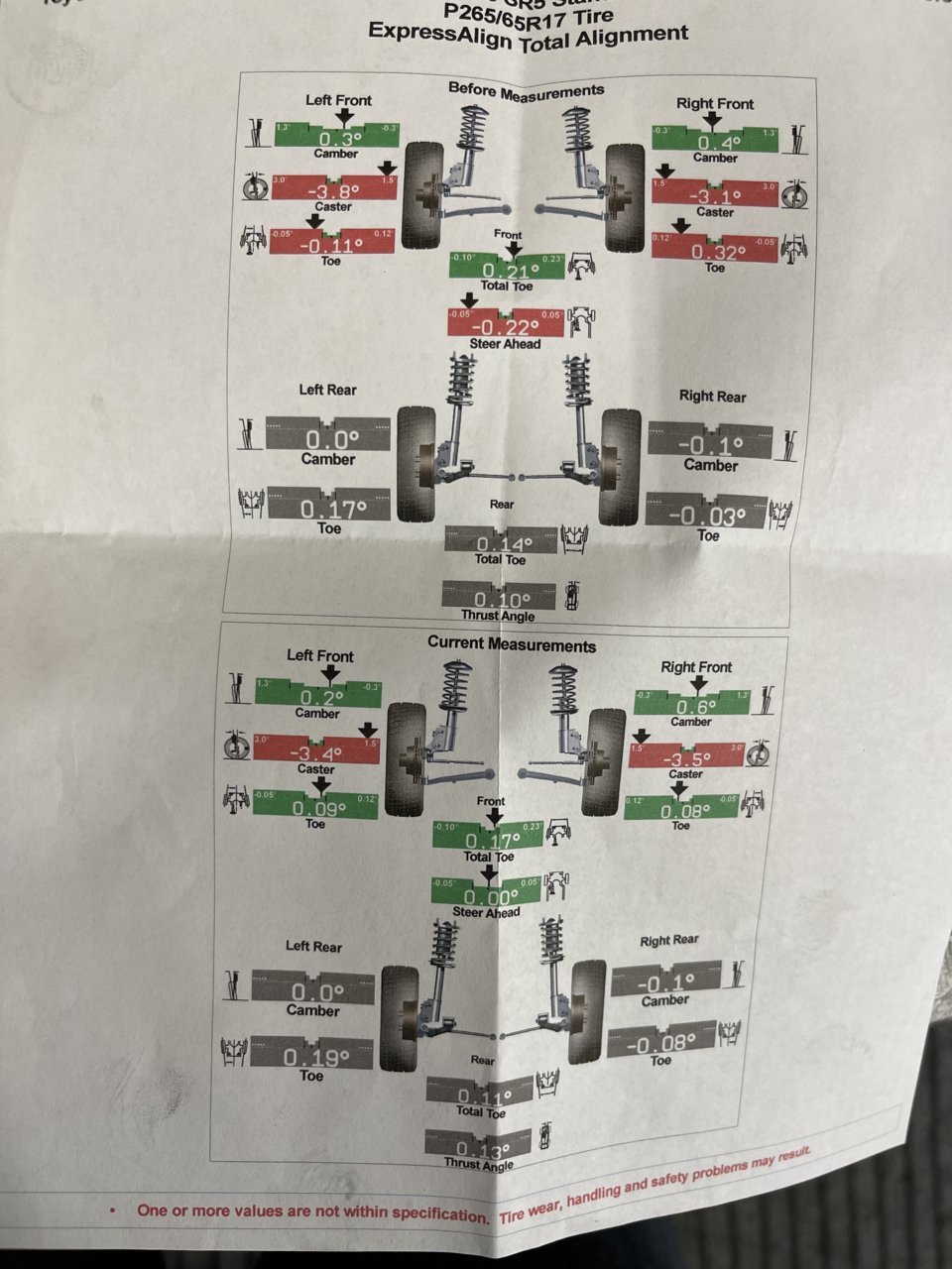

  13. May 1, 2023 at 9:53 AM
    #33
    johnnytwotimes
    johnnytwotimes [OP] Well-Known Member
    Feb 3, 2021
    #354931
    217
    SoCAL
    2021 TRD OR DCSB
    Here’s my alignment numbers
    TRDRed likes this.

  16. May 1, 2023 at 5:37 PM
    #36
    boston23
    boston23 Well-Known Member
    Sep 4, 2019
    #304290
    3,746
    Adam
    Eastie
    2019 SR5 DCSB 4x4

  18. May 1, 2023 at 5:45 PM
    #38
    Bishop84
    Bishop84 Well-Known Member
    Dec 17, 2015
    #172494
    12,006
    Why the heck is the caster negative. Someone let the lube kid do your alignment.
  19. May 1, 2023 at 5:48 PM
    #39
    Tucker2020!
    Tucker2020! Well-Known Member
    Mar 22, 2021
    #360210
    134
    I have always wondered - can the caster be adjusted w/ stock UCAs?
  20. May 1, 2023 at 5:49 PM
    #40
    Bishop84
    Dec 17, 2015
    #172494
    12,006
    No, and adjustable UCA oddly exist to allow proper alignment using the LCAs.
    Chevy's are UCA align, and they suuuuuuuck in rust belt areas.
