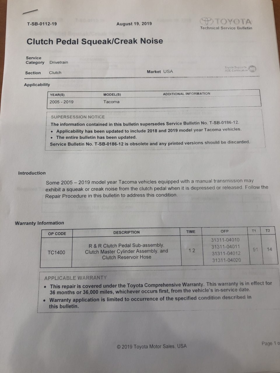

    Started to have my clutch pedal moan and groan and went down to the dealership to talk to them about what I thought fell under T-SB-0186-12.
    Turns out that there is a revised/new TSB effective August 19, 2019 that supersedes the old one and covers Tacoma's from 2005 - 2019. The new one is T-SB-0112-19. Hopefully it's helpful to some of the Manual drivers out there experiencing this.

    Shiro213, CCATT-RN, Twize and 5 others like this.

    Wow, good to know! It's about time they start getting rid of these damn barn doors permanently. From my undersstanding this has been an issue across ALL gens
    I dont have a copy of the previous TSB but has anything changed? Or they just added 2018/19 in there

    thanks for this update. my first fix lasted 18 months or so and my last one isn't. i'm groaning, squeaking, and with significant play again way too soon. so i'll take this and fight with the service manager again. :rolleyes:

    Yeah the bigger fight that I had to go through is that is says if there is a creak to replace the clutch assembly. They obviously would rather just lubricate it and kick that can down the road.
    The bigger question is that I don't think the new clutches are new and improved so is it just going to happen again down the road.... Seems to be too frequent over too long period of time to be a production defect.

    THat's what im trying to ascertain is if they changed anything with parts or procedure from previous TSB. Mine is still quiet from a year ago but its usually around that 18-24 month mark that it relapses

    My dealer has honored a TSB out of warranty since I've had it on record as a known issue. But YMMV there.

    The TSB doesn't even cover people out of the standard manufacturer warranty? Thanks for nothing Toyota.

    Here you go (see attached).
    TSBs can now be found at nthsa.gov. I am not sure when that started, but very cool.
    It says that they TSB parts are new.

    Good to know. I'll mention it to my sa so he can document for down the road issues

    gawd, just saw that. literally thanks for nothing. what a joke.
    i'm still looking for a real solution for this. a different pedal assembly. i just don't want to overdo the custom thing on my DD.
