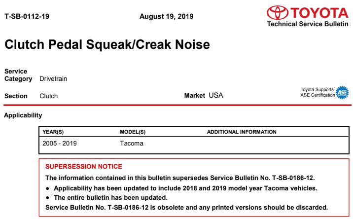

    For the creak. The last time they told me that the TSB does not apply to the 2020s so they just greased it. I might give them a kind reminder that if it's not fixed this time that it's legally a lemon and see to what length they decide to go.

    Interestingly, that is true:
    That is also unfortunate as it seems the updated parts in the TSB don't fully fix the issue.
