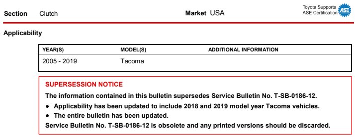

    Well my 2019 creak is getting worse. I ordered some disc brake grease but now I’m thinking that I’ll press for the TSB instead since the grease may just mask the problem and it will return. I’ve already got it on record with the dealer but they “could not duplicate” earlier.
    ps. It almost sounds like the spring. I dunno.

    That's my plan with my 2019. Mine seems to randomly come and go now. Not frequent though. I tried lubing but man it seems tough to get all up in there.
    Will they do the TSB on 2019 trucks? Is my question.

    It sez so:

    Yes, the TSB applies to 2019's.

    They did the TSB on my 2020 even thought it doesn't apply (yet)

    I've had some luck recently smashing some brake grease up between the MC push rod and the black collar that pushes it, as well as where the coils of the spring touch each other. I've also recently noticed now that its not 98* every day that it seems to creak less with cooler weather. Of course now that my 20k service is coming up I've gotten it to mostly stop so I'm certain when I take it in they won't be able to replicate it.

    Updates to the TSB thus far have been done when actual changed to the parts have occurred. Performing the TSB on a 2020 would be putting the same thing that the truck already has into it.
    Not saying the 2020’s won’t be added, but I expect it will happen when and if a further revision is made to the part design(s).
