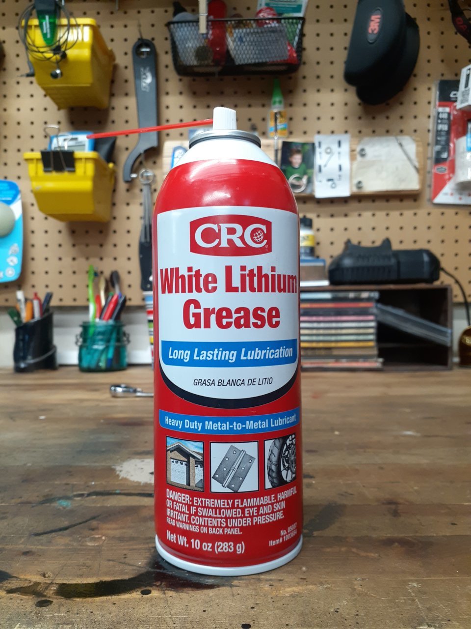

    19 Sport AC-6MT
    I'm just gonna put on my big boy pants and come clean, I'll take the flame......
    I know brake grease blah blahs blah......
    But I'm not going to the dealer for a TSB (or anything else, preferably) or getting on my goddamn back with a Q tip.....LOL.....I'd end up slipping a disc!
    I stuff a rag over the nearby wiring for overspray, bend over as much as is comfortable (that's not too effing much) and drench that whole sunuvabitch with this anytime that pedal feels wonky or makes a single squeak. I think 3x in 16k now.....pedal is golden.
