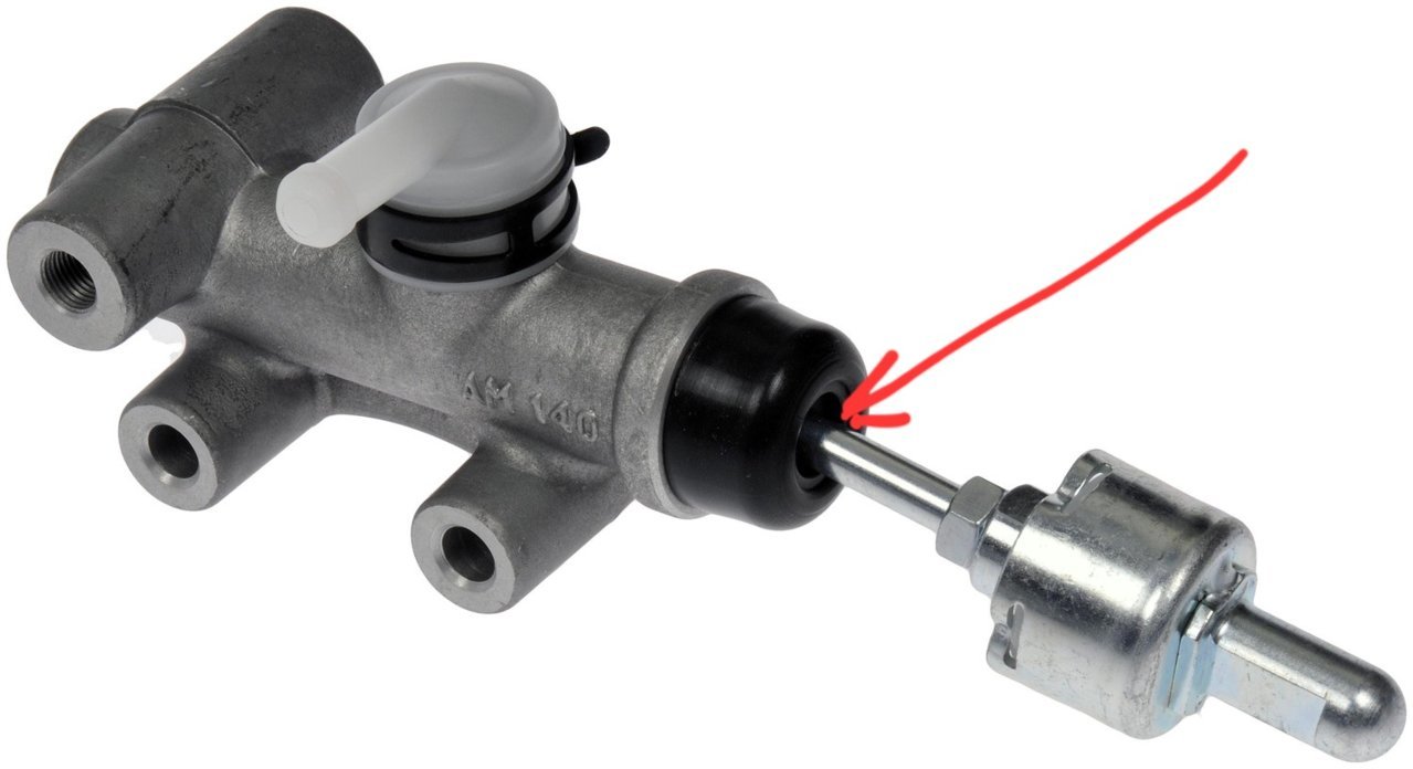

    My 21 Has been squeaking real bad for a while now (truck has 16k on it). I have pinpointed the culprit to the piston binding against the bushing/seal going into the clutch master cylinder. I sprayed some grease on it and it smoothed up the pedal action a ton and the squeak went away...for now.
    Watkinseli91 and doublethebass like this.
