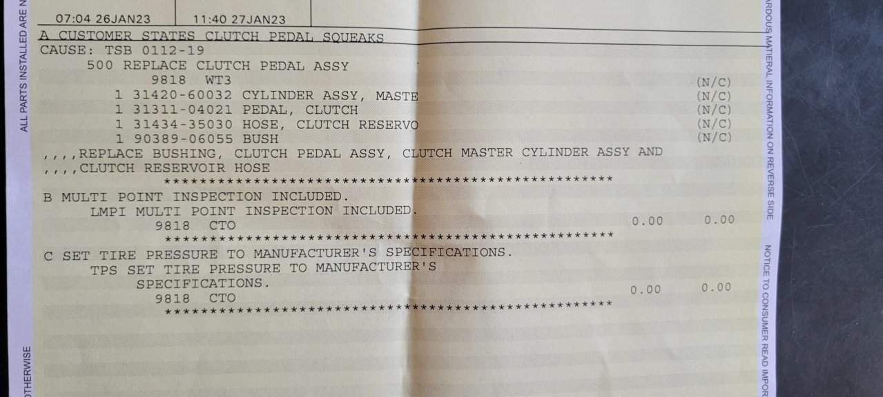

    I just had it covered on a 2020 using the 2019 TSB. Mine was loud as hell, so that helped I'm sure.
