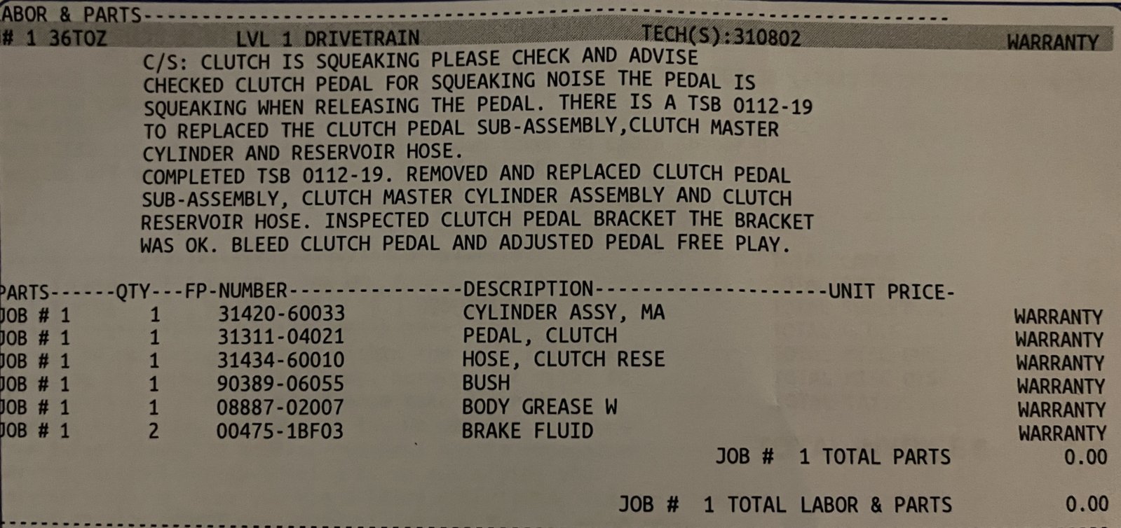

    Yep...still in the loaner - hope to get it back in a day or two. I'll post the a copy of the paperwork detailing the work they did once I get it.
    On a different note, the Tacoma they gave me (Automatic 2022 SR) makes me appreciate the MT even more!

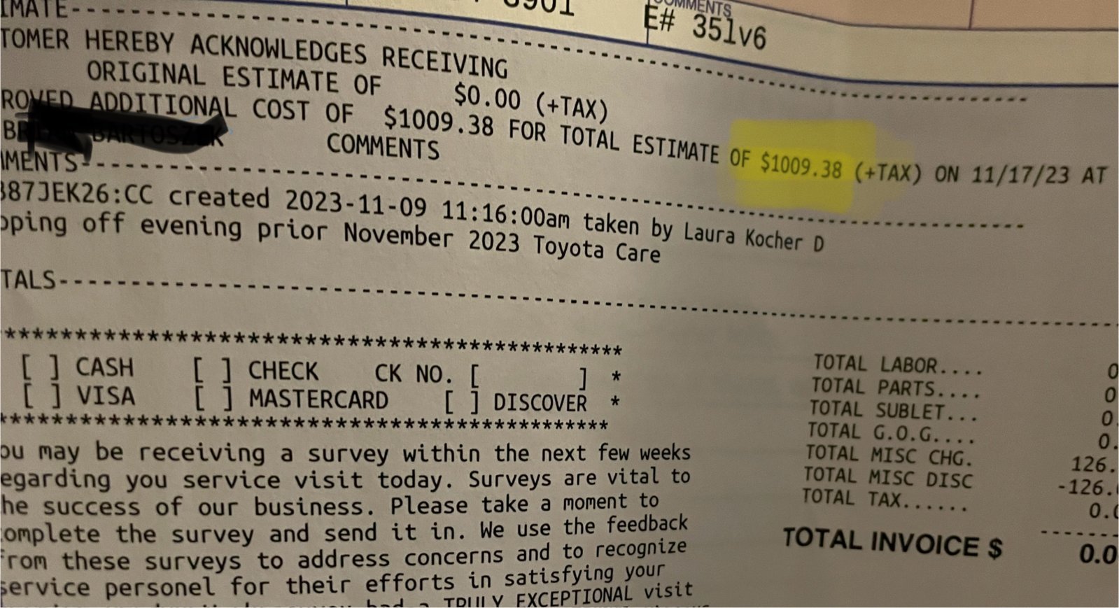

    Tsb complete. Creaking is gone. Clutch feels slightly different (softer maybe?), but works great with no sound!
    Estimated cost was $1,009.38. Lucky, covered by warranty.
