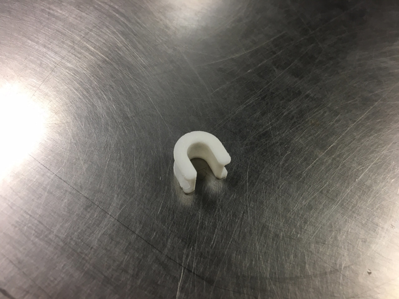

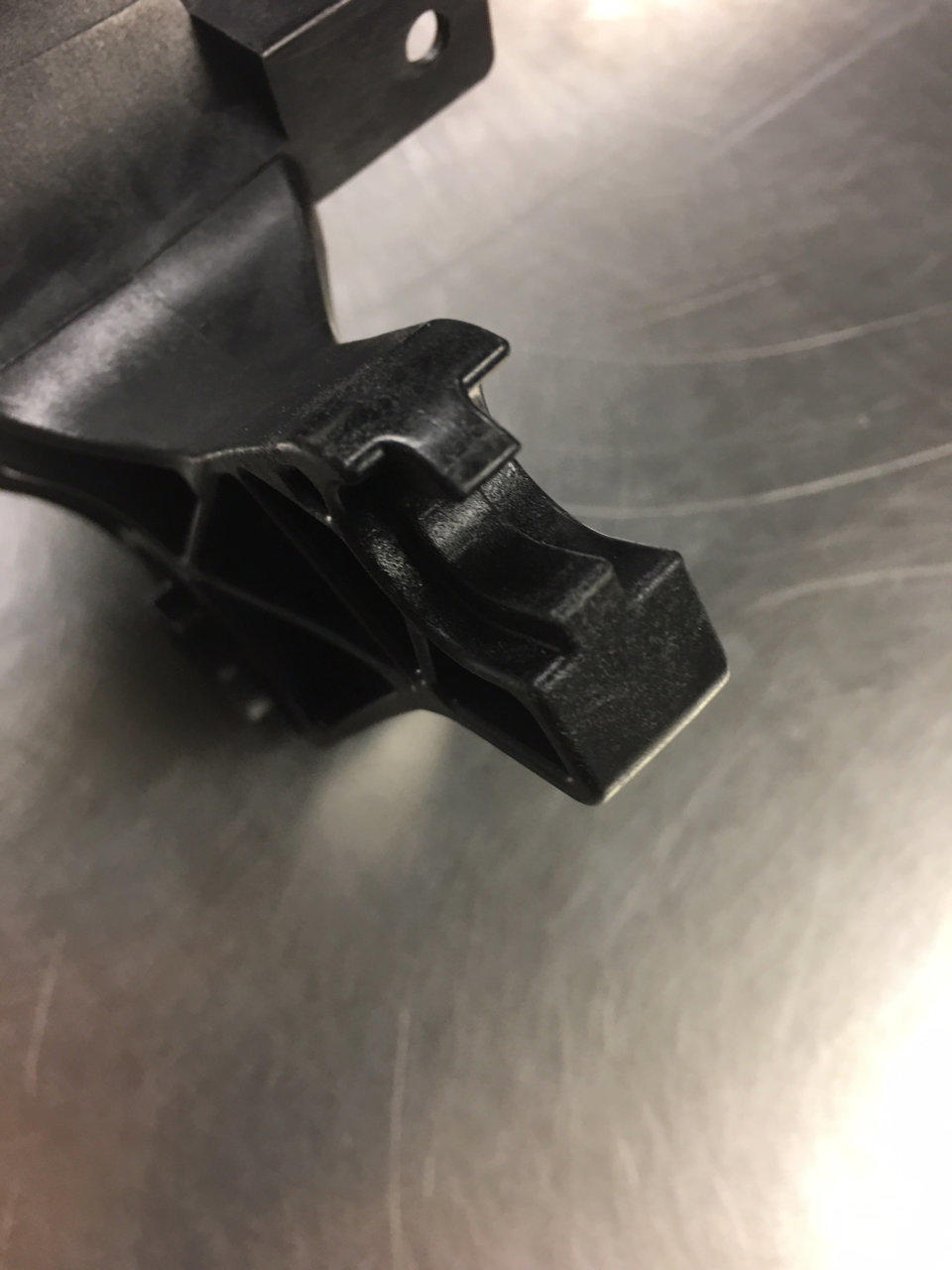

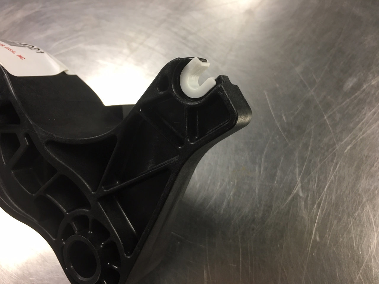

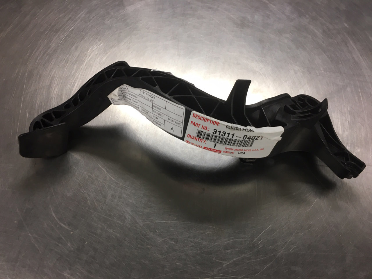

    Here is the updated pedal and bushing. This bushing did not exist on any of the previous pedals up to 31311-04021, but it is commonly used on metal pedals where the return spring makes contact with the pedal. Also worth noting is that the TSB provides better information regarding the type of grease to be used compared to previous revisions.

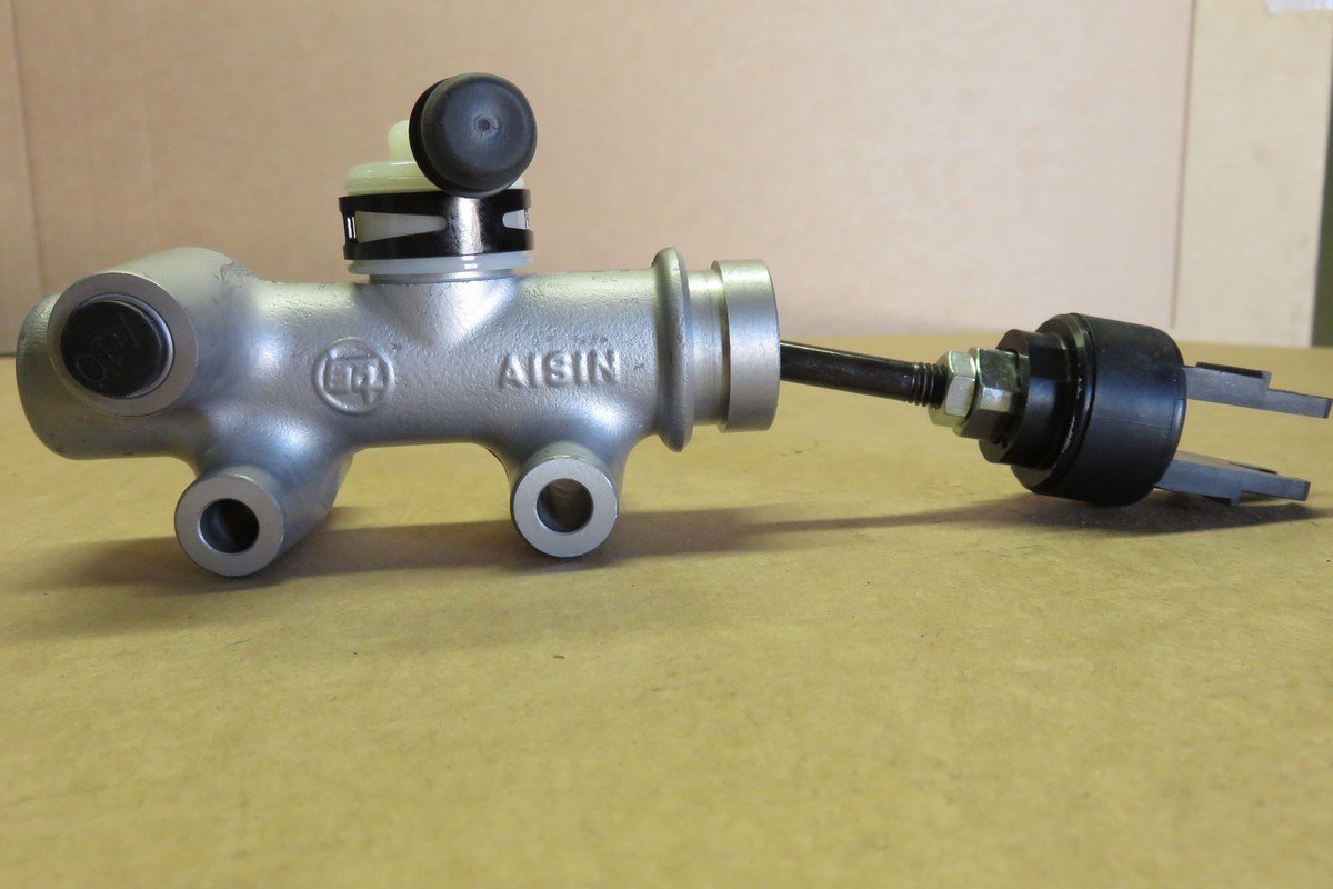

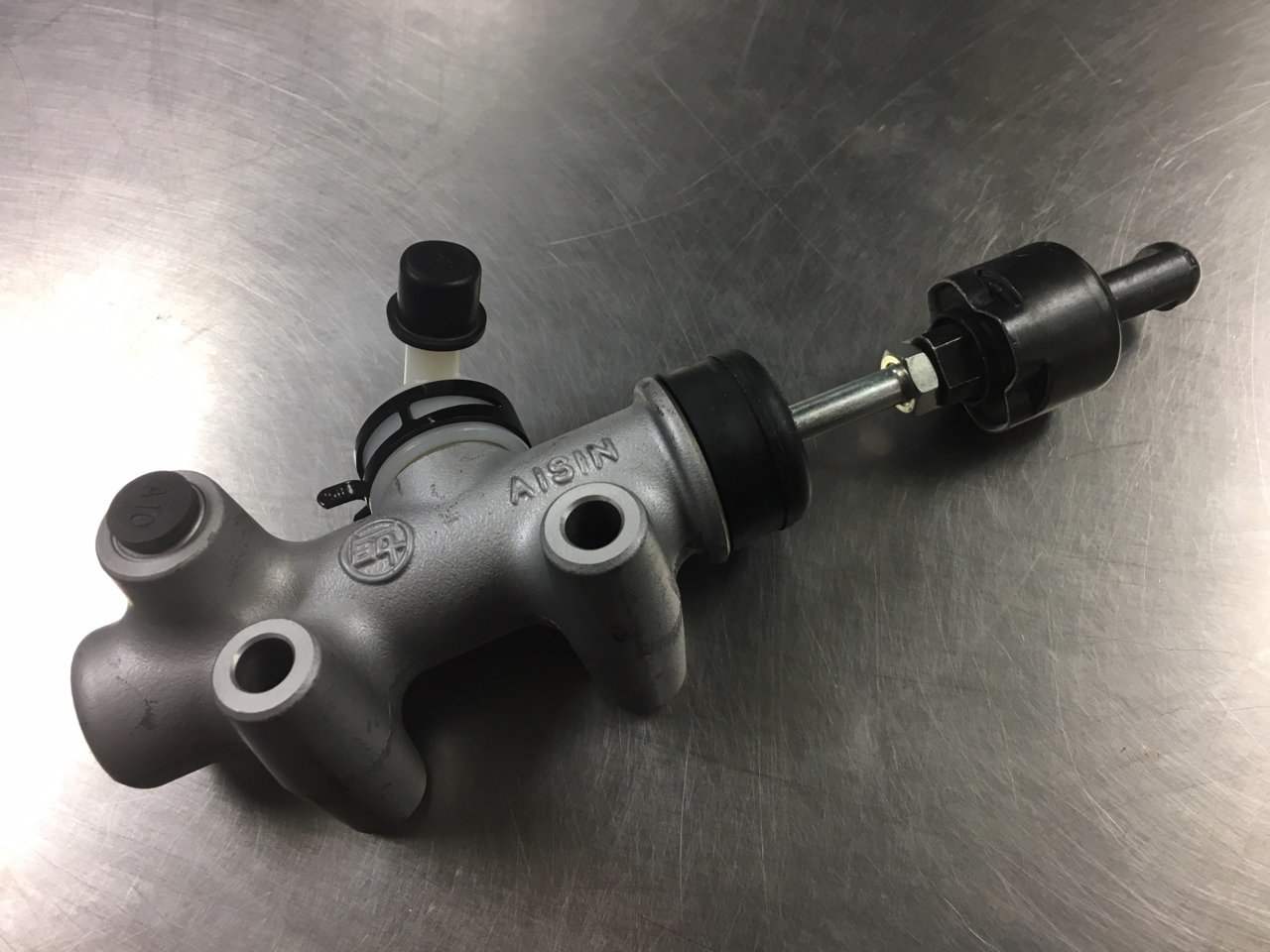

    And the updated master cylinder. While the TSB states that all parts must be changed together, that is only partially true, as it depends on what the truck had previously. The master cylinder clevis must match the pedal. The current master cylinder matches 31311-04020 and 31311-04021 pedals. (31420-60031 and 31420-60032 can be identified by the colour of the clevis being either zinc-coloured for the 60031 or black coloured for the 60032).
    So that's what the latest TSB for the Tacoma uses, and as I was looking at the master cylinder (for which Toyota sells no components) and noticed that the pushrod boot has a part number on it that actually matches a mid-80's Land Cruiser. That got me thinking about whether other vehicles used a similar pedal setup, since Toyota decided to swap the Tacoma master cylinder out for the Land Cruiser Prado 120 design, maybe there was a pedal in another vehicle that would work in the 2005+ Tacoma.
    My first guess was the Hilux, but it looks like they use a more conventional setup through the firewall, but they did list the clevis separately, so I decided to take a look at vehicles that used that clevis and lo and behold I came across the FJ Cruiser, which uses a very similar setup to the Tacoma with one big exception: it uses a metal pedal instead of plastic.
    Not only does the FJ Cruiser use a metal clutch pedal, but Toyota actually sells components for the master cylinder (overhaul kit, clevis), which for longevity and serviceability I consider to be a plus.
    Here is the 31420-35070 master cylinder:
    Worth noting is the fact that while most of the cylinder is metal, the clevis is plastic. (If you were really set on having a full metal setup, the 31420-60060 master cylinder from the 2008-2018 Land Cruiser 200 can be used, though it is not available from North American dealers -- you can "build your own" using the 31420-35070 master cylinder and replacing the clevis with part number 31404-35013).

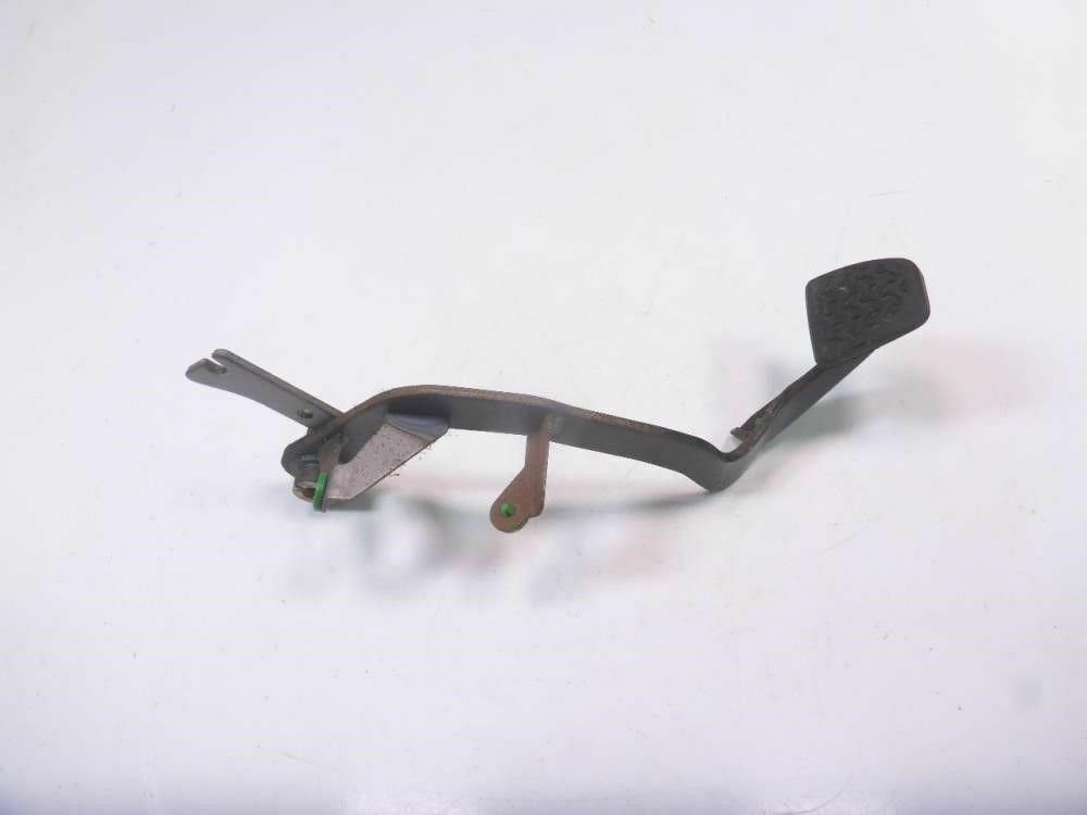

    Here's the FJ Cruiser clutch pedal:
    Compared to the Tacoma clutch pedal:
    If I owned a Tacoma, I would be swapping things out for an all-metal solution that is tried and true.

    One last post on the topic here, since the TSB is not very specific about what is or isn't needed for each truck, they just say do all the pieces for all trucks, here's a breakdown for what is needed to update to the latest Tacoma design:
    2005-2014 Tacoma without T-SB-0186-12:
    31420-60032 - Master Cylinder
    31434-60010 - Hose
    31311-04021 - Pedal
    90389-06055 - Bushing
    2005-2014 Tacoma with up to T-SB-0186-12 (no revision),
    2015-2017 Tacoma (up to January 2017 production) without T-SB-0186-12 Rev. 1:
    31311-04021 - Pedal
    2005-2017 Tacoma with T-SB-0186-12 Rev. 1,
    2017-2019 Tacoma (up to May 2019 production):
    31311-04021 - Pedal
    Jeff
