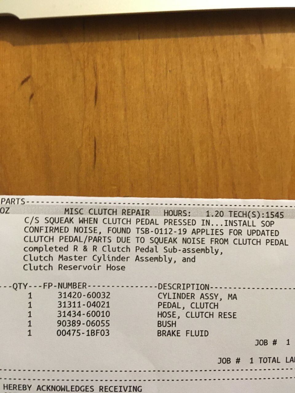

  17. Nov 1, 2019 at 3:32 PM
    #117
    SilverBulletII
    SilverBulletII Well-Known Member
    Jul 5, 2018
    #258446
    1,659
    New England
    2017 Silver Tacoma SR, MT, 4 cylinders, 4X4
    Mine only creaks after the heater has been on.
  18. Nov 1, 2019 at 3:34 PM
    #118
    SilverBulletII
    Jul 5, 2018
    #258446
    1,659
    New England
    Had TSB-0112-19 performed today. Under warranty. No charge.
    davesaddiction likes this.
  19. Nov 1, 2019 at 4:16 PM
    #119
    su.b.rat
    su.b.rat broken truck
    Jul 30, 2016
    #193316
    9,869
    were you in or out of warranty?
  20. Nov 1, 2019 at 4:18 PM
    #120
    SilverBulletII
    Jul 5, 2018
    #258446
    1,659
    New England
    In warranty. 34,000 miles.
