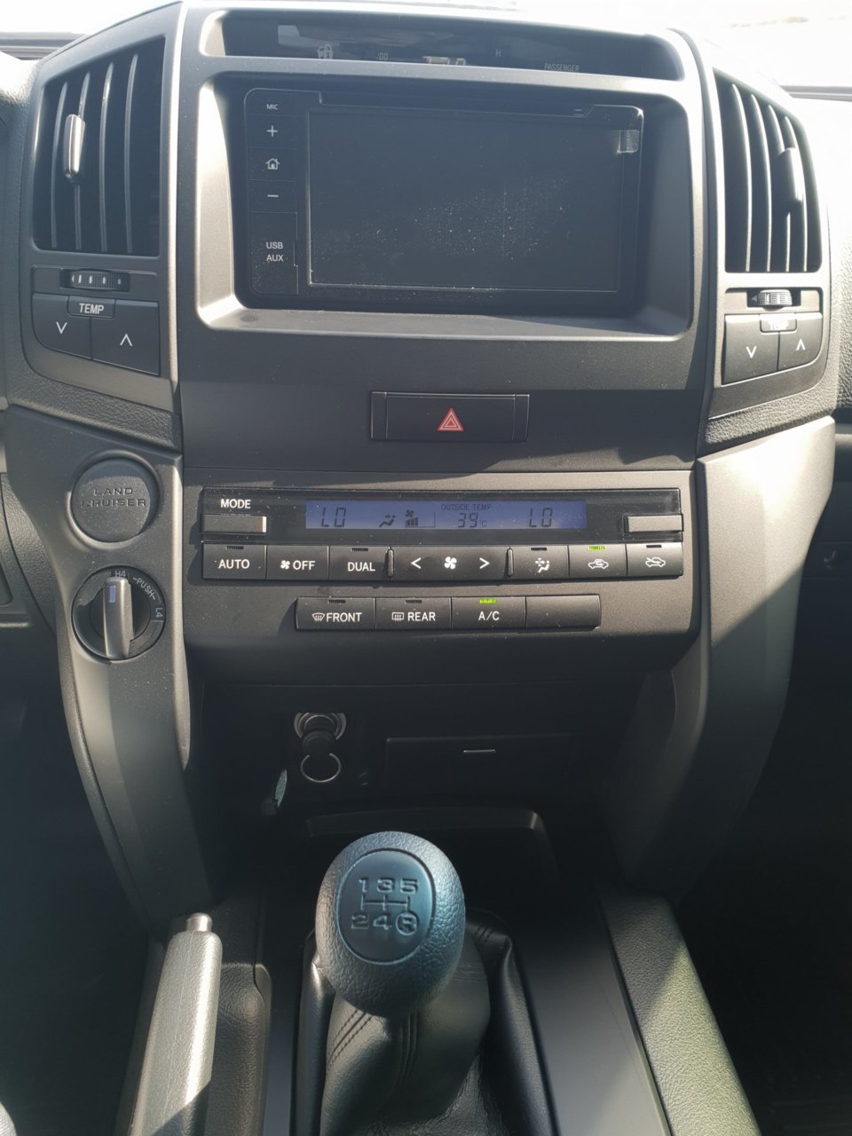

    This must mean they offer manual LC200s overseas? Wish they offered that here in the states...
    ericvega likes this.

    They do indeed.
    Jeff

    I've only seen it on the lower trims, but still sweet never the less...
