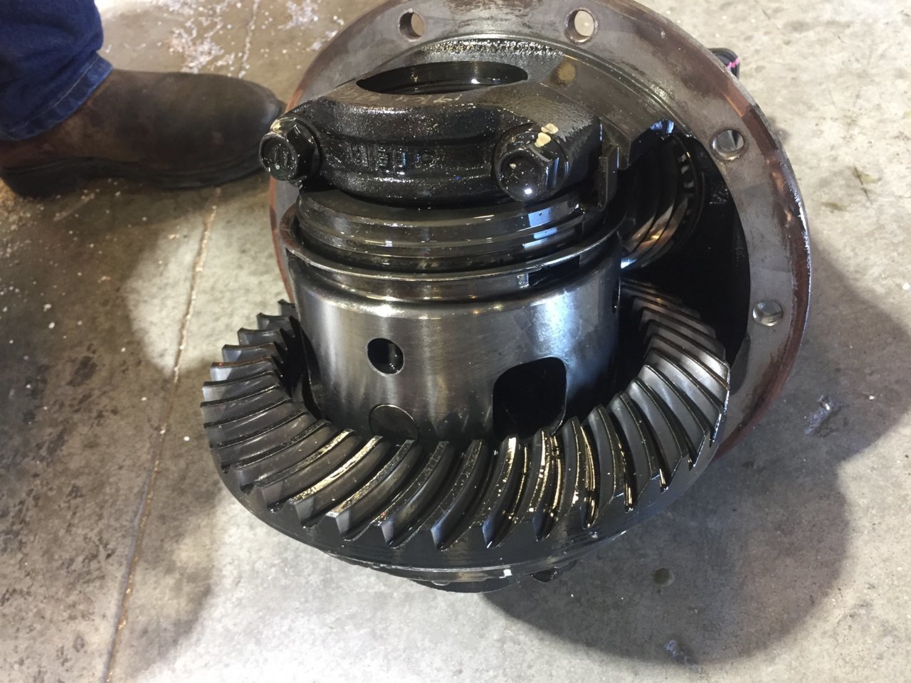

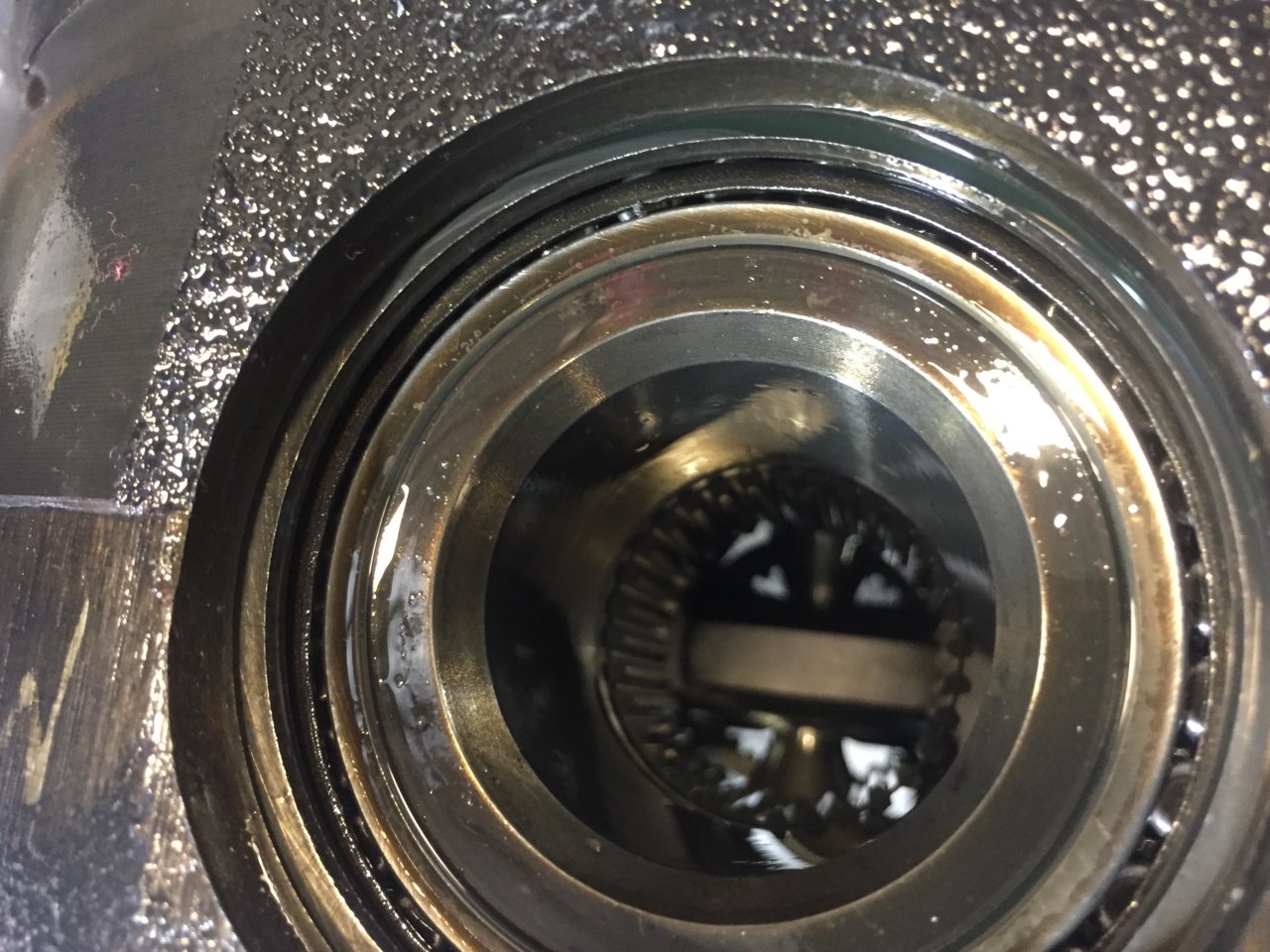

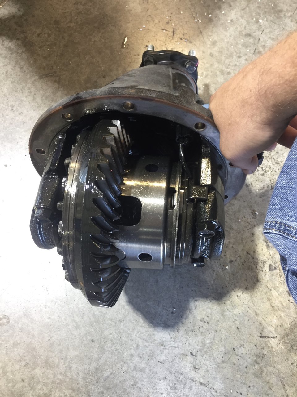

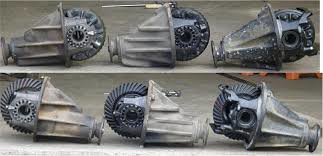

    Actual photos of the 8.75” e-locker third out of my truck. I had the third replace under warranty for the howling issue. Do not believe that 2nd gen axle shafts would swap in but you can count splines for yourselves. I count 32 splines and I noticed that the axle diameter is also larger. The axle is substantially larger than an 8inch or the “8.4inch” which is still an 8” that has a brace on the bearing caps. Is it a Dana 60 no but is is it stronger than a 2nd gen axle yes.
    Confirmed by this.
    https://www.randysworldwide.com/differential-identification/toyota-8-75-rear/
    1735C21F-32F4-4B7A-B449-68A9CD4D79BA.jpgDB7E18B3-1D9E-49FA-AB78-16783E56F758.jpg051CC469-902B-4B65-AB24-435227F6112D.jpg
    Left to right Toyota 4cyl 8.0 inch, Toyota v6/turbo(now current in 3rd gen automatics), 8.4 inch 1st gen Tundra, 1st & 2nd gen tacoma.

    Thank you. That's exactly what I was hoping to hear and see. That's the extra beef I was looking for without going overboard. I'm pretty sure ECGS can find a cut to length 32 spline shaft to fit that even if one isn't available off the shelf.

    So then wheel bearings etc. are also larger to let the bigger shafts through??
    When I compar d prtnumbers a while back they were the same but maybe that was just bad info :notsure:

    All the important things are upgraded on the 8.75" rear. Ring gear is larger and has 12 bolts instead of 10. The pinion gear is a 34 spline 1.77" diameter. The 32 spline axles are 1.37" in diameter. The housing tube diameter is also increased.
