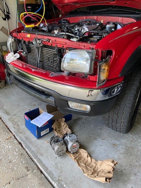

  15. Apr 26, 2022 at 10:33 AM
    bodhi armor
    bodhi armor [OP] 02’ Dbl Cab- "The Luck Dragon"
    Apr 21, 2015
    #153669
    525
    Joshua
    East TX
    2002 4x4 Dbl Cab Jade Green
  16. Apr 26, 2022 at 10:46 AM
    #16
    bodhi armor
    Apr 21, 2015
    #153669
    525
    Joshua
    East TX
    This was the original compressor with 300k on it. It was recommended that I replace the whole compressor.
    Nevin likes this.
