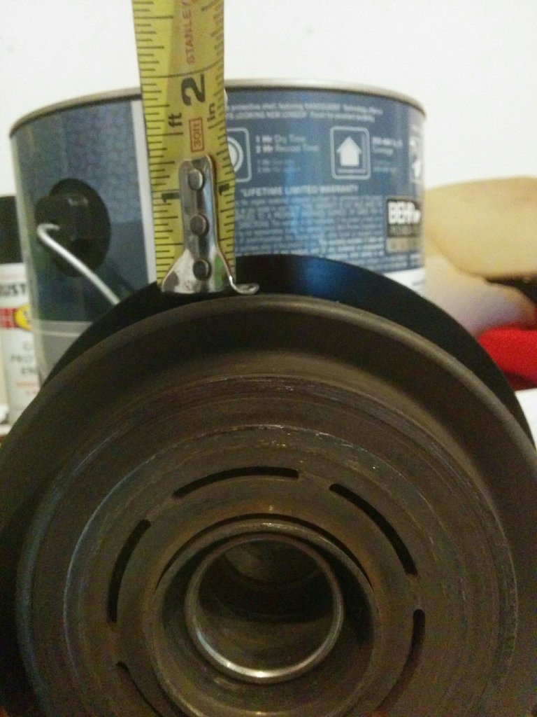

    Well, the fargin iceholes at Rock Auto sent me the wrong part. The pulley in the kit they sent is larger than the one I took off the truck. Makes it impossible to get the AC belt back on. Witness:

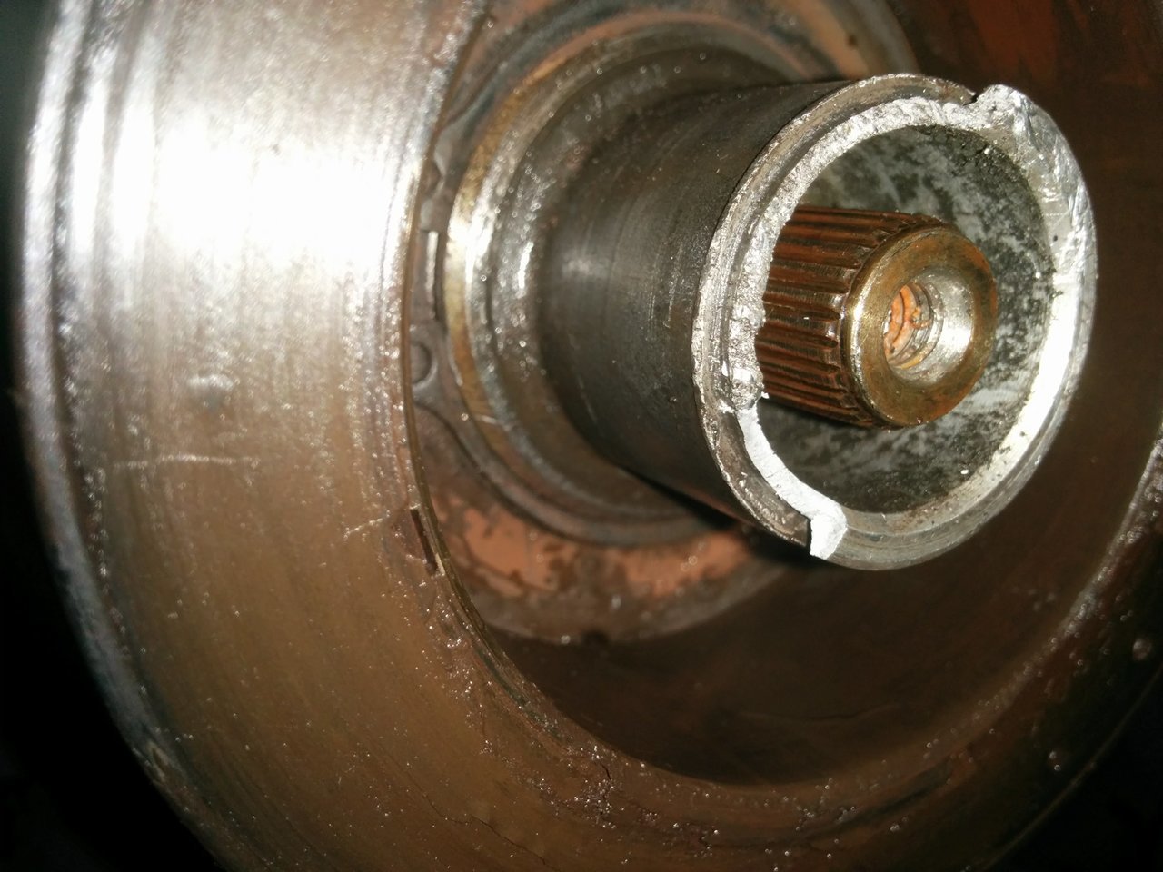

    However, I think I need a new compressor anyway. The lip that forms the retaining wall for the snap ring that holds the pulley on there appears to halfway self-destructed. What say you? Is this a new compressor in my future?

    Just buy a new compressor, OEM if you can swing it.

    You can buy complete o-ring kits for the AC system for pretty cheap if you do have a leak. You have a bad bearing on your compressor, it doesn't sound like you have locked the thing up... If you have, then you will have to purge the system with either denatured alcohol or acetone to clean up the expansion valve.
    This job really isn't terrible. You will probably have to remove your power steering pump and skin your knuckles as you remove the compressor, but it's not too difficult. I would STRONGLY suggest that you replace your AC drier canister when you do this job ($20), then take it to a shop to have the system purged and refilled...This may cost up to $150, unless you have gauges and an air compressor.
