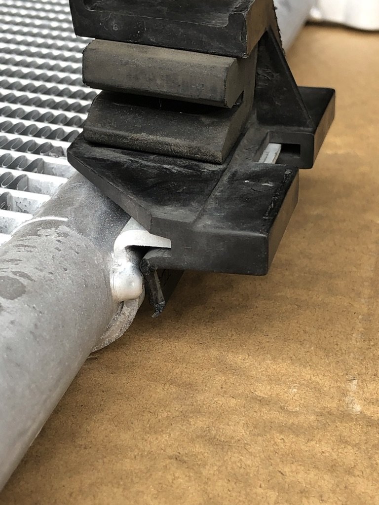

    Just a heads up to anyone ordering a Spectra condenser from Autozone. You'll need to buy new brackets from Toyota (unless you find aftermarket versions) because Toyota decided to change condenser design (I'm not sure when).
    Spectra followed suit and updated the design of the condenser. So, your original condenser brackets won't work.
    I found out the hard way. I initially thought Spectra quality shit the bed and I wrote them an email to complain. Spectra responded back to me the next day explaining what I mentioned above and sorry for the inconvenience.
    Here are the part numbers for the brackets you'll need if you order them from Toyota: 88688-04260, 88688-04270, 88688-04280, 88688-04290.
    Before finding out that I had to buy new brackets, I went to AutoZone and told them that original brackets wouldn't fit. No one behind the counter had any clue why. So, I just returned the Spectra condenser and drove over to O'Reilly.
    I bought Murray condenser, which was a bit cheaper, from O'Reilly but the condenser came with brackets! If I only went to O'Reilly the first time, I would've saved myself a whole day.
    Also, my tacoma's condenser had seal washers (not o-rings) on both low and high pressure lines. The condenser washer kit (usually special order) from Autozone and O'Reilly is a little more than $30 and it comes with an assortment of o-rings and washers, but you only need two seal washers. I was lucky that one of the guys at O'Reilly knew a mechanic nearby who would sell me the two seal washers that I needed.

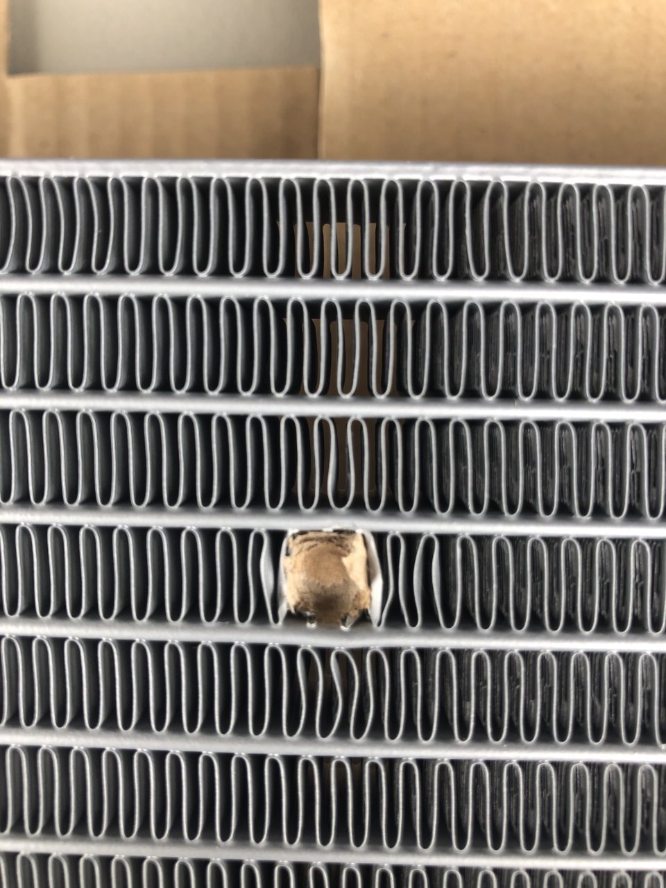

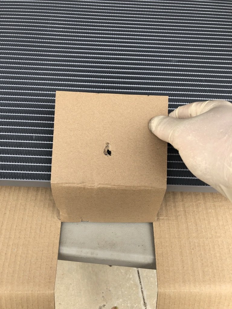

    Side note: Check the condition of your newly purchased condenser before you leave the auto parts store. The condenser that I bought from O'Reilly was punctured. I didn't realize that until I got home. Fortunately, I was able to return the punctured condenser and got a new one within a few hours.

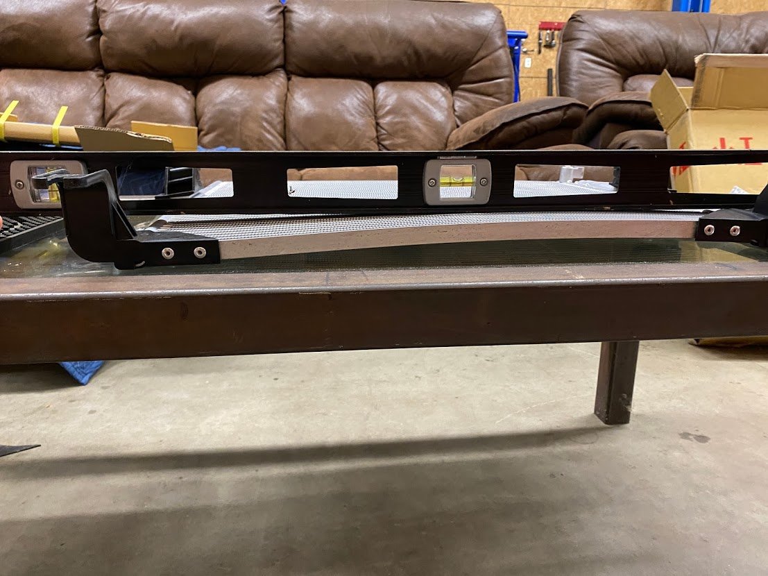

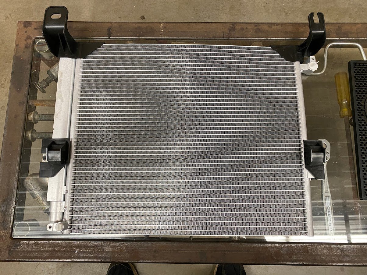

    Ok this thread is awesome thanks for all the info posted. I diagnosed my leak in the condenser so I ordered a new Denso unit
    The new unit came in today. I unboxed it, and while non of the fins look damaged (and neither was the box), the whole thing looks tweaked a bit. Is this normal? I haven't torn my old one out to see what shape it is but I would think it would be straight. If it's not normal, do you think it's worth trying to mount in and straighten it or return it?
  17. Jun 10, 2021 at 6:51 PM
    #57
    FastEddy59
    FastEddy59 TTC #0061
    Jan 20, 2017
    #208155
    27,141
    Eddie
    '13 Barc. Red Tacoma SR5 4X4
    Bent. Can’t see ‘em makin’ it like that.
  18. Jun 10, 2021 at 7:02 PM
    #58
    6 gearT444E
    6 gearT444E Certified Electron Pusher
    Feb 3, 2018
    #243372
    7,798
    Deep South
    Herculiner Hootus
    Thanks, that's what I was thinking as well. Damn, guess I'll have to order another one and hope it comes undamaged. Good thing is Amazon return policy is easy.
  19. Jun 10, 2021 at 7:23 PM
    #59
    FastEddy59
    Jan 20, 2017
    #208155
    27,141
    Eddie
    Cores are likely made in one plant & ends in another. Who knows were it’s put together. That looks bent. It’s not offset or whatever to fit the application. It’s a fair jag of work gettin’ that in. Be a shame if the part is defective. I’d err on the safe side. Bet the new one’s not like that.
    6 gearT444E[QUOTED] likes this.
