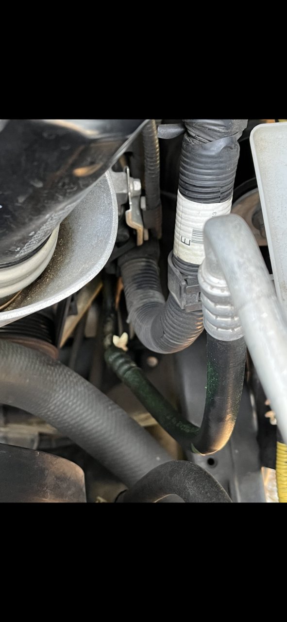

    I know, this is old. I need to replace the ac line from condenser to firewall. should I replace ac condenser also since the drier is built in?

    I need to replace this one on mine. Haven’t got around to it yet
