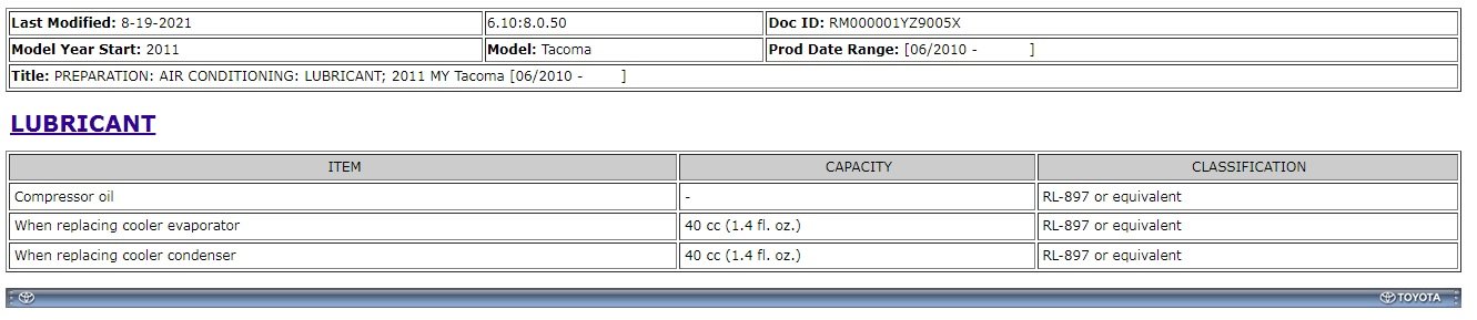

    I don’t have an fsm. Do you have the toyota list with oil replacement quantity to be added for each component replaced? Most mfgs have this, but don’t know where to get it for the tacos

    Looks like 1.4 oz for the condenser.

    Ok got parts today. My buddy has a high end leak detector. We confirmed a VVERY small leak at the the condensor, but sadly also found a significant leak at the compressor main seal or case seal.
    looking for opinions on four seasons brand new compressor. Denso no longer offers one, but it was just a re badged delphi. A new delphi is $400 and a new four seasons is $200. There is a uac and a gpd brand at similar prices if any one has experience with these. There was a nissens option at 350, but would just go delphi at that price point. Hoping folks out there have some experience with four seasons.
    also hoping you can post the total oil capacity and/or the recommended approach for oil with compressor replacement. Condensor is getting swapped but the evap is staying.

    The cheaper aftermarket compressors don't seem to last more than a few years where I'm at but our climate is hell on A/C systems. Also keep the Lock sensor from your old compressor, the aftermarket ones (even Delphi) don't always work properly.
    This is all Toyota gives for compressor oil, essentially you drain and measure the oil in the old compressor and make sure the new compressor has that amount in it (note aftermarket compressors may or may not come with oil and amounts can vary, most will have a tag stating the amount of oil they contain but some do not). Since your doing the condenser as well you can add that amount to it.
    Be sure to rotate the compressor a few revolutions after it is installed and the lines are connected to clear any oil out of the pumping elements.
    1. ADJUST COMPRESSOR OIL
    (a) When replacing the compressor and magnetic clutch with new ones, after gradually discharging the refrigerant gas from the service valve, drain the following volume of oil from new compressor and magnetic clutch before installation.
    Standard:
    (Oil capacity inside a new compressor and magnetic clutch: 150 + 15 cc (5.1 + 0.51 fl.oz.)) - (Remaining oil amount in the removed compressor and magnetic clutch) = (Oil amount to be removed when replacing the compressor)
    NOTICE:
    • When checking the compressor oil level, observe the precautions on the cooler removal/installation.
    • If a new compressor and magnetic clutch are installed without removing some oil remaining in the pipes of the vehicle, the oil amount becomes too large. This prevents heat exchange in the refrigerant cycle and causes refrigerant failure.
    • If the volume of oil remaining in the removed compressor and magnetic clutch is too small, check for oil leakage.
    • Be sure to use RL-897 for compressor oil.

    Yea there's no exact science to refrigerant oil balancing that I have found, unless you are replacing every component the best you can do is "close enough".
    The way I would do it is subtract the amount of the evaporator (1.4oz) from the total of 5.6 and put that amount in the new compressor.
    As long as you aren't way over the amount (cooling will be inefficient) or under the amount (higher risk of compressor failure) it will be fine.

    Makes sense. FYI, I think that quote from the manual is a typo. Far more likely that it is 5.1 oz +or- .51 oz. It is too coincidental that it is .51 oz and that is exactly 10%

    Mitchell also shows 5.6oz total system oil capacity but they typically get their info from the FSM so...

    got the compressor condenser txv and an o-ring set installed over the weekend. Works well now. The compressor cycles a lot less now. I think the TXV was shot and was causing the oscillations in temperature. Seems to work well, but am new to Tacoma AC (bought it last fall and didn't use the AC much). At idle it runs relatively cold and going down the road seems acceptably cold, but not ice cold. Wondering if that is to be expected from this truck. Not complaining, just setting expectation. Got spoiled by my BMW. It also was not ice cold, but it had an elec condenser fan that would go on below 30 MPH, so got quite cold air sitting at a light.
    Very little oil came out of the compressor, so ended up putting a bit less than 4 oz in the new compressor. Surprising that with the limited oil, there was zero signs of wear or distress. oil had NO grey or black tinting and filter looked almost new.

    Mine (and many others it seems) is opposite, it's adequate at idle and gets alot better driving. Granted these trucks will never blow ice cubes on a hot day like some vehicles will but you should get 40-50 degree vent temps driving down the road.
    I bet most of the oil was stuck in the evaporator because the refrigerant carries oil with it and when the charge is low the oil gets stuck in the evaporator because there's not enough liquid refrigerant to carry the oil back to the compressor.
    You may have too much oil in it and that may be hurting cooling performance a bit.
