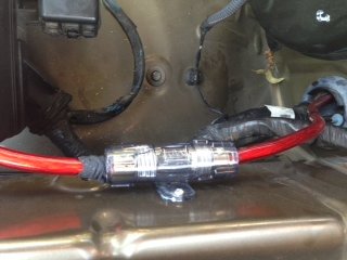

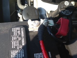

    I have run the power cable but am not getting any power to the amp. Here are a couple of pics on things that I have checked. The power cable is securely attached to the positive terminal on the battery and the fuse in the power cable still looks good. Any suggestions?

    Is the amp not turning on? Did you hook up the remote turn on wire? Are you using a Line Output Converter if not how is it tied to your stock system? Normally power, ground, remote wire and RCA is all you need. But if you run a stock deck you will need a LOC, amp with speaker level input or sound processor.

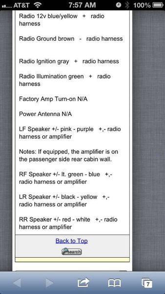

    I am not getting any indicator lights coming on. Here are some pics from behind the stereo. It seems like everyone is saying there should be a gray wire that is the 12V Ignition. I am not seeing that. Do you know which one it is?

    Get you an add a fuse and tap into the ignition switch fuse.. problem solved.. at least for the remote wire part..
