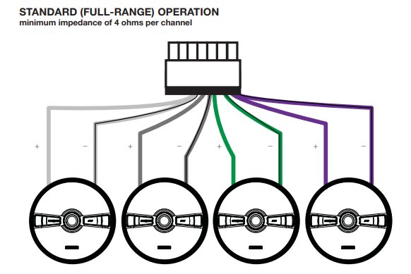

    Once you created the harness, at that point it was plug n play? You didnt have to cut into any OEM wires?

    Yup. No cutting of the factory harness. Plugs right inline between stereo and speakers.

    It uses the power to the radio for power. No separate power needs. You in essence stop using the radios amp and this one instead so you don't overload the stock wiring.
    I followed this one. Has everything in it.
    https://www.tacomaworld.com/threads/kickercs-upgrade-with-kicker-key-amp-install-assistance.568985/

    You've got it backwards, the kicker key is the amp and the hideaway is the sub

    still trying to understand it all... but it looks like replaces the power source for the door speakers.
    what is powering the sub? the head unit still?

    you connect it to the battery

    Do you know with the Metra harnesses, you dont have to run a power wire from the battery?

    Look for an amp that has Speaker Line Inputs. Then - you will need to source a Plug-N-Play harness.

    I assume you're asking about the amp? If so yeah you wire it in between the stereo and speakers. And it's powered by the stereo power. Couple metra plugs and no cutting of factory wires.

    Hey Op, I recently installed the Kicker Key Amp 180 and it is fantastic! There's a great writeup on it as well on this forum asking for wiring help. As long as you get the metra harnesses, you won't have to splice any factory wires at all. The other great thing is the amp can sit behind the headunit.

    For the key amp you need battery power
