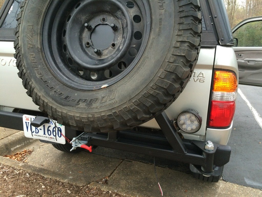

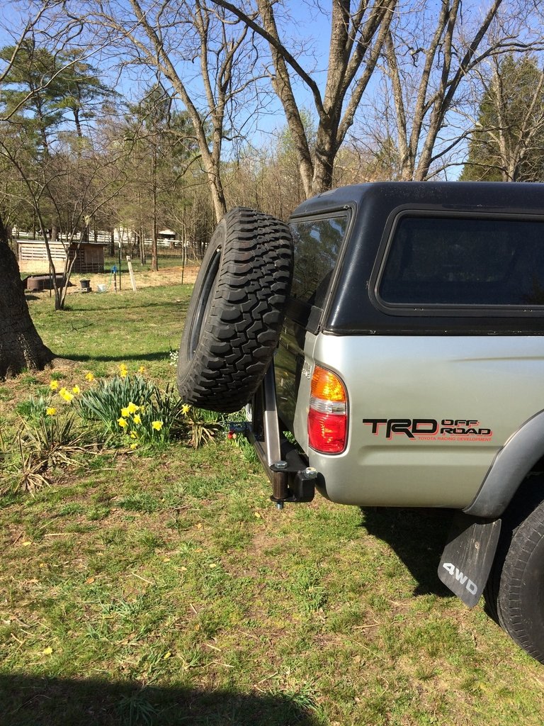

    Getting some more time in the garage equals getting some stuff done. Tire carrier about 95% finished. Just need to permanently attach the delrin pads and weld on a reverse light bracket and paint this sucker.
    Not really in love with how the latch worked out, may have to move that later on, I can definitely see that catching a rock sometime. But for now it cures the problem of have the tire in the bed and no more noise from the factory tire carrier. It was creaky with the oversize tire under there.
    May add another swing arm to the other side down the road to house a ammo can for recovery gear (another nod to BoxRocket). That will get that kind of stuff out of the inside of the truck permanently. Rattley shit drives me crazy. Getting ready to sell my Civic now that the baby is getting big, that will fund some new tires and credit card payoff. Woot!

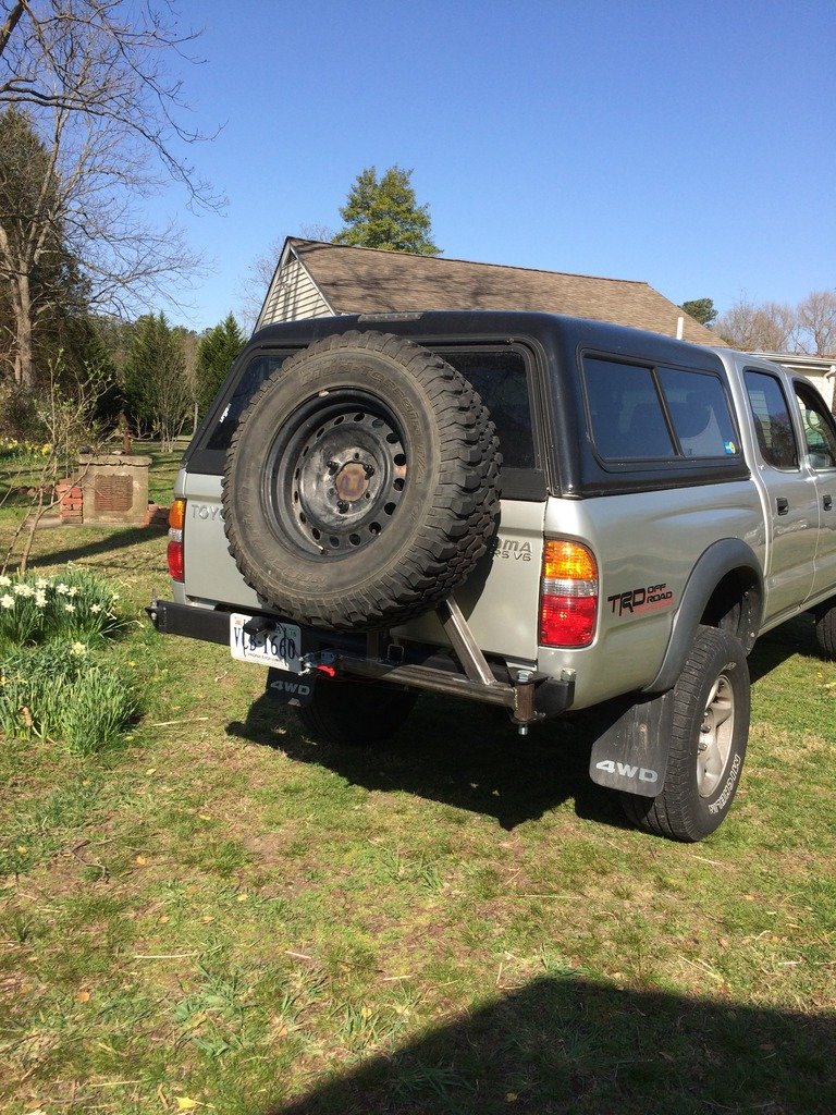

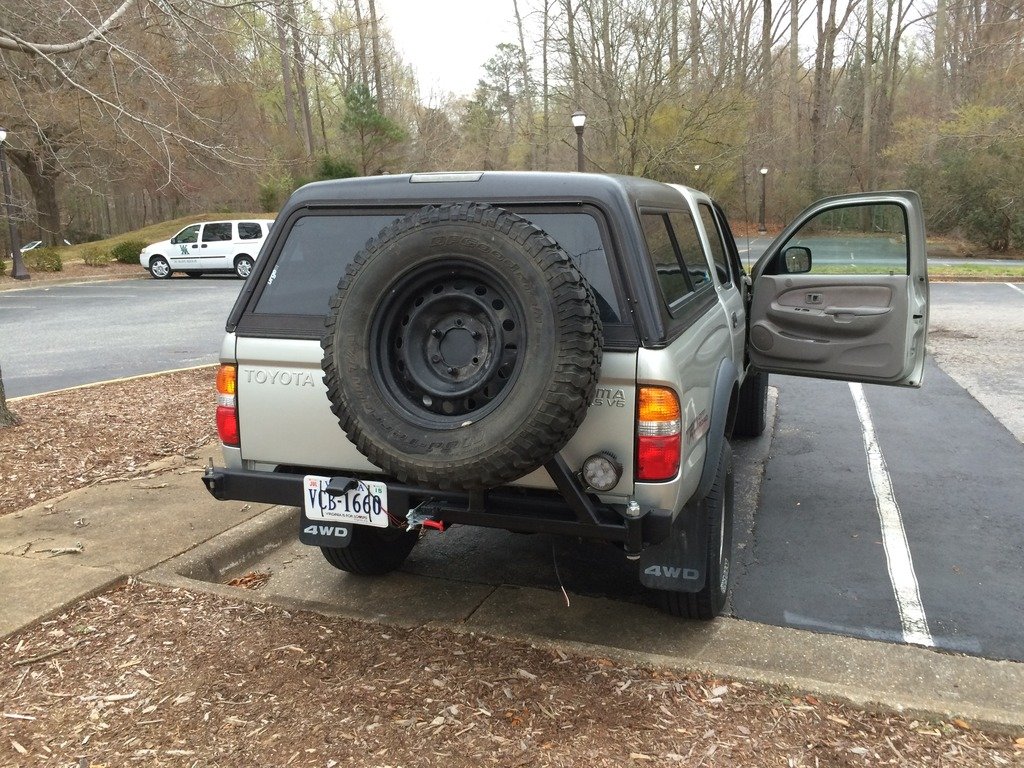

    But I have gotten the swingout painted and reinstalled along with adding the final pieces of welding and whatever. Here it is...
    Excuse the messy wiring, the light needs to be wired to a switch and the license plate will be moved up to the inside of the spare.

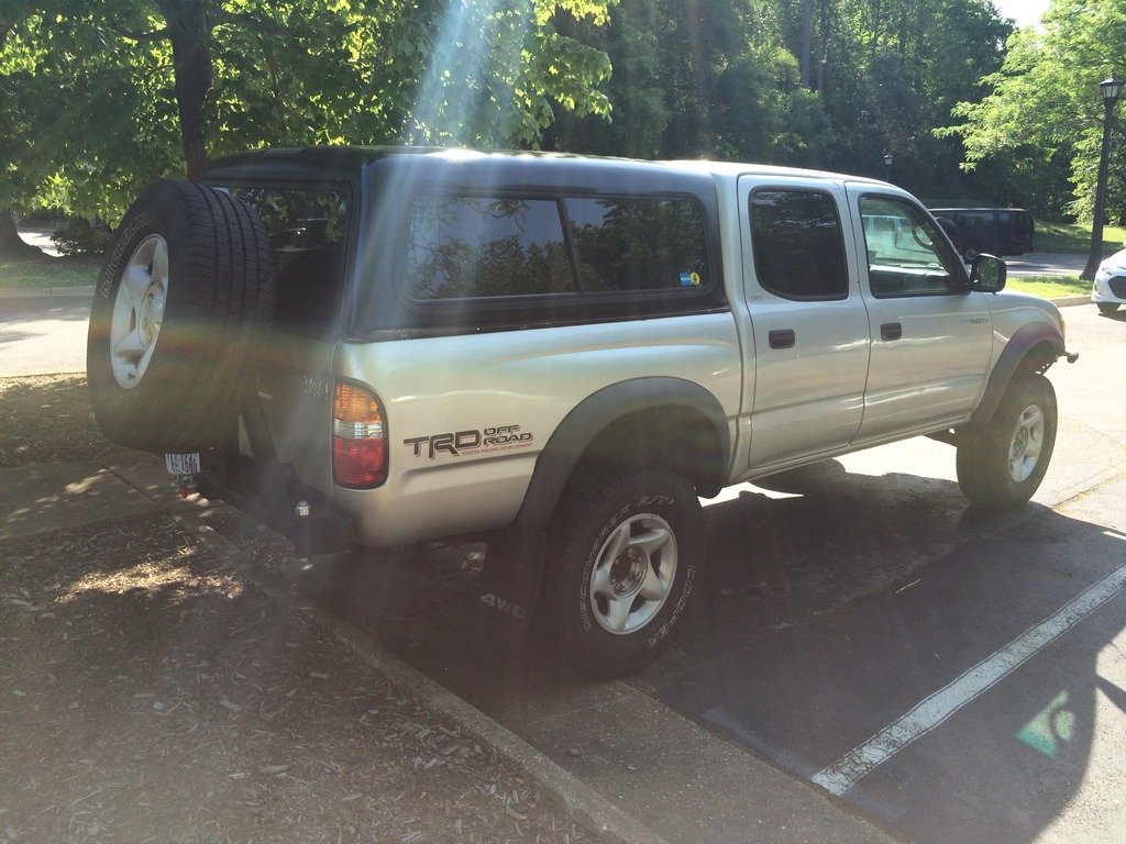

    Ordered up a set of Cooper AT3's for the truck in Load C and the LT265/75-16. I spend more time on the road than off anymore, but wanted a more stable tire than the flimsy feeling P-metric, stock sized Michelins.
    Review and pics to come one installed.

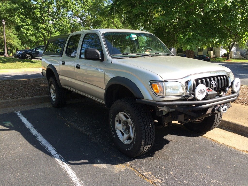

    New shoes...
    Very smooth on road, and I will be able to get them dirty Memorial Day weekend, with the wife and another couple for a relaxing night in the old mountains of the east.

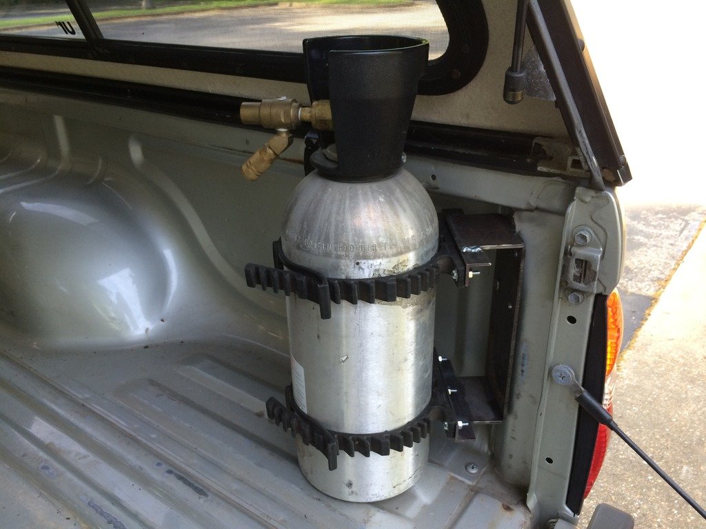

    Made a little bracket finally for my 10 lb. tank, 3/16" mild steel and a couple of Quick Fist Super Fist's or Clamps or whatever they are called.
    Never liked ratchet strapping this to the tie down point, so it is now bolted in. I made it to be ambidextrous so that is making adding a gusset to brace it off a little difficult, so I am going to let the tank be a stressed member (since it's there anyway) and see how that goes for the first couple of trips. If it seems to fatigue, then I will make version 2.0 with a gusset of some sort.

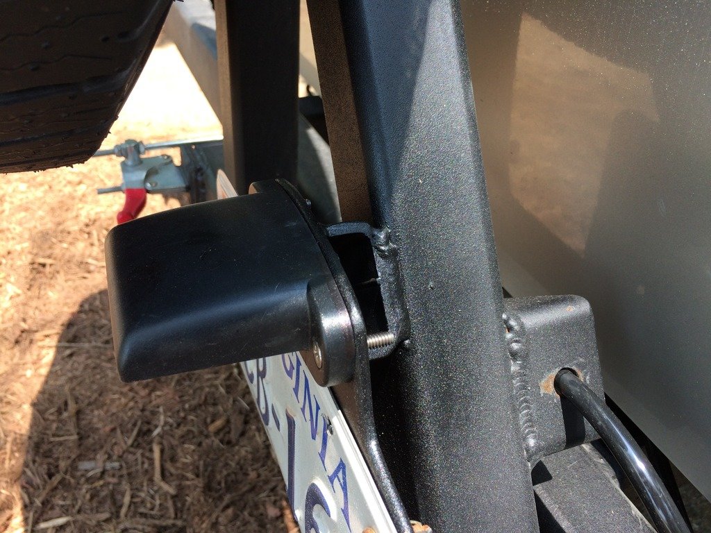

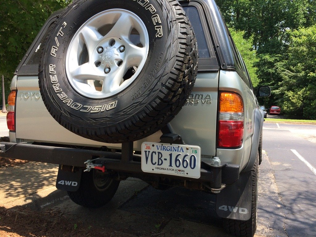

    Finally get the license plate mount finished, the zip ties were killing me.
    AT3s are great so far, very little road noise, I definitely can't hear them over the Dynomax muffler, and that thing is pretty quiet.
