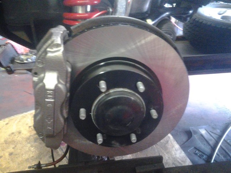

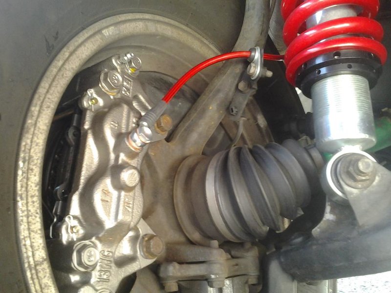

    Brandon after you work the bugs out do yourself a favor and install tundra brakes. I just did this a couple weeks ago on my project taco and a couple years ago on my 4runner. BIG difference! Your oem 16's will clear. I upgraded because i tow a 17ft fiberglass camper. Pic are from the install on my taco. It's funny you mention the scs F-5's that's what i have on my project.

    I upgraded because i use it to tow some of my toys. A pic of my motor installed. I replaced all the belts, including the Tbelt/W. pump kit, tune up items, rad. hoses, oil cooler hoses, Tstat, multiple gaskets and oil pan gasket sealant from toyota. New clutch kit. Air & fuel filters. I plan on keeping this truck forever so i replaced just about all the maintance items while the engine was on the engine stand, a lot easier that way. I replaced every fluid except the hydraulic clutch fluid, plan on flushing that soon. I'm sure your agree these project tacomas are fun and addicting! It's funny how similiar our trucks were when we 1st purchased them, blown 3.4's, trashed interiors and both my front rims were also caked with brake dust. I know you have your hands full but if you get a chance check out my thread, My $500 project 4x4.

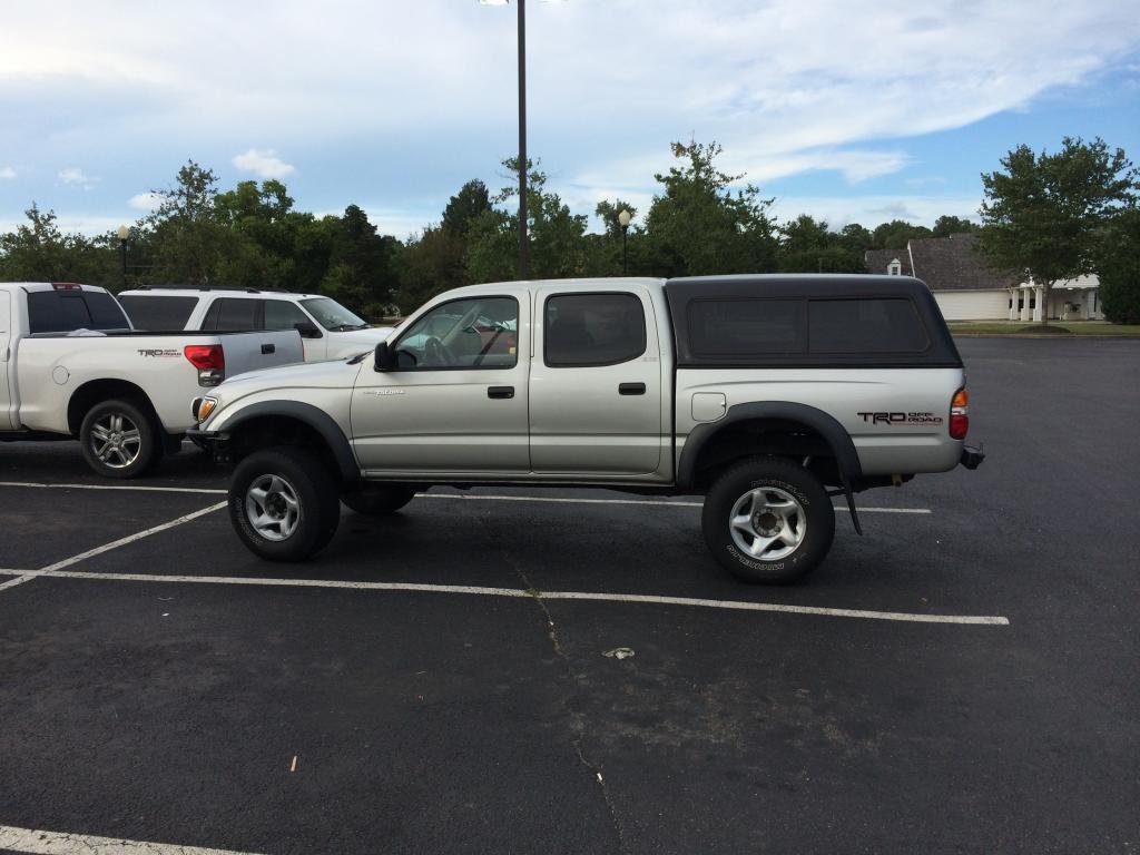

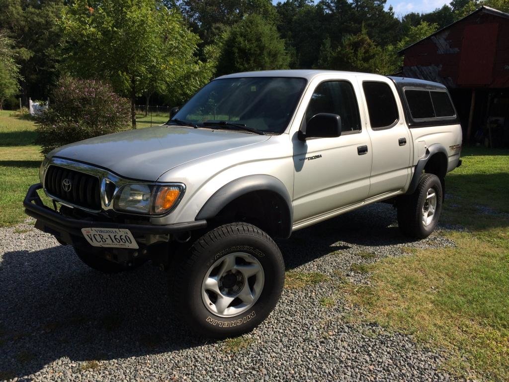

    So I got the suspension done this weekend, it's a bit bigger than I wanted really. I really preferred the height of my last Tacoma, I think it was 2/3, this is like 3/5.
    Approved by Mama and baby though, so that's cool.

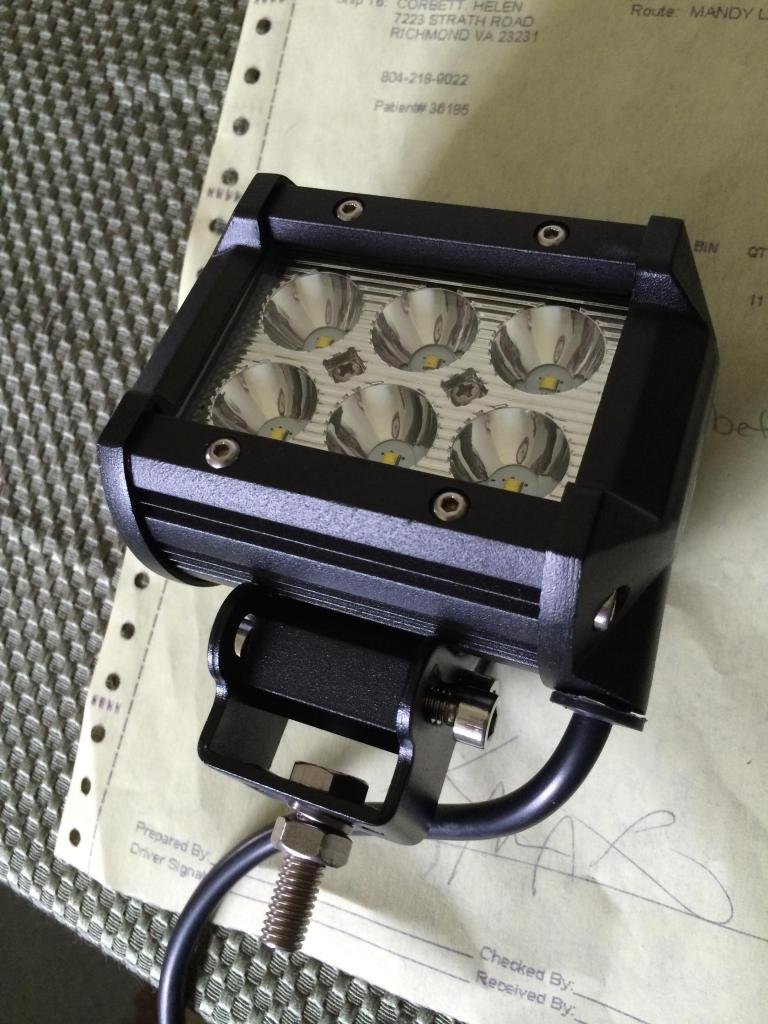

    Also have these little guys that I want to run as ditch lights up by the windshield/side view mirror on a bracket.
    Plenty of driveshaft wobble and I still have the rear pinion/differential noise. So upsetting:(
    I really miss how compliant the OME Dakars were as opposed to the AP Expo leaves that are on this one. I am going to pull another leaf from each pack to get the rear end down some more. If it is level with the cap on, I will be :D

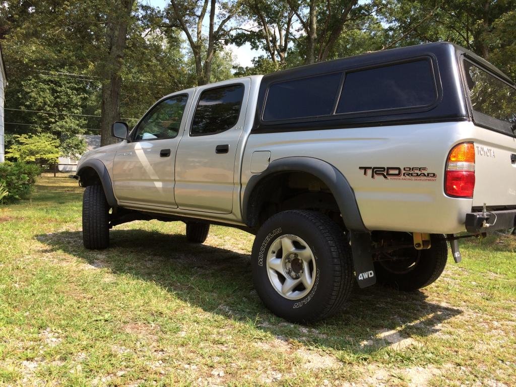

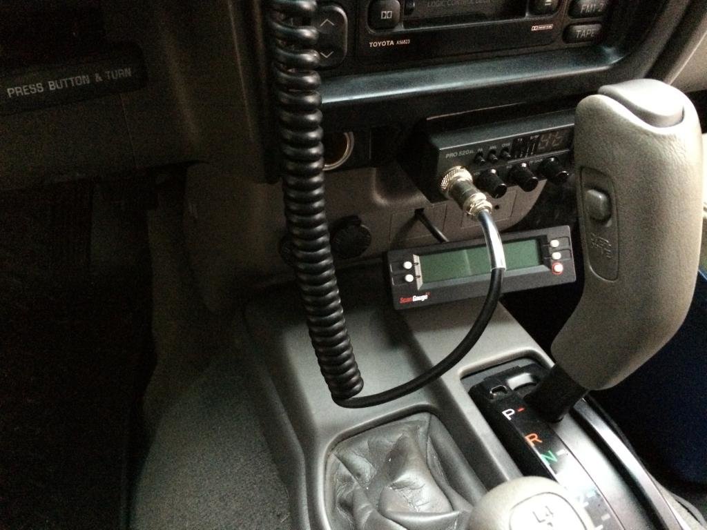

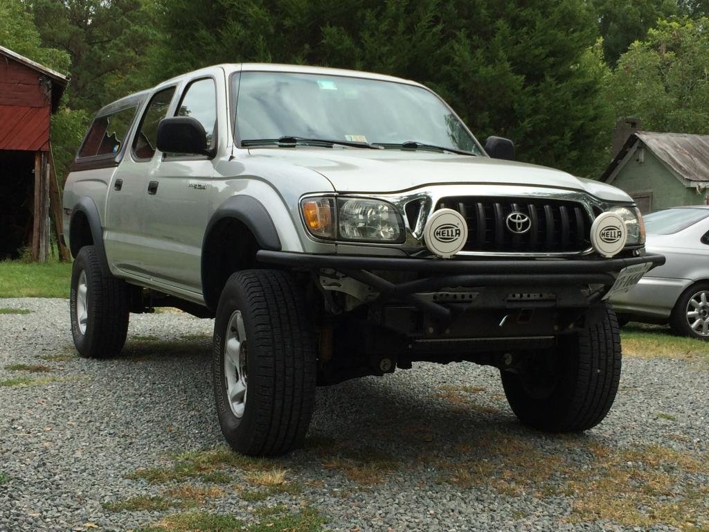

    Decided that 5" was too much in the rear, so I took out the 3rd from the bottom leaf and now I am 3" front and 4" rear with the cap on. Helped the vibration in the rear some, but still have one from 55-65, I think the D-shaft is out of balance, someone decided it was best to add lock washers to the bolt head side of the flange as opposed to the nut side, the way it should be. I have a feeling they didn't put the shaft back together properly.
    Anyone with a 1st gen on here switched to a one-piece d-shaft?
    Anyway, photos...
    one from our camping trip a couple week ago.

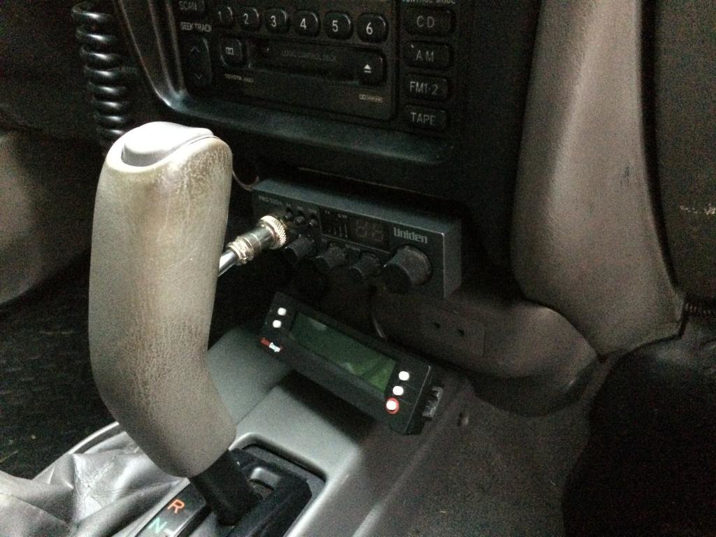

    And also took the time to move the Scangauge to a new, more solid mounting location.

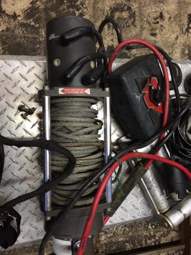

    Just picked up a Warn M8000 for $260. And it works!!
